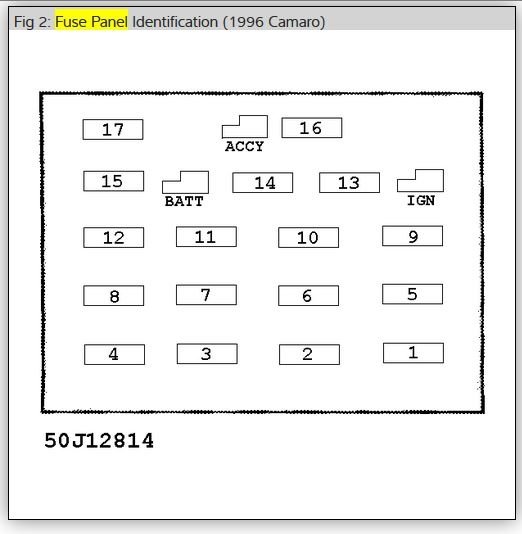

First start of day is hard. Definite miss that goes away by feathering pedal then holding between 2000 to 3000 rpm. Will stall in idle, as well park or drive. But will re-fire immediately if put in neutral or park. The engine will cut out during heavy acceleration in a static manner. Running rich. Cannot get a code read. The reader will not even light up when plugged in.

Let's start with the code reader port issue. The OBD2 port gets its power from the same circuit as the cigarette lighter. It should be fuse number eleven in the image below. Check it to see if it's blown, which it probably is. If that fixes it, get the code(s) and get back to us with them.
