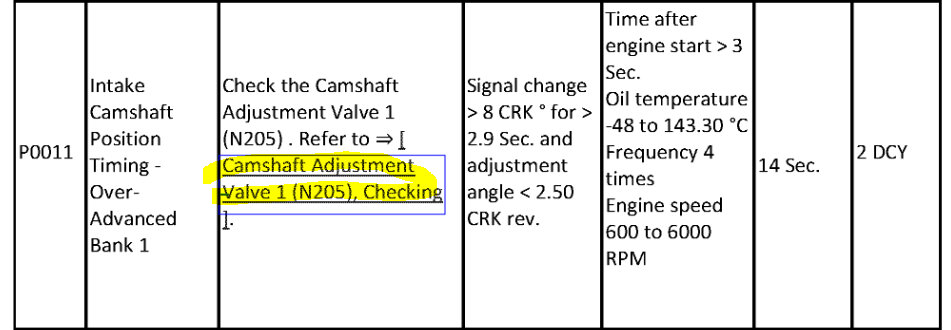

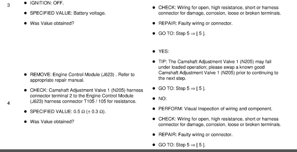

Here are the codes from the shop's diagnostics:
P0341: camshaft position sensor A
P0011: camshaft position timing over-advanced
P0300-P0304 for the misfires
Oct 5, 2024 at 10:47 PM
  • 110,240 POSTS

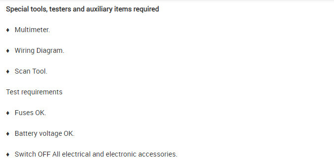

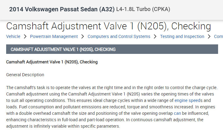

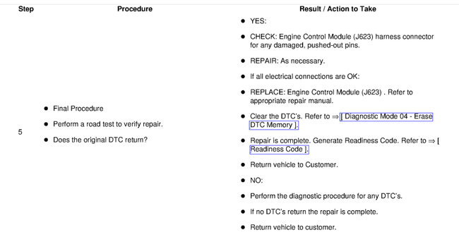

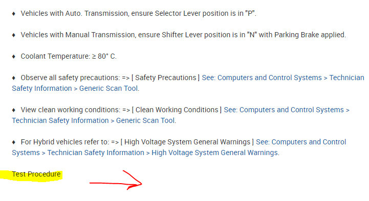

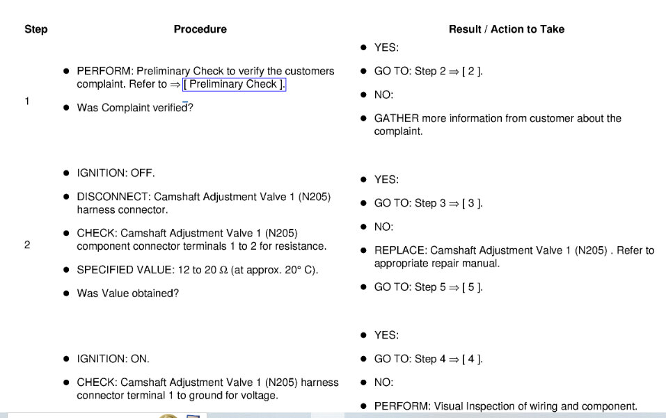

The codes you provided are related to intake valve timing. If I was to start testing, I would focus on the P0011 first.
Take a look through the directions below and let me know if you are comfortable performing the diagnostics.
Let me know
