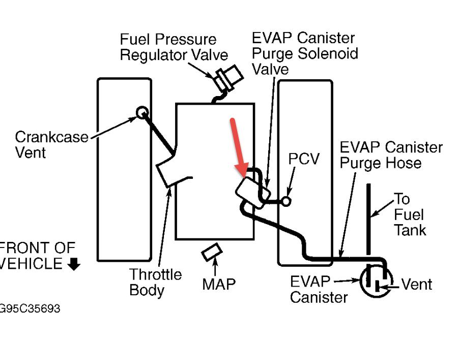

check for a vacuum leak, may be a hose or something leaking also check to make sure intake manifold bolts are tight check the lower bolts if you can should be 30 ft. lbs. torque also check evap connister purge valve it may be opening up at idle and shouldn't be. it will h ave vacuum on both sides if it is . see pic it's on right side of engine.

Thanks, the evap canister purge valve could very well be it I will check into it and see if I can find it lol

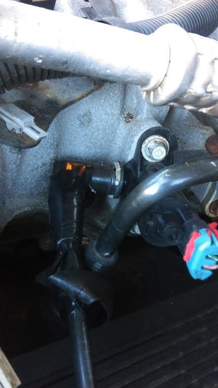

I do know there is a line that is plastic that broke a year ago r so that runs from a canister and has been taped since? would that be my problem

it's probably a vacuum line and yes it could do it. get a piece of small hose at auto parts and slip over where it's broken not tape but check purge valve as well

ok and is there a way to tes the purge valve I see that connection goes right to the valve itself that ataches to the motor?

REPLACED THE LINE TO THE PURGE VALVE AND REPLACED THE PURGE VALVE STILL NO CHANGE ??
