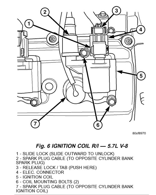

I have the truck listed above 1500 5.7l hemi magnum v8. Driving down highway. Etc light came on. Loss of power. Limped truck home cleaned throttle body which turned off light. The code was thrown for air temperature sensor. Replaced. Had idle at 400 rpm's would stall. Changed coils. Nothing. Bought new throttle body. Did relearn process and idles better now at 500 rpm's but fluctuates. Not stalling still sounds bad. Get up to 45 mph and and running at about 1500 rpm's truck jerks a little. No error codes thrown. stuck don't know where to go from here.

Thanks Joe, but finally got to the root of the problem I'm pretty sure. Broken valve spring. Will be put In truck tomorrow morning so I'll know then. Thanks for the reply.

Wow, that will cause a rough idle if nothing else. Here are directions for replacement without removing the head. You will need to charge the cylinder with compressed air.

pic 1
5. Remove ignition coil connectors (Fig. 6).

CAUTION: The piston must be at TDC, and both valves closed on the cylinder to be serviced.
9. Remove exhaust/intake rocker arm shafts.
10. Install spring compressor, special tool # 9065.
NOTE: All valve springs and seals are removed in the same manner.
11. Charge cylinder with air.
NOTE: Tap the top of the valve spring retainer to loosen the spring retainers locks.
12. Compress valve spring and remove valve retainer locks.
13. Release spring compressor and remove valve spring.
NOTE: The valve springs are interchangeable between intake and exhaust.
14. Remove valve seal.
