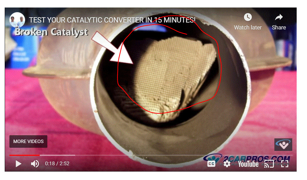

Hey, thanks for helping me out, I will try that tomorrow, and send a video, but just to put this out there; when I changed the front exhaust pipe there was some rock sort of substance in the old pipe, and muffler or that maybe the catalytic converter i cleared all of it out, but is that a bad signal?

Chances are the internal portion of the converter has come apart, and that's what you saw. See pic 1 below showing the insides of a converter, and see if it looks anything like what you saw. Also, here is a video that you may find helpful:
Let me know what I can do to help.
See pic below.
