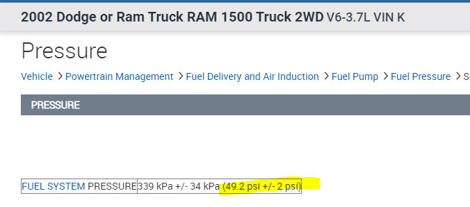

Sputtering noise during acceleration up until third gear. The engine is in good condition. This problem just started a few days ago after purchasing the car last week. Before then the truck ran pristine. I have done an oil change and a tune up on it.
Can you please help?

It sputters through all gears until I'm coasting. No smells though. Check engine code reads o2 sensor. May it be the fuel filter?

As far as the issue is concerned, it can be caused by several different things. As far as a fuel filter is concerned, yes, anything that can cause the fuel pressure to be lower than needed can do it.
Next, I don't feel the O2 sensor is the cause, but could you send me the code, so I know exactly what you are dealing with?
If interested, here is a link that explains in general how to check fuel pressure:
I attached the manufacturer's fuel pressure specifications below.
Let me know what you find as far as fuel pressure. You will need a fuel pressure gauge, but most parts stores will lend one to you.
See pic below.
