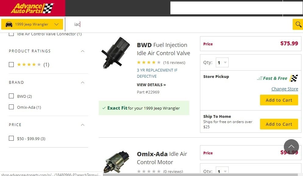

Removing the IAC and cleaning it and it's hole with throttle body cleaner might fix your idle problem. It might also be that it is at the end of the trail. The cleaning is a lot cheaper than replacement, one must always also weigh out how long it has been faithful and will not last forever!

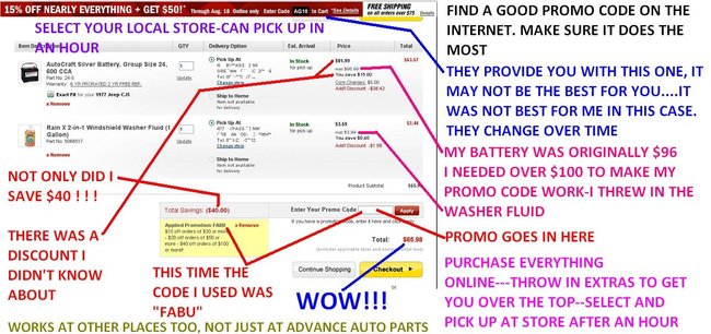

If you are thrifty, coupons and promo codes found on the net can really knock the cost of parts down! (older example with pic 2 it worked well)
