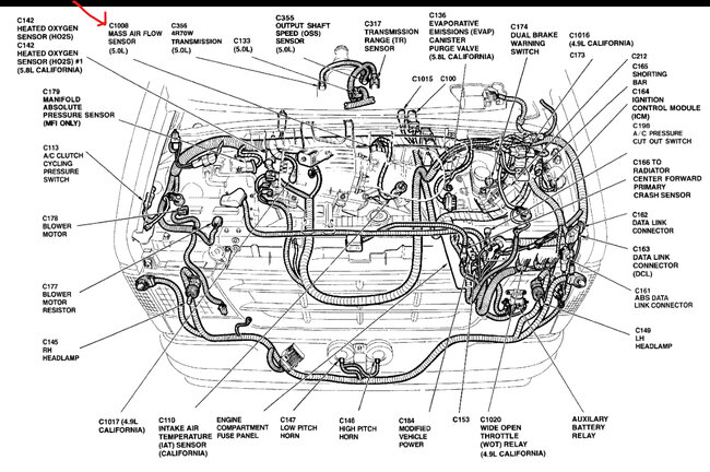

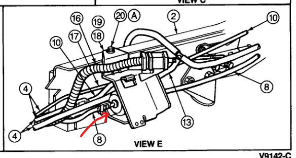

You have a bunch of lean codes so have you changed the fuel filter? if not, that is where I would start, here is a guide to help you more:
https://www.2carpros.com/articles/repairing-engine-rough-idle-issues
I would also service the throttle bore, make sure there are no vacuum leaks, and I would swap out the MAF sensor,
This guide can help as well:
Here are the fuel filter and MAF sensor locations so you can change them out. Check out the images (below). Please upload pictures or videos in your response of any problems so we can see what to help you with.
