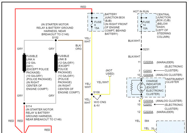

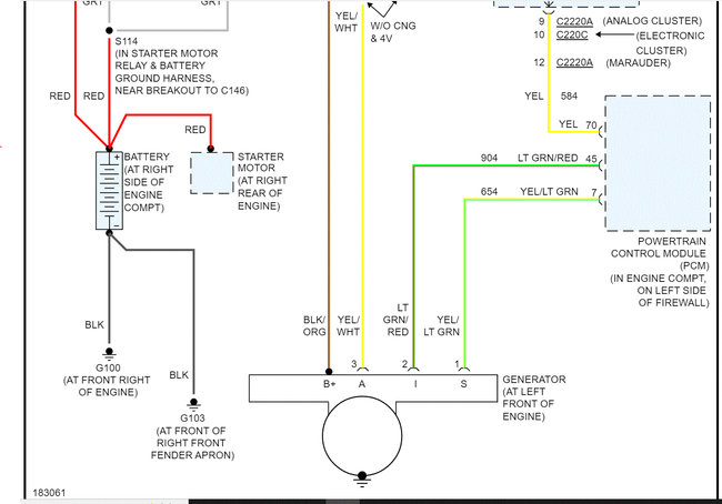

We need to determine if power from the alternator is making its way to the battery. Also, there needs to be battery voltage at the alternator also.
Try this test and let me know the results. All you will need is a voltmeter or multimeter.
If you are not getting a charge, go to the alternator. There will be a black wire with an orange tracer. That wire should have 12v at all times. Confirm that is the case.

That sounds perfect. Was the battery light flashing when it was being tested? If so, there could be a wiring issue at the PCM (powertrain control module). Just for curiosity, does the light flash only at low RPMs or does it also flash while driving?

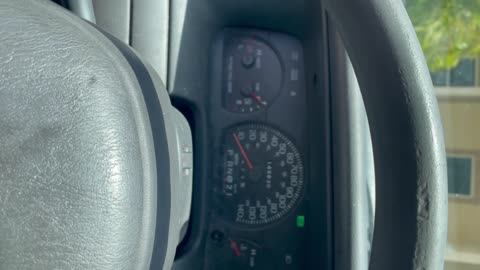

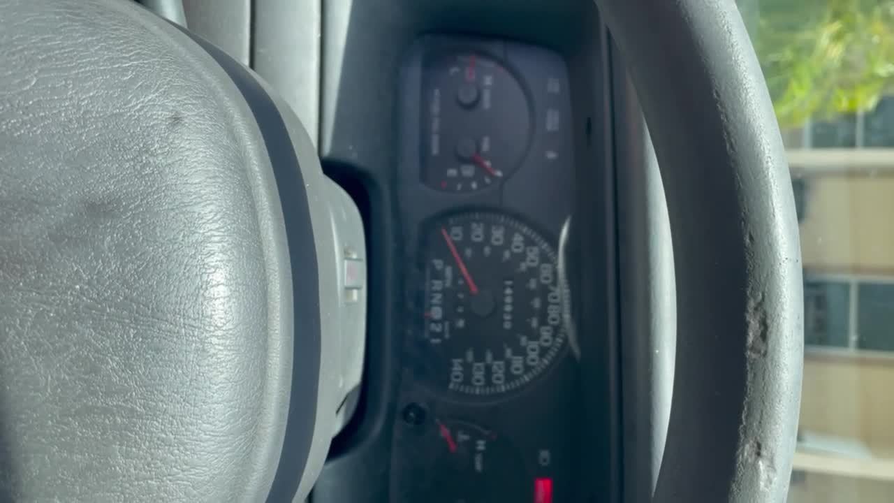

The battery light wasn’t flashing while being tested. It only flashes during low RPMs, never while driving but if I’m stopped at a light or stop sign the RPMs fluctuate and it flashes on and off. When I bought the car the check engine lights are on due to no O2 sensors because they cut the muffler and cats off along with a shift and torque solenoid, but it ran good just a bit slow with shifting to the point those aren’t an immediate concern and already have the replacement solenoids, just need the free time. I had them run codes, O2 sensors came up as expected along with the solenoid but I also had P0446, P0443 and P1747 show up which to my knowledge is new as my code reader can’t access the car. The long video attached is it starting up and the next one is after I got back from getting the codes read but it wanted to pretend to be okay then.

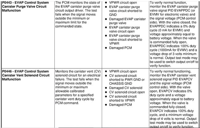

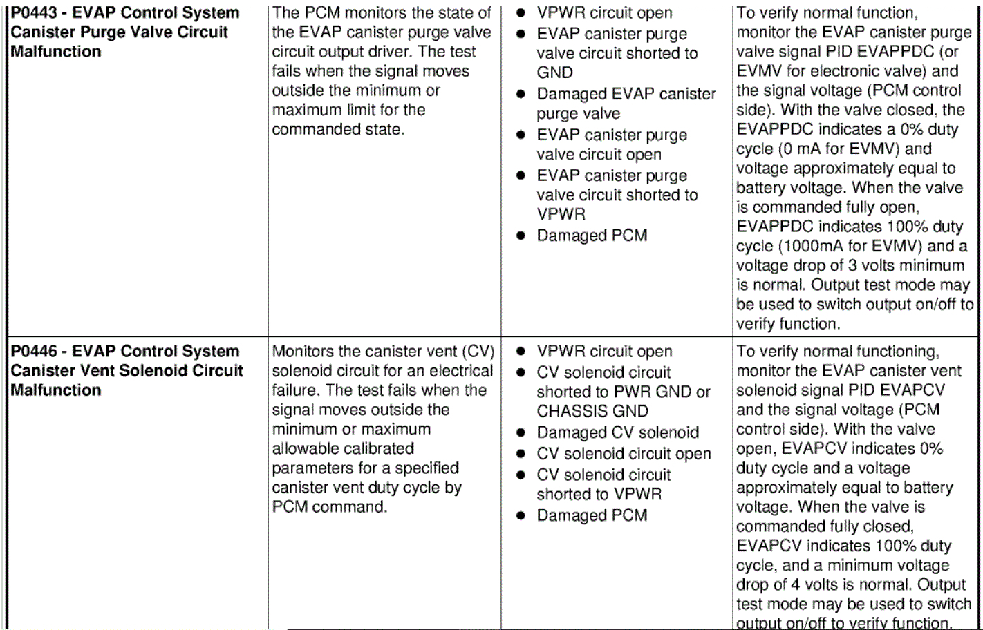

If it is getting that low, that could be the reason the charging light is turning on and off. Two of the new codes are related to the evaporative emissions system which could be causing the rough and low idle. That could result in the battery light flashing if it is idling low enough. One is regarding the canister vent solenoid and the other is the canister purge solenoid.
When you put fuel in the tank, have you ever had difficulty where the pump turns off, or have you ever noticed a fuel smell when the vehicle sits idle, parked and off, or after adding fuel?
If not, then we need to check the purge
Now, the P1747 isn't listed as a possibility for this specific vehicle. I know it deals with transmission pressure control solenoid issue. I don't feel this is the cause.

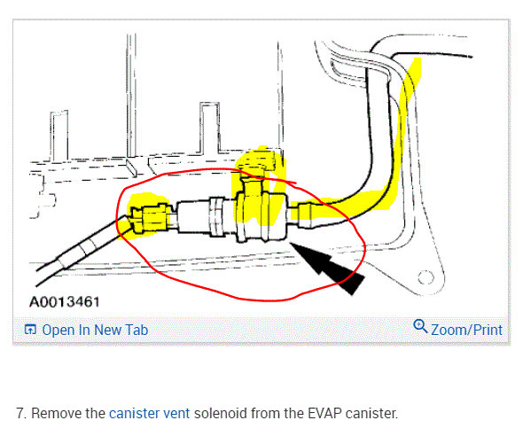

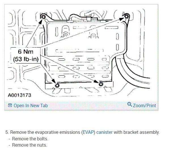

If you look at pic 1 below, it describes each of the new codes and possible causes. So, what I suggest is this. The solenoids are both electric. We need to check the wiring and connectors to them.

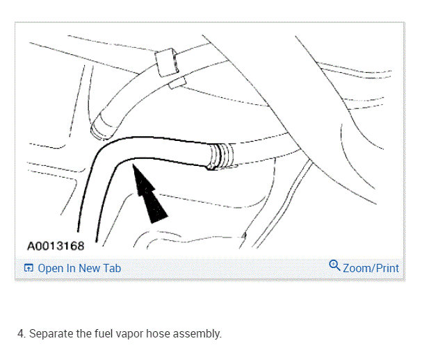

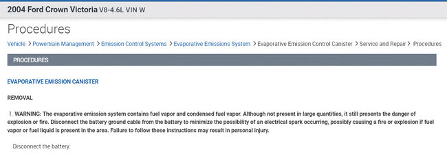

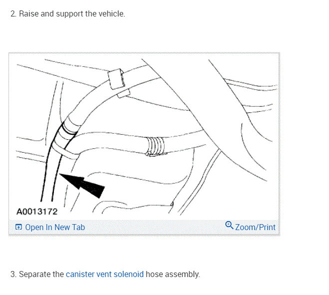

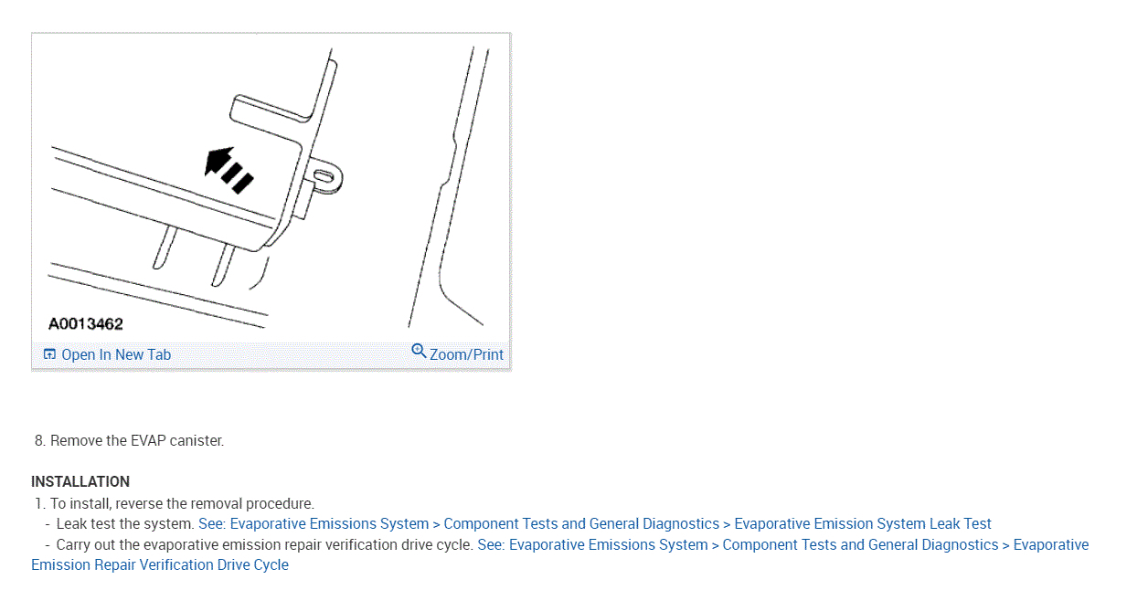

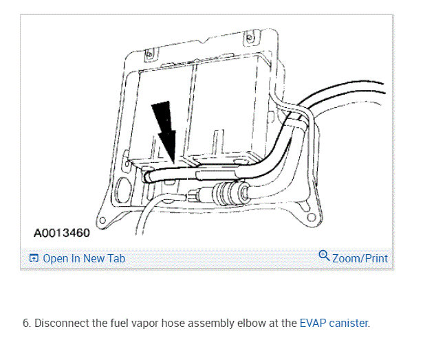

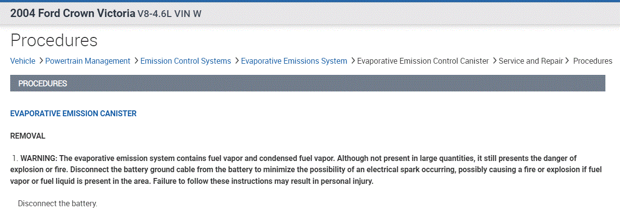

The canister and canister vent solenoid are located under the vehicle near the fuel tank. Starting with pic 2, I provided the directions for the removal and installation. Remove it and inspect the wiring and hoses to it.
The purge solenoid is located under the hood (I believe on the driver's side. I attached a pic of it below. Do the same thing with this. See the last pic.

The wires looked good along with the connectors on the end, but the vent solenoid and purge solenoid were all beat up looking and for sure have to be factory. I went ahead and replaced both of those, the issue is less worse, check engine light is now gone which is nice to see and it drives pretty good but once I’m in the driveway which is on an incline since I’m in SWFL, it goes back to bad. I attached a video starting in drive with foot on the break along with e-brake engaged with the battery light flashing then I put it into park and it’s firing gets better but not 100%.

Listening to the idle, it sounds extremely low. Are the same codes back? If they are, we need to smoke test the EVAP system to see if there is a leak.
