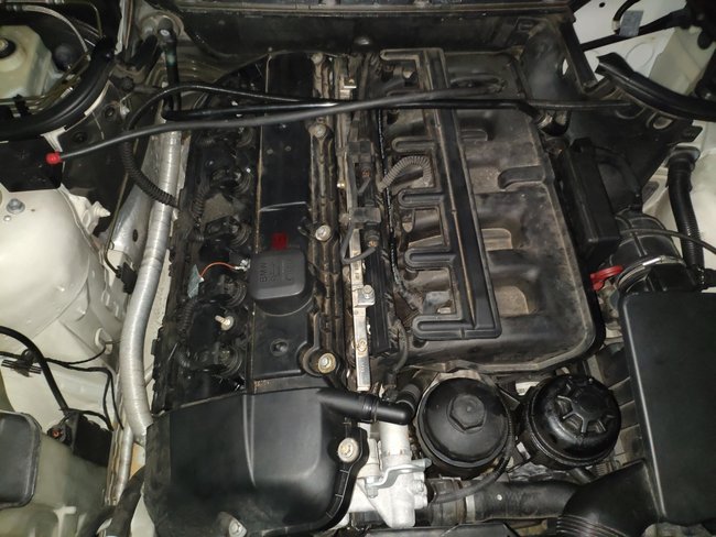

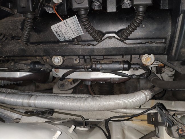

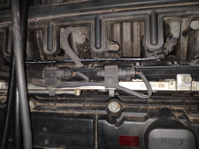

CYBAFORGE
  • 13 POSTS
Thanks for all the help!
I've attached some stuff:
Some photos of what I think are disconnected (temperature?) sensors on top of my engine?
One photo of some attached sensors on the side of my engine

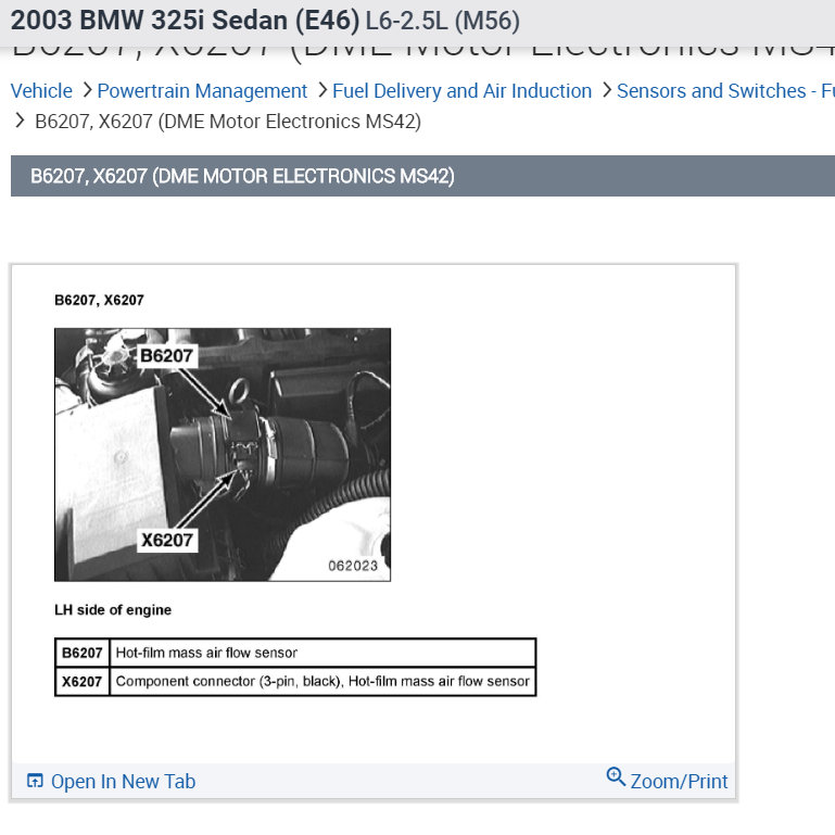

Try disconnecting the MAF sensor.
May 31, 2020 at 1:46 AM
KEEPITSIMPLE1
  • 17 POSTS
IAC: You can also try disconnecting this electrically. The idle might stabilize at a higher RPM. Disconnect and re-connect with the car off.
The MAF sensor sometimes does not set a code. With it disconnected, the car generally is driveable, but not quite right.

I actually think your getting somewhere and I think the MAF is bad. It doesn't always set codes. Sometimes, like you, you can't even keep the engine running.
I don't think you've been "throwing money at it".
I would go ahead and replace the sensor.
There are still lots of things that can cause eratic idle. Let me ask a question. Were the plugs or wires replaced that you remember? Bad wires or bad routing of the wires is another cause. You can "inspect" the wires. e.g. look for burn marks, are they close to the engine block, are they separated, do adjacent firing cylinders or waste spark cylinders run next to one another, covered with oil etc.
A disconnected MAF will perform better than an bad MAF sensor, The engine doesn't necessarily run smooth. Like I said...it's "not quite right".
