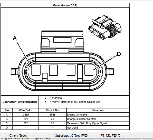

Because of your lights dimming in and out it's a sign of bad alternator.

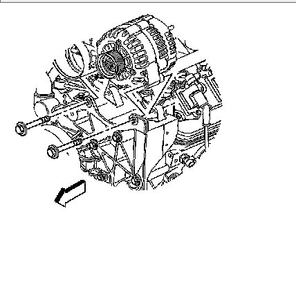

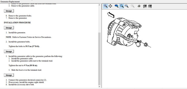

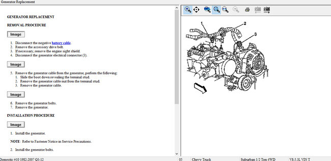

here is our guide how to check alternator:
https://www.2carpros.com/articles/how-to-replace-an-alternator
Check the alternator connector for corrosion and if it's tight, check the procedure and diagram below how to replace alternator.
hope these helps. lets us know what happens with you.
