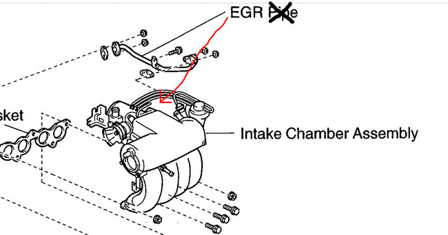

The first thing that comes to mind with a rough idle, is a vacuum leak. However, a vacuum leak won't fix itself. That leads me to the EGR valve. I'm questioning if it has a lot of carbon and is sticking.
Let's try this first. Check to see if there are any engine vacuum leaks. Here is a link that shows how that is done:
If you find no problems, then I would suggest removing the EGR valve and checking it and where it mounts on the intake to see if there is excessive carbon that could prevent the valve from properly working.
I attached a pic of the EGR location. It was the best I could find Let me know if you locate it.
