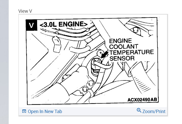

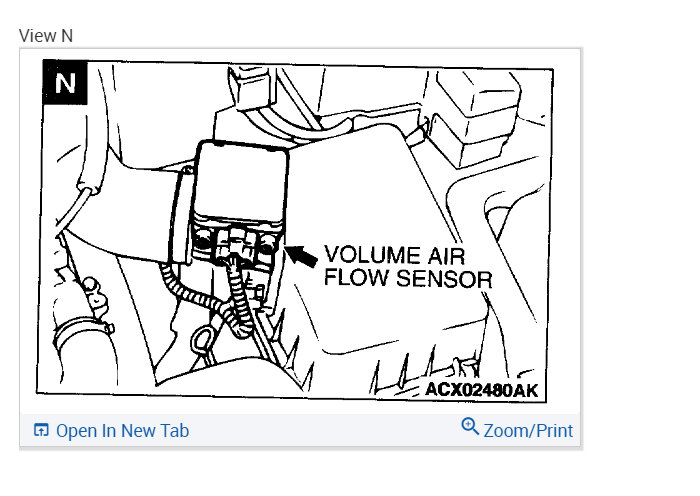

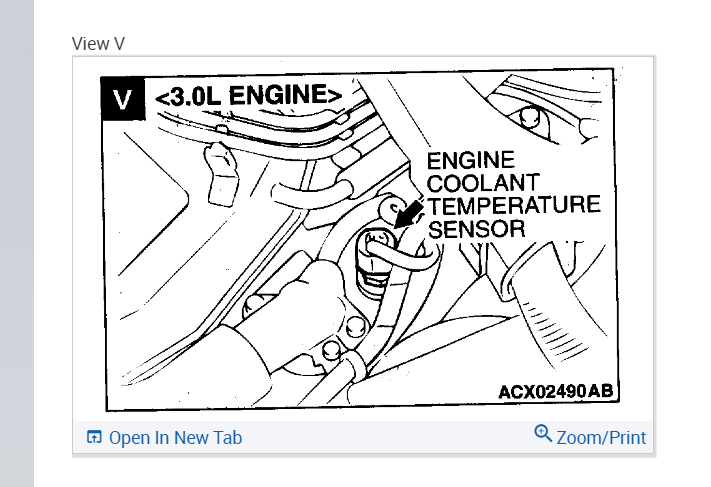

Yep, good call, a vacuum leak, engine coolant sensor or bad MAF sensor can cause this without throwing a code. I would check for a vacuum Leka first then try the MAF sensor. Here is a guide to help you check for a vacuum leak (engine cold only) and the locations of the sensors as well in the images below.
Check out the images (below). Please let us know what you find. We are interested to see what it is.

I've done a little more research into this and it seems to be pointing me away from a vacuum leak. If I had a vacuum leak, wouldn't it be difficult to start all the time, not just when it's hot?
I am not sure what I can do about testing the coolant temp sensor or the MAF sensor. It seems to me the only way to verify if one of those are the problem is to put a new one in and see if it corrects the problem.
Is that your assessment as well?
Nov 18, 2022 at 3:04 AM
  • 55,402 POSTS
Yep, a vacuum leak can affect the engine starting either how or cold depending on the volume of the leak.
