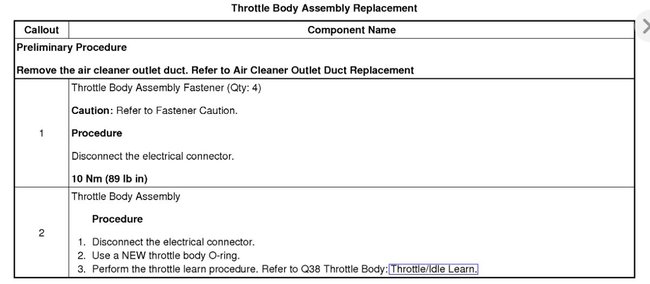

When i start my engine in the morning it idles at 1300 RPMs then 1,200 up 1,250 down 800 then 5 second stall.

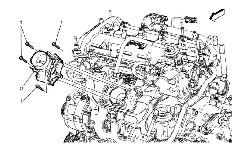

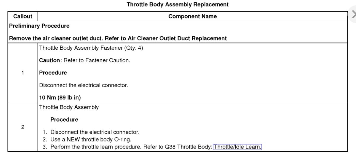

This sounds like it could be either a dirty throttle body or a bad throttle itself.
Is the check engine light on?
Q38 Throttle Body: Throttle/Idle Learn
Description
The engine control module (ECM) learns the airflow through the throttle body to ensure the correct idle. The learned airflow values are stored within the ECM. These values are learned to adjust for production variation and will continuously learn during the life of the vehicle to compensate for reduced airflow due to throttle body coking. Anytime the throttle body airflow rate changes, for example due to cleaning or replacing, the values must be relearned.
An engine that had a heavily coked throttle body that has been cleaned or replaced may take several drive cycles to learn out the coking. To accelerate the process, the scan tool has the ability to reset all learned values back to zero. A new ECM will also have values set to zero.
The idle may be unstable or a DTC may set if the learned values do not match the actual airflow.

Throttle Learn
Scan Tool Idle Learn or Idle Learn Reset Procedure - Performed after the throttle body is cleaned or replaced
1. Ignition ON, engine OFF, perform the Idle Learn or Idle Learn Reset in Configuration/Reset or Module Setup.
2. Engine idling, observe the scan tool Throttle Body Idle Airflow Compensation parameter. The Throttle Body Idle Airflow Compensation value should equal 0 % and the engine should be idling at a normal idle speed.
3. Clear the DTCs and return to the diagnostic that referred you here.
