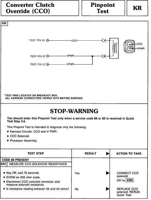

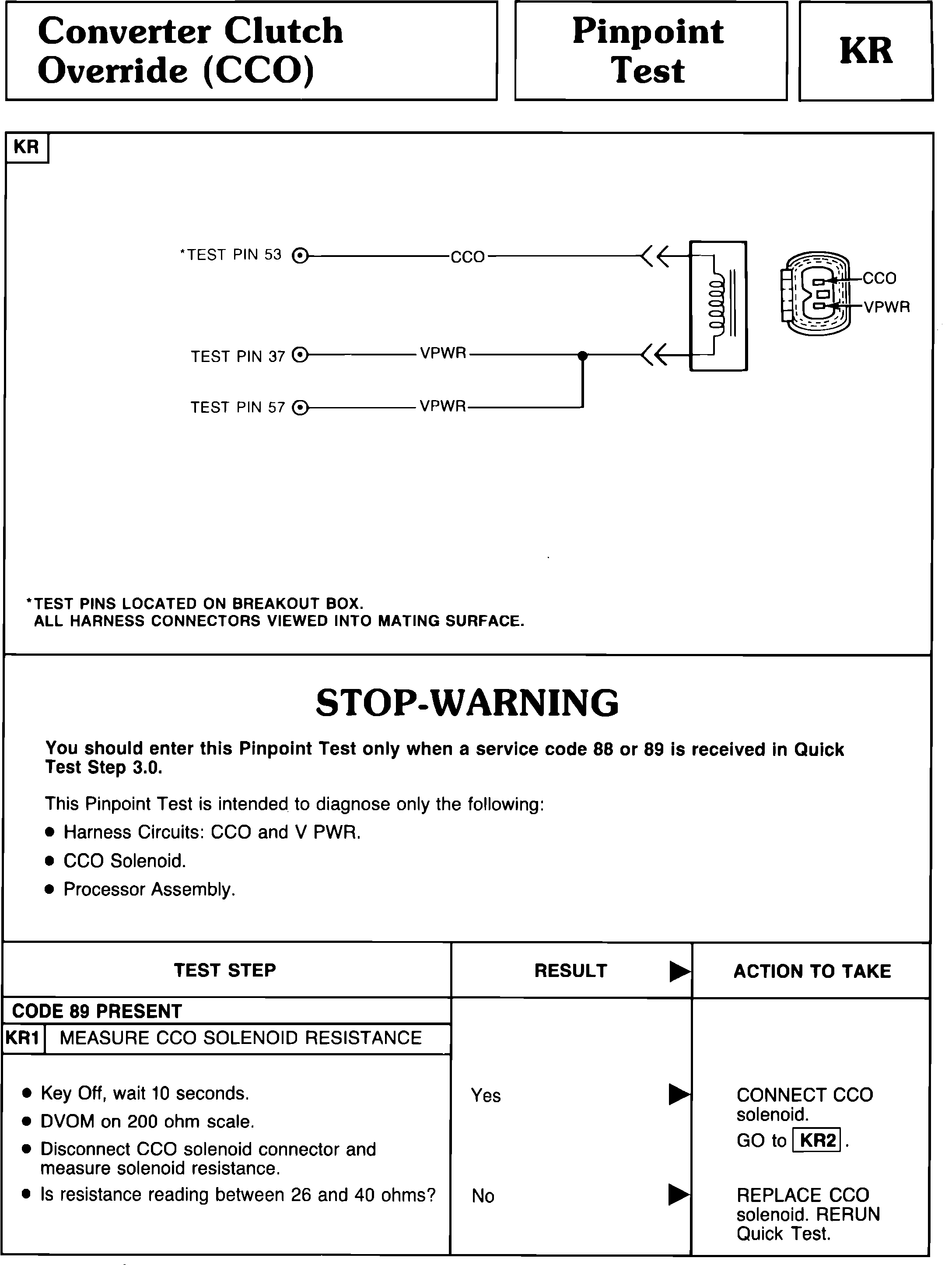

If the computer is for an automatic, yes it could be causing trouble. Code 89 is related to the torque converter clutch, so I understand why that one is on.

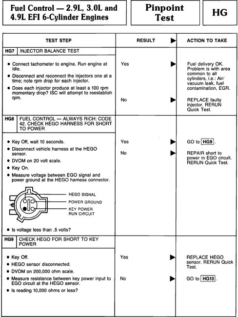

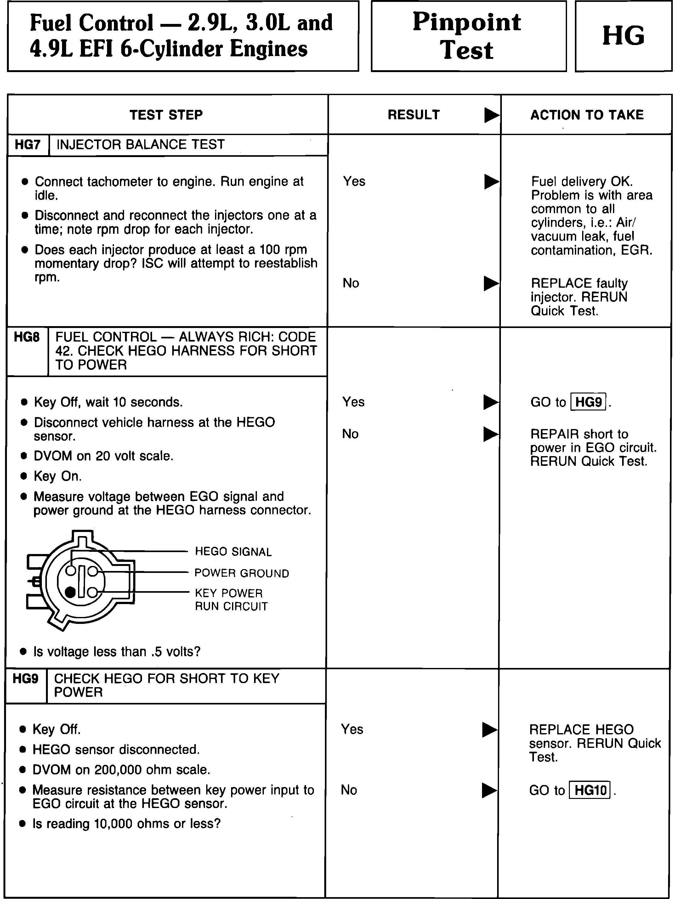

The one that I feel is most likely related to the issue with idle, is the 42. Code 42 indicates there is an issue with injector balance.

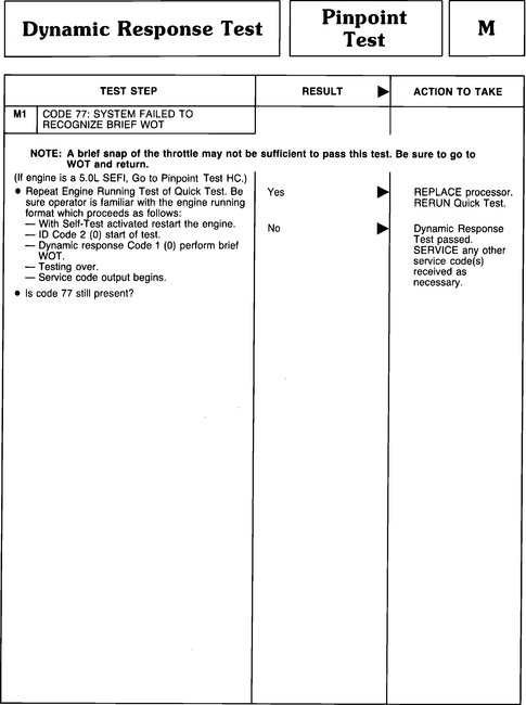

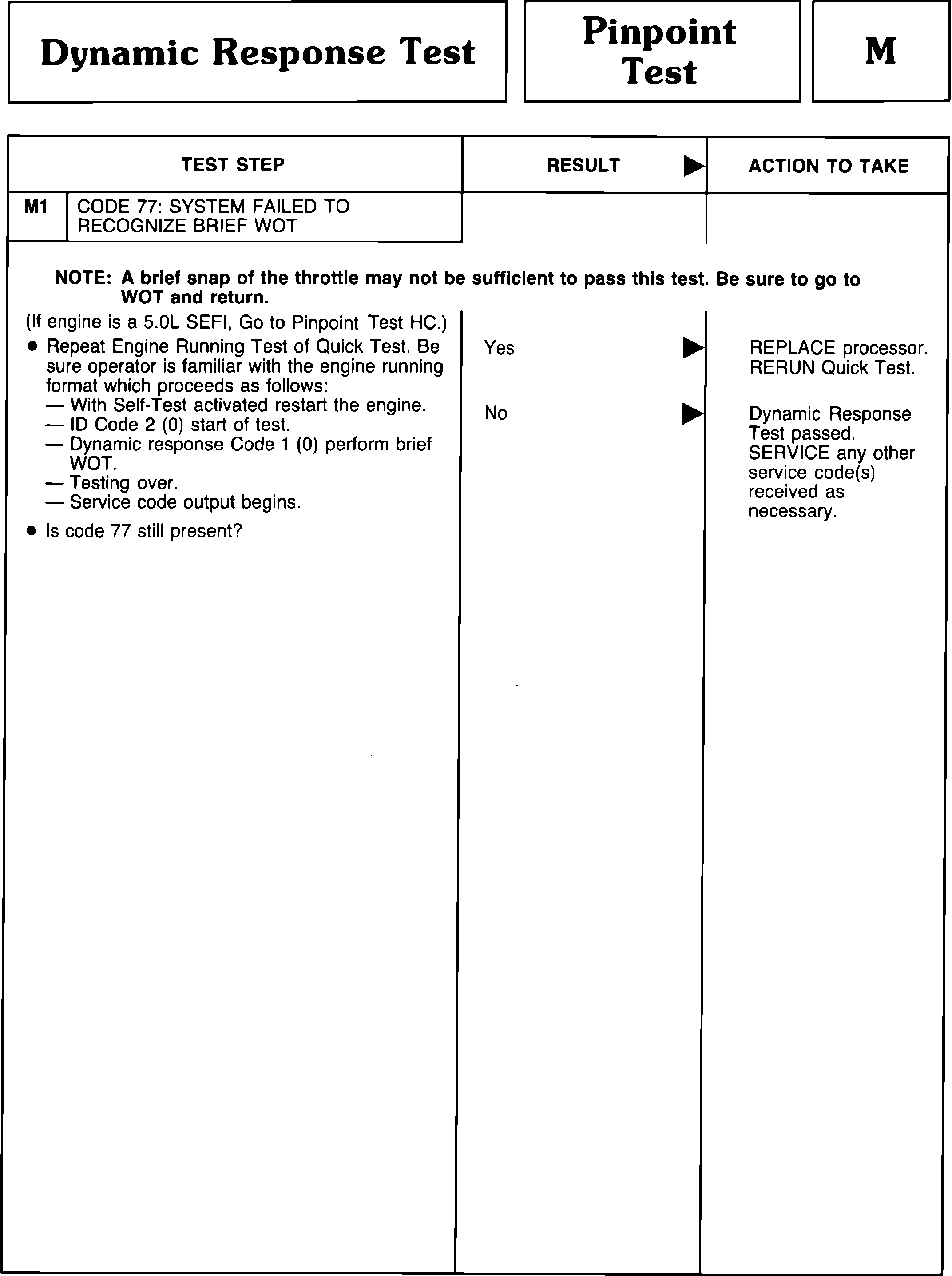

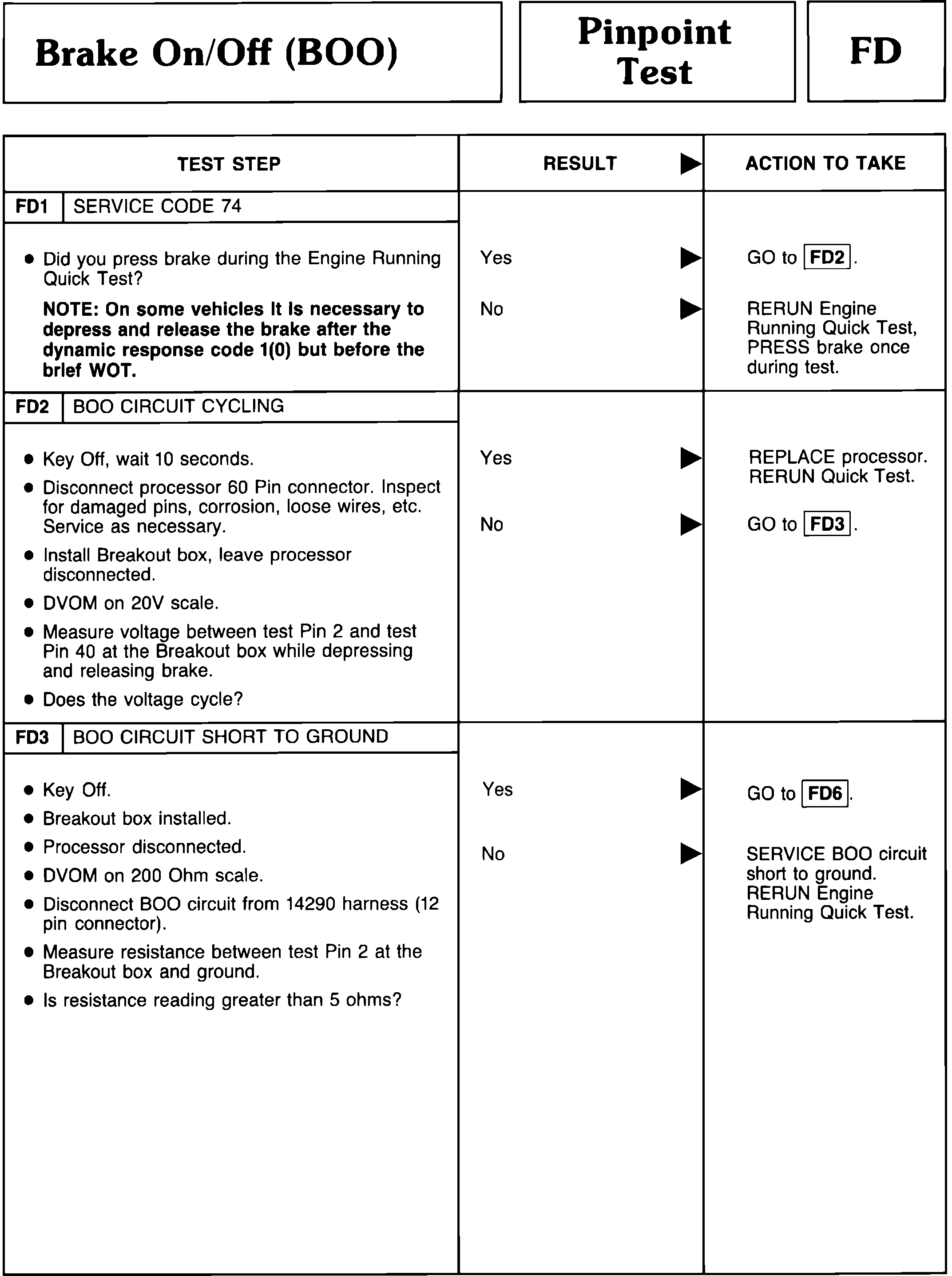

What I have done is attach specific tests below for each of the four codes I listed below. The only one I don't have is the 86. I thought maybe the numbers could have been transposed. Let me know.
Listed below I have the code and which pic is specific to that code. The pics are the diagnostics.
42 pic 1
74 pic 2
77 pic 3
89 pic 4

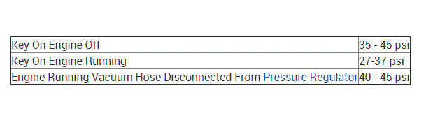

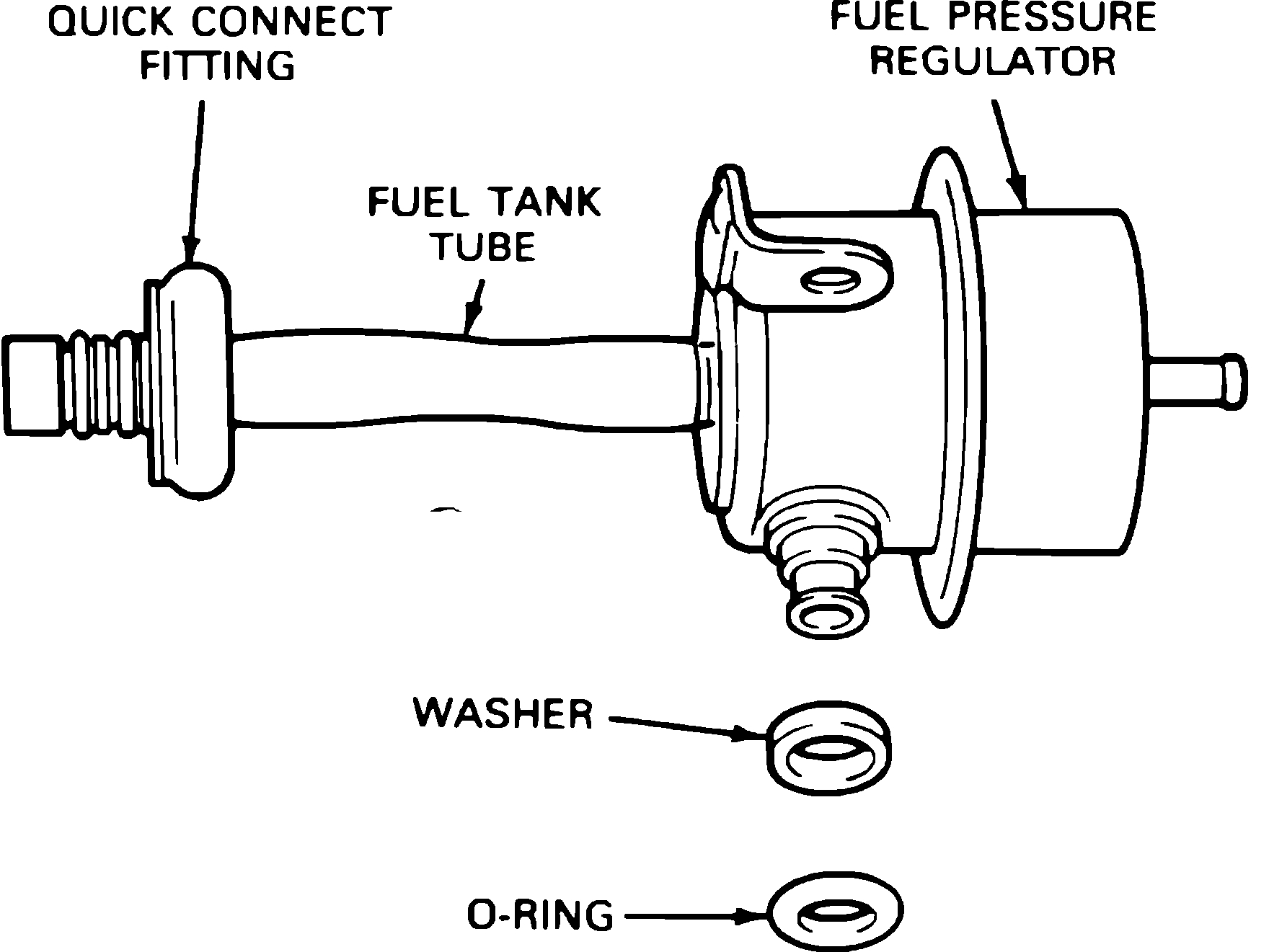

Don't get the injectors or computer yet. I want you to check fuel pressure. The fuel pressure regulator, (pic 1 below) is located on the fuel supply manifold and regulates fuel pressure supplied to the injectors. One side of the diaphragm in the regulator senses fuel pressure, while intake manifold pressure is applied to the other side. Nominal fuel pressure is established by spring tension applied to the diaphragm. A constant fuel pressure drop across the injectors is maintained by balancing one side of the diaphragm with manifold pressure.
With that, the regulator could be bad. Check pressure first. Also, remove the vacuum hose to the regulator and make sure there is vacuum to it when the engine is running and make sure there is no evidence of fuel in the vacuum hose.
____________________________________
Here is a link that explains in general how to check the pressure and regulator:
Pic 2 below shows the manufacturer's specs are far as pressure.
Let me know what you find.
