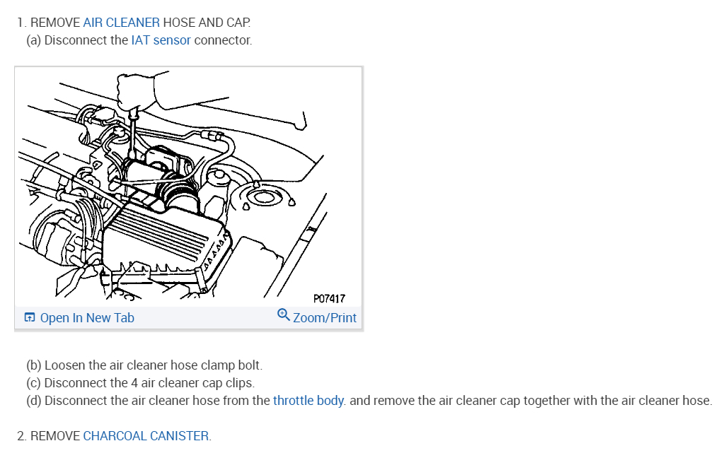

This can be because of a vacuum leak. I would use this guide when the engine is cold to confirm the leak:
This guide may help as well:
Please go over these guides and get back to us.

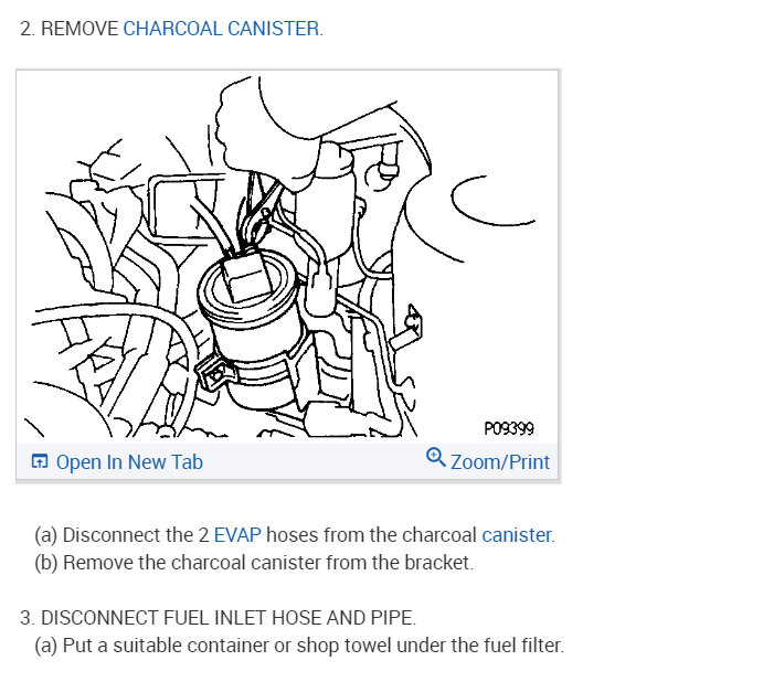

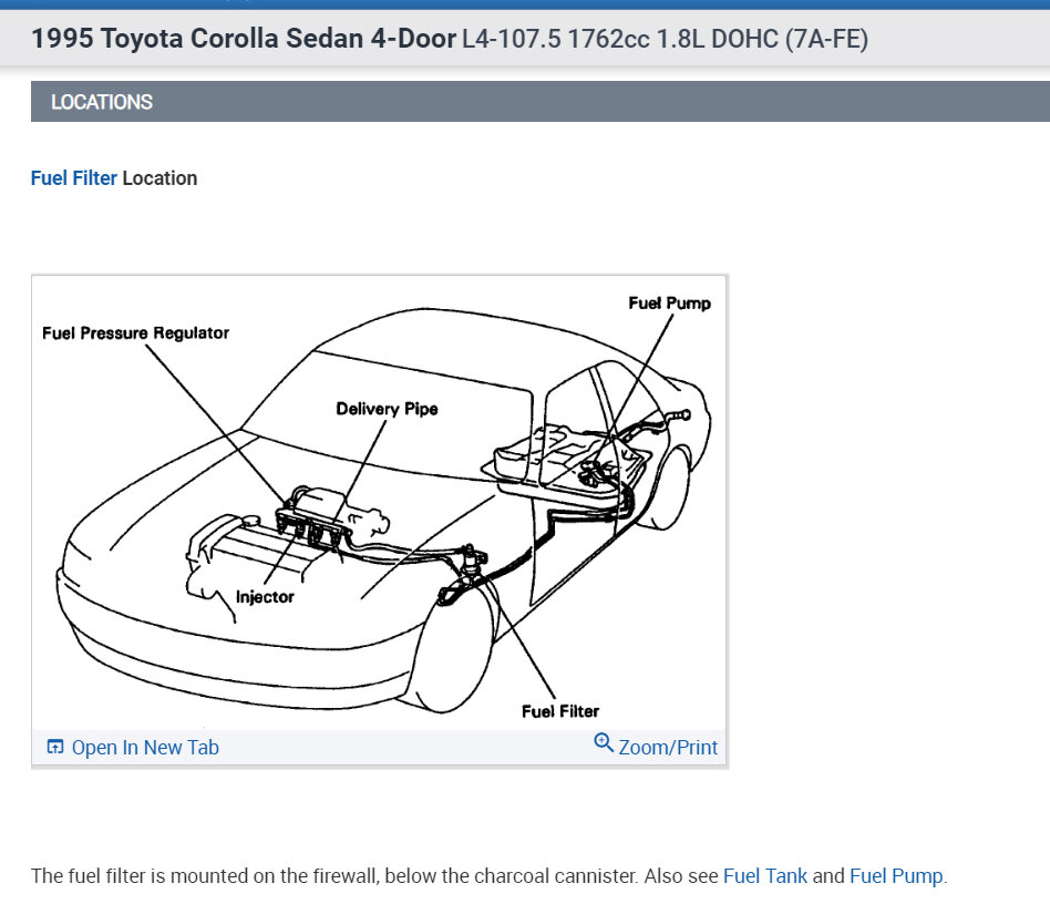

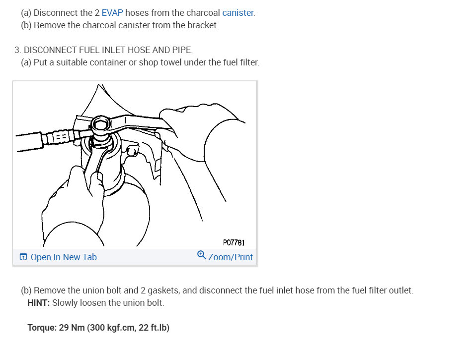

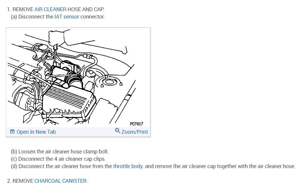

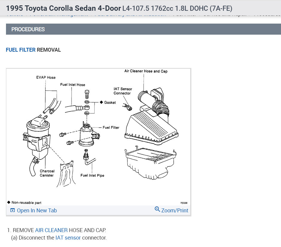

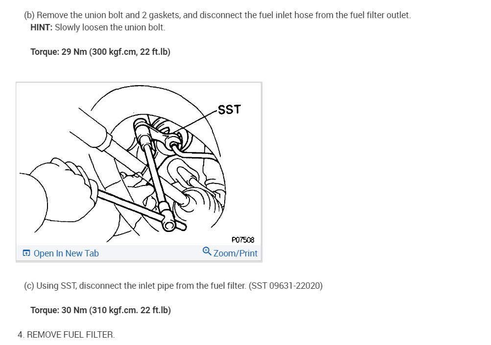

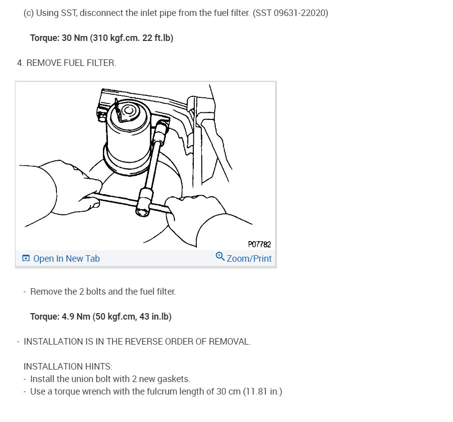

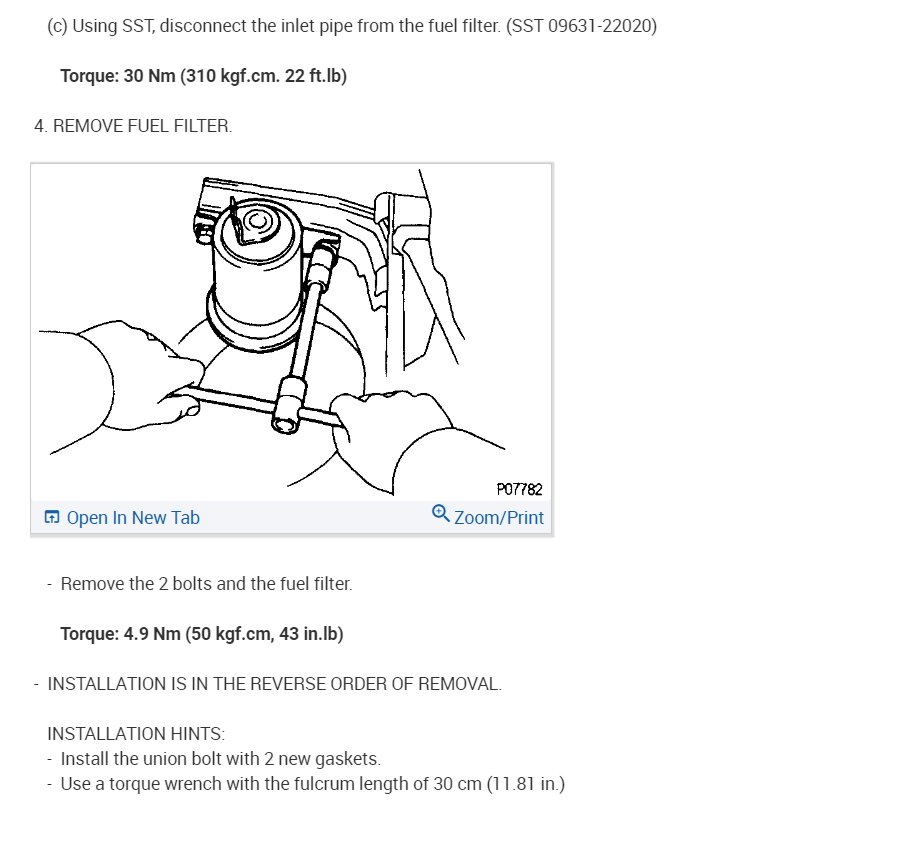

So, the compression is good, have you changed out the fuel filter? I would also service the throttle body.
This guide can help walk you through the service:
Here is the fuel filter location so you can change it out. Check out the images (below). Please let us know what happens.
