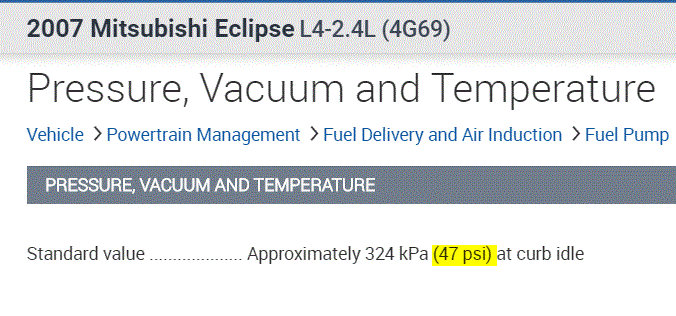

What parts have already been replaced? Also, a lean mixture can be the result of several different things. However, the most common are low fuel pressure or an engine vacuum leak. I have even seen an exhaust manifold (pre catalytic converter) leak cause it. Have you noticed any exhaust issues? It could actually sound like a ticking.
If not, the next thing I suggest is to check for engine vacuum leaks and fuel pressure. Here are two links to help with that process:
If you have already tried this, let me know. Also, let me know if you have a live data scan tool. There are several other things that can be checked such as a faulty engine coolant temperature sensor, air intake temp sensor, mass air flow sensor and so on.
The attached pic indicates the manufacturer's specs for fuel pressure.

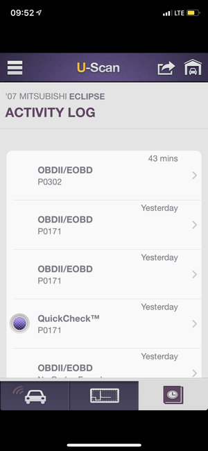

The P0302 indicates a misfire on cylinder 2. That is likely what you feel. Since there is a lean mixture, that could be the cause. Can you do me a favor? Take the live data scanner and check short term fuel trims and the oxygen sensor readings. Let me know what you find. Also, does the ticking sound go away after the engine warms up? Have you confirmed there are no vacuum leaks?

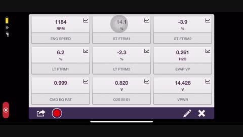

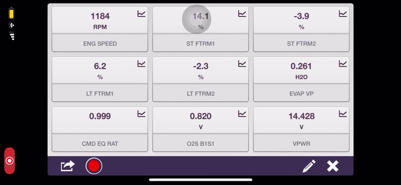

This is when I ran live data, all of the fuel trims are in there. The long term fuel trim doesn’t budge, but the short term jumps a lot.
Jun 5, 2020 at 8:04 AM
  • 110,244 POSTS
The O2 sensor is reacting properly. The STFT1 is really high, indicating the computer is trying to add fuel. STFT2 is right on. How does your scan tool differentiate or what does it differentiate between 1 and 2?
Jun 5, 2020 at 3:00 PM

Yes. In a perfect world, the fuel trims would be at 0. It's normal for them to fluctuate a bit. The one that is at 15 indicates it's trying to compensate by adding fuel to the mixture. If that number was negative (for example -15) that would indicate it is trying to limit the fuel. So the idea that it is +15 tells me it is trying to add fuel because there is too much air resulting from a leak or low fuel pressure.

It would be in the upper + (positive) range. Basically, where it is now. Under normal conditions, at an idle I would expect to see the STFT's to be changing between negative and positive 2-5%. It's staying near +15%.
