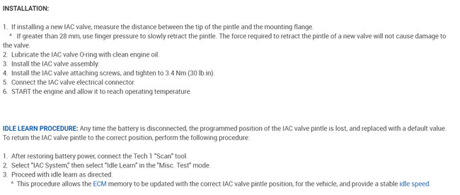

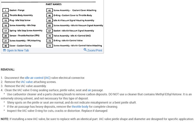

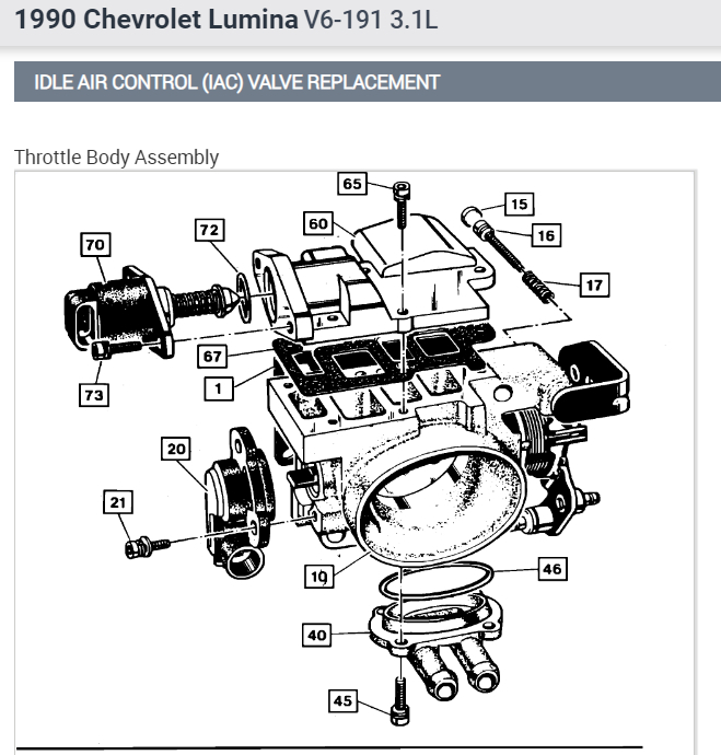

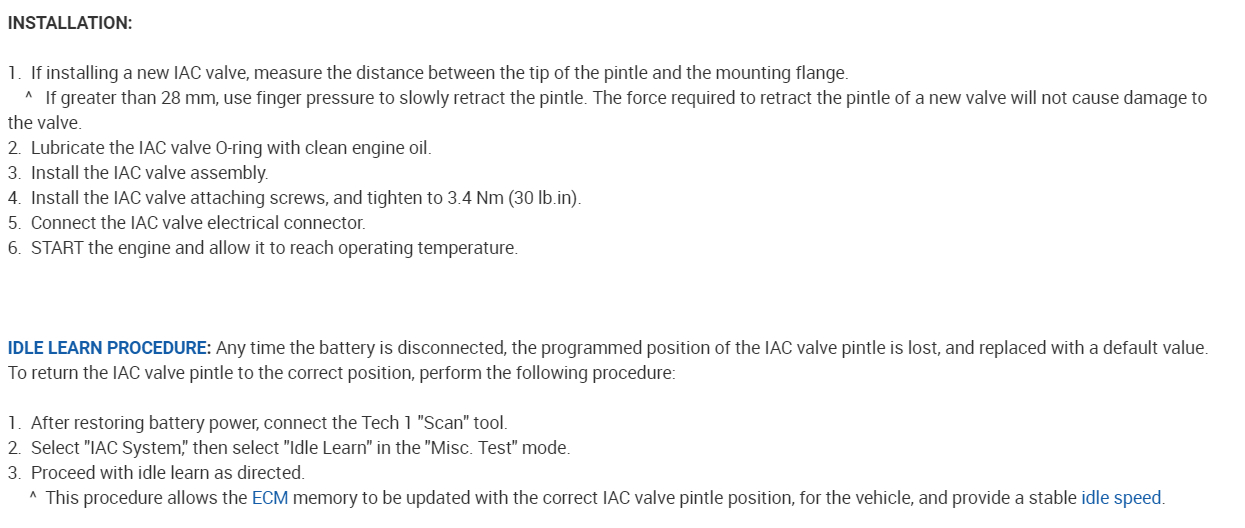

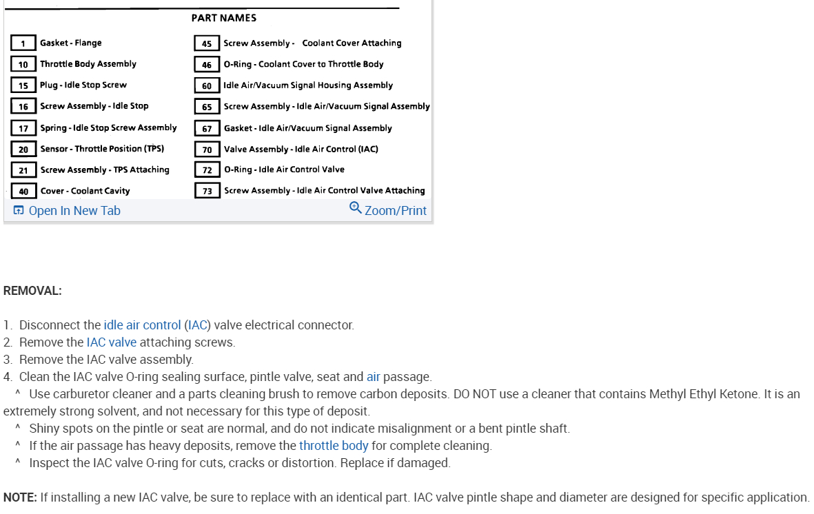

rough Idle and get so low it knocks off while driving.
Oct 5, 2023 at 3:27 AM
  • 55,456 POSTS
Hi Terrence,
Yes, the engine can knock when the idle speed gets too low, I would check for vacuum leaks and service the throttle body and idle air control valve, here are guides to help you fix it:
and this guide use when the engine is cold only:
https://www.2carpros.com/articles/idle-air-control-valve-service
Check out the images (below). Please let us know how it goes.
