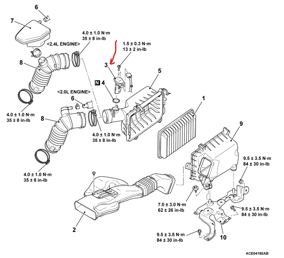

There are a few things that can make it act this way, vacuum leaks, weak MAF sensor, low compression in one cylinder, bad timing chains, please go over this guide to see what the popular problem are, I would try a new MAF sensor because I have seen these sensors cause this problem.
https://www.2carpros.com/articles/repairing-engine-rough-idle-issues
Here is the location of the sensor if you want to swap it out. Also, can you tell me the fuel trims? Please go over this guide to read them:

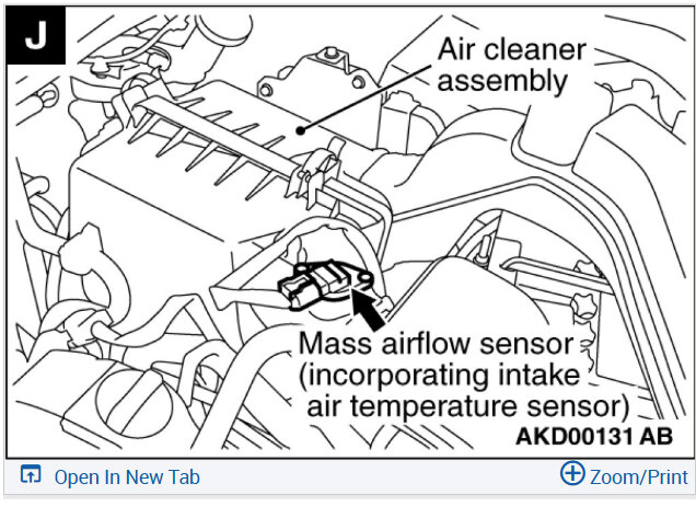

So what I see is the IAT sensor says it is over 100 degrees, is it this hot where you live? If not, I would replace the IAT sensor first, thanks for the videos they helped. Also, I see a bunch of erratic readings fuel trims, but the IAT might cause this so let's replace that first and clear any codes once competed, here is the location of the sensor which is part of the MAF sensor just to let you know.
