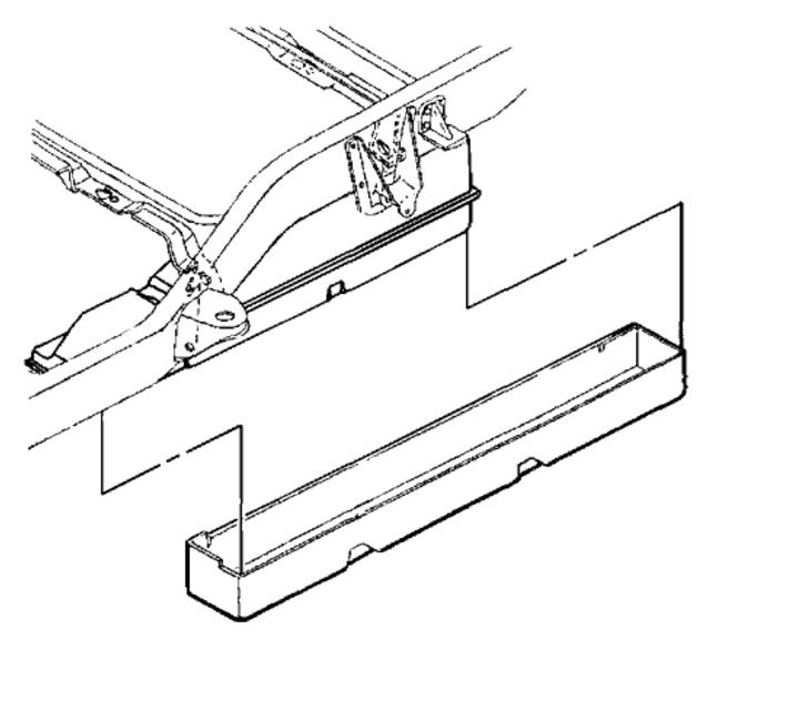

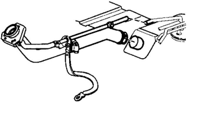

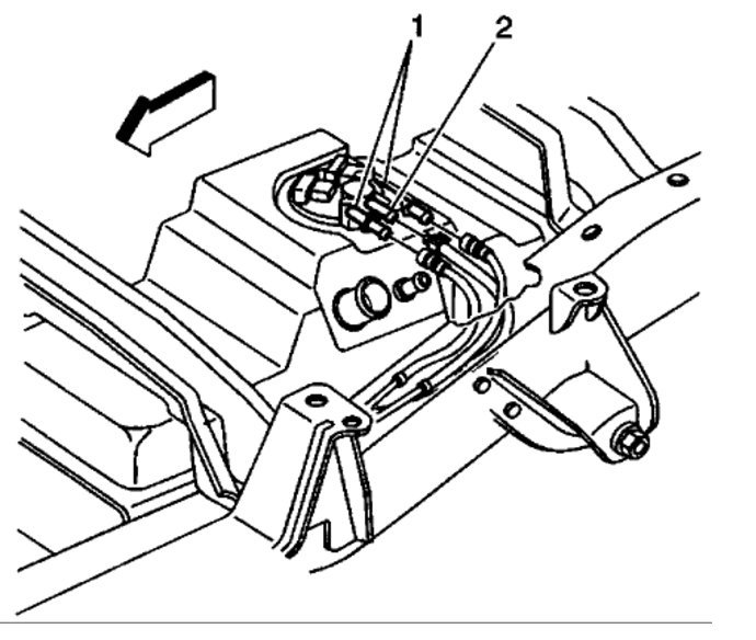

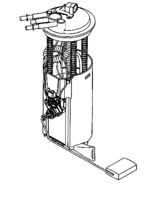

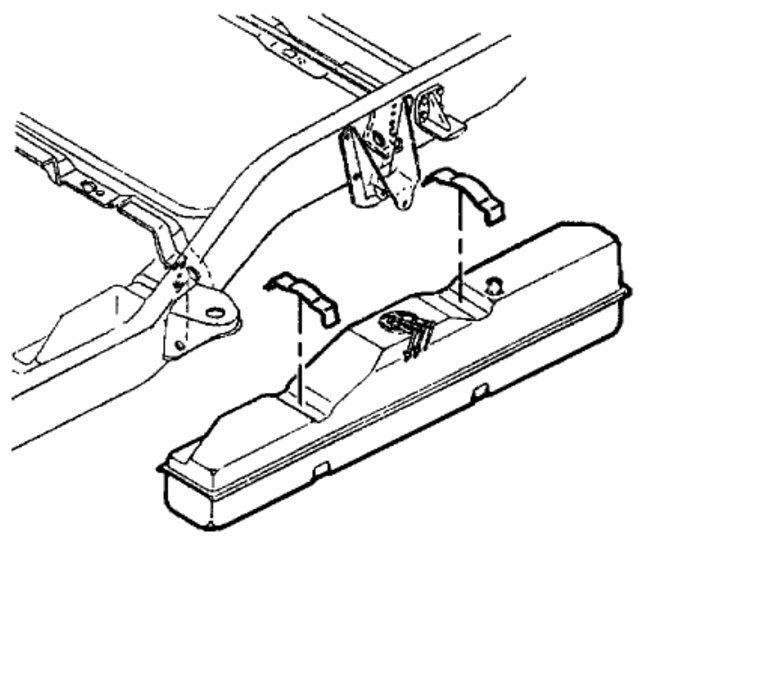

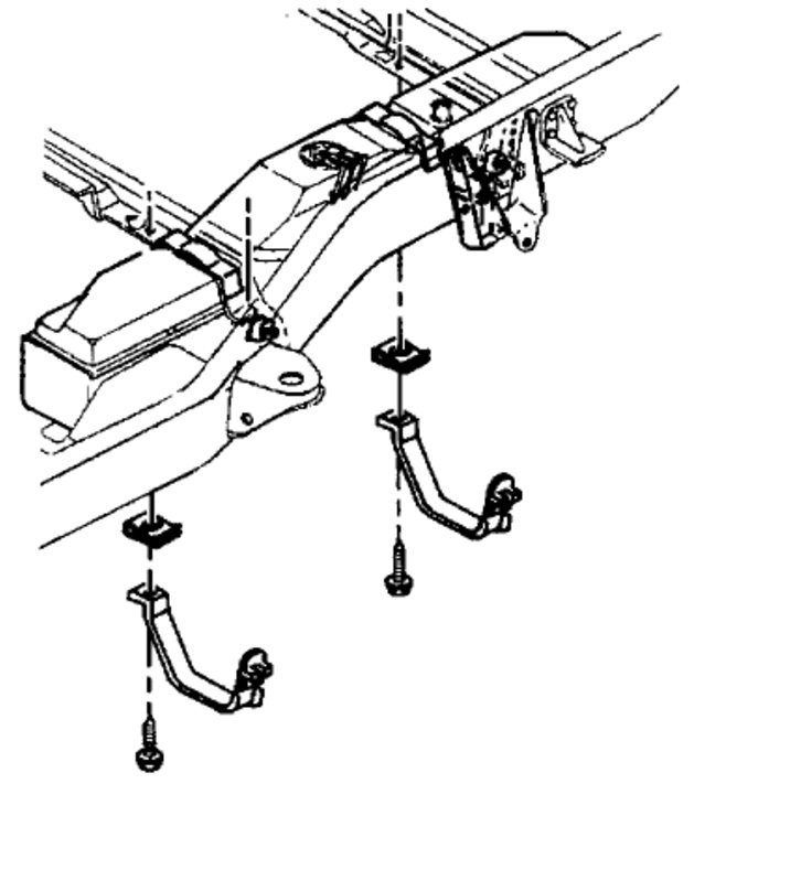

Yes the fuel pumps go out in these trucks all the time. I have put two in my truck.
Here are some guides and some diagrams (below) to help you get the job done:
and
