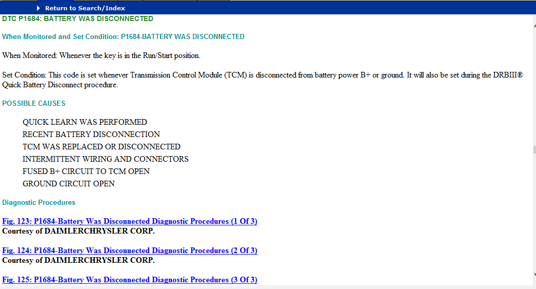

I have replaced the MAP sensor and coil pack, spark plugs and wires. And it is still running rough. I also did the turn the key 3 times and got the code P1684.

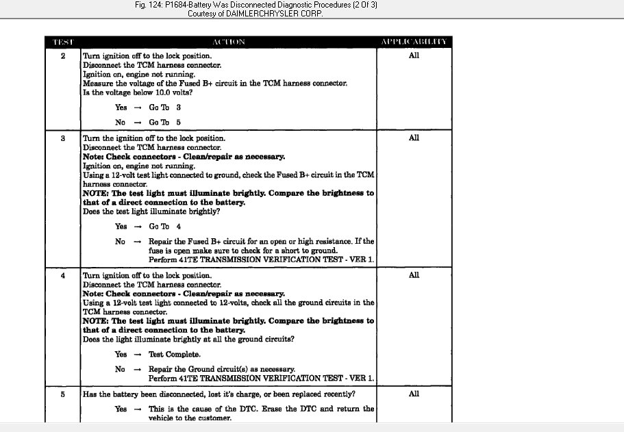

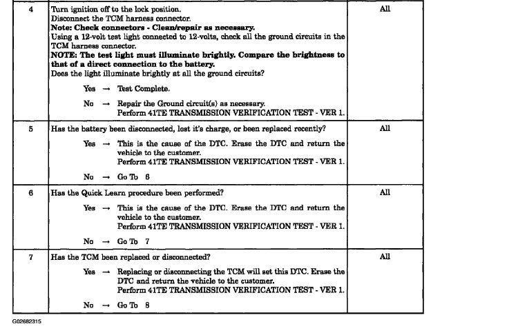

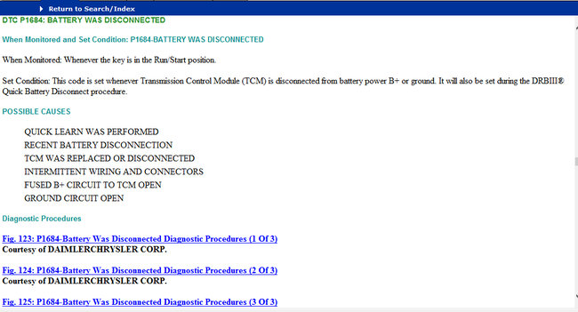

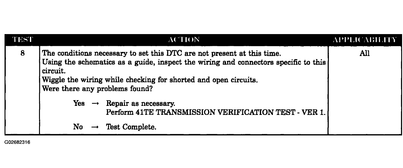

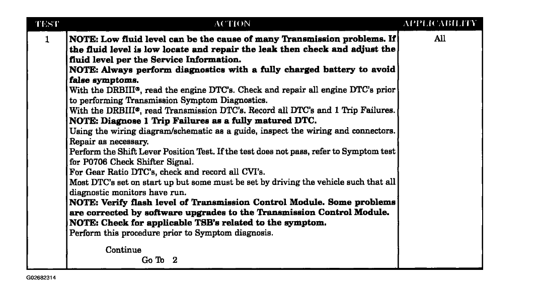

hello,

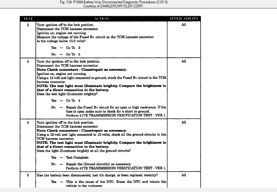

I don't think engine rough running is related to fault code p1684, this fault is related to transmission, battery positive disconnected or disconnected from the transmission control unit. check the attachment below for the diagnostic procedure for fault code p1684.
use scan tool read the fault codes to narrow down our problem, check our guide how to read faults.
https://www.2carpros.com/articles/engine-hesitates

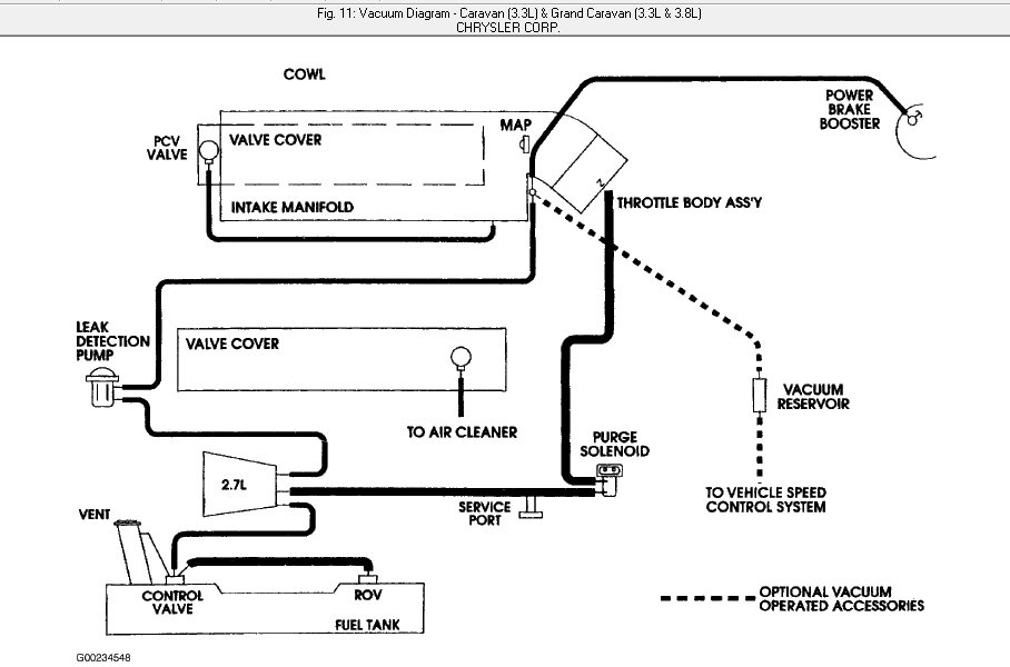

Check for any vacuum leaks that can cause also engine rough running.
