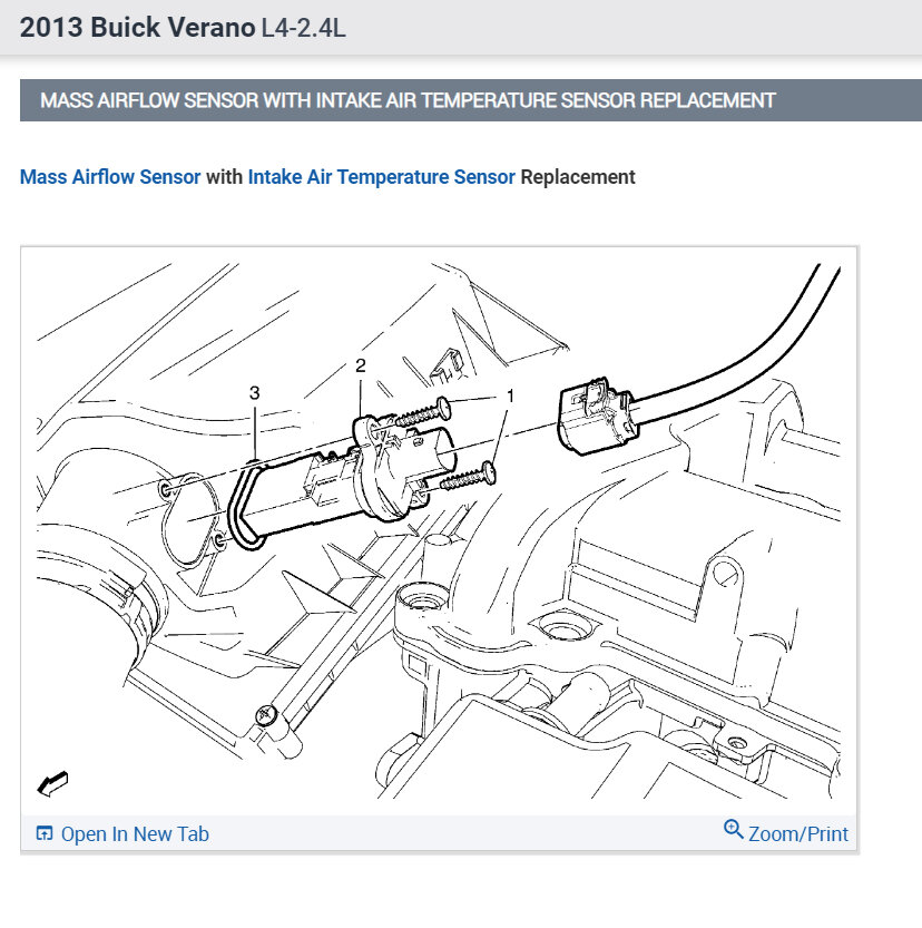

Thanks for the detailed question, I appreciate it.
MAF (lbs): 0.01

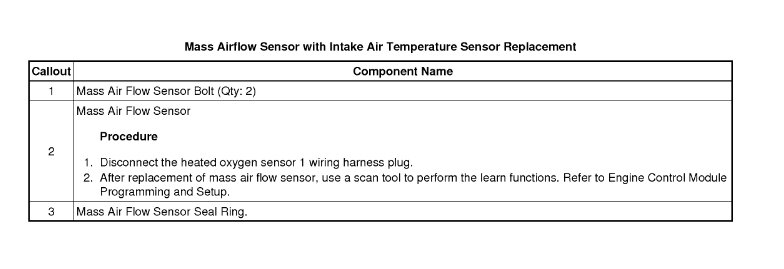

This is the problem; this is way too low I would get a new MAF sensor because cleaning doesn't always work. Here are the instructions on how to change the sensor out which should fix the problem. Let us know what happens and please upload pictures or videos of the problem so we can see what's going on.
This guide can help as well:
https://www.2carpros.com/articles/troubleshooting-rough-idle-in-your-cars-engine-7-common-causes-and-how
