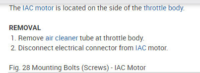

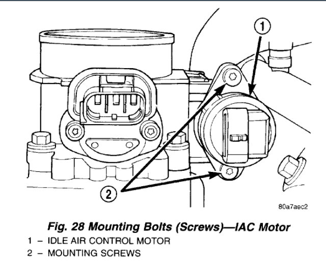

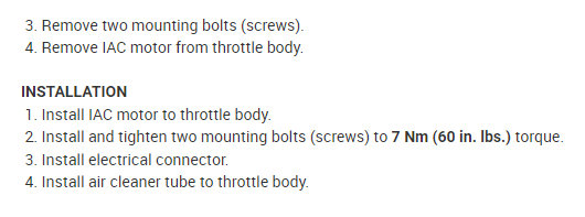

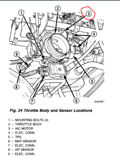

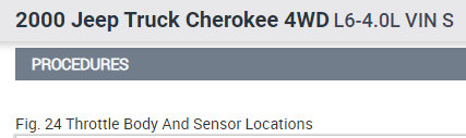

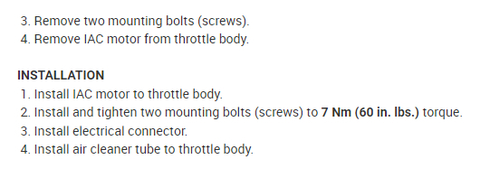

It sounds like you might be having an issue with the IAC - idle air control motor. Here are two tutorials for you to view relating to IAC motor cleaning and replacement:
https://www.2carpros.com/articles/idle-air-control-valve-service
https://www.2carpros.com/articles/how-to-replace-an-idle-speed-control-motor-iac
I've attached picture steps below showing how to replace the IAC on your vehicle. Hope this helps and thanks for using 2CarPros.
