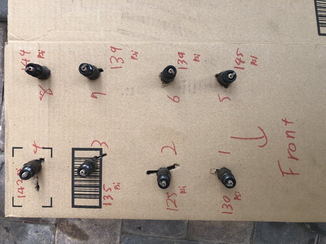

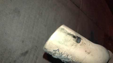

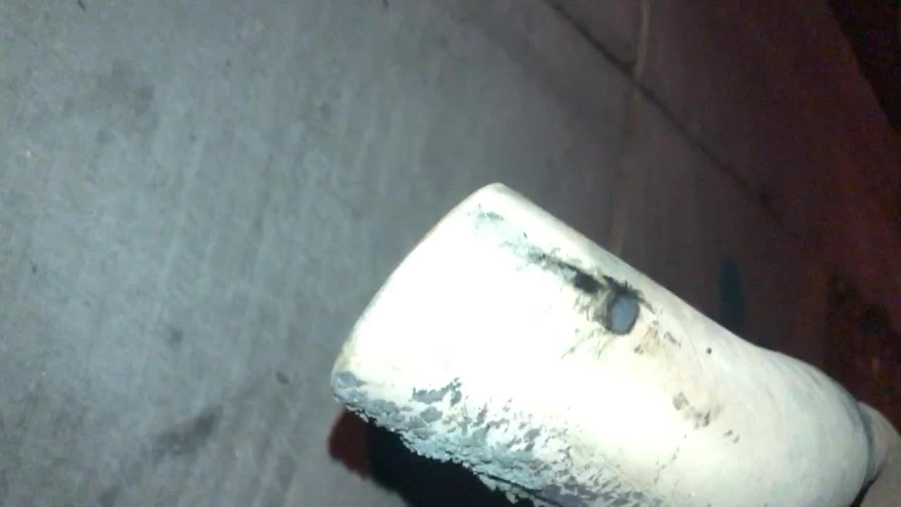

Good morning. Thank you for replying my post. I have done compression test, fuel pressure test, manifold vacuum test and it’s all in normal range. I have also checked spark plug but it was nice brown color. I’m not sure if my cat is clogged up or not. I do smell a lot of exhaust fumes from my tailpipe. My truck came with TFI-IV system so it doesn’t have any ignition module mounted on fender, but I have replaced entire distributor and coil including TFI module.

Did you eliminate it down to a particular cylinder and do the test I suggested?
