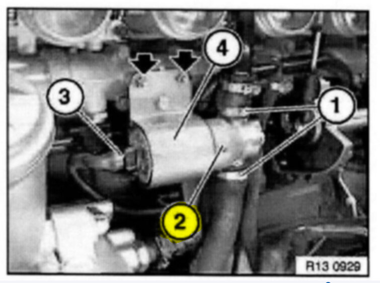

Hello, I am experiencing rough idling and vibrations in my car at lower rpms. I changed out some coils, checked for leaks (found none), and still no good. I used a scanner and it's throwing no fault codes, I'm having a mechanic check my ICV to see if it's failing. Can anyone point me to other things that could cause this problem? Thanks

When you say you checked for leaks, did you use something like carb cleaner to help? See link.
Next, I'm not sure if you tried, but oftentimes cleaning the throttle body bore will help this type of issue.
Also, there is an idle speed control valve under the intake that may be causing issues. I attached a pic of it below. However, this will usually set a code.
Let me know as much as you can.
See pic below.
