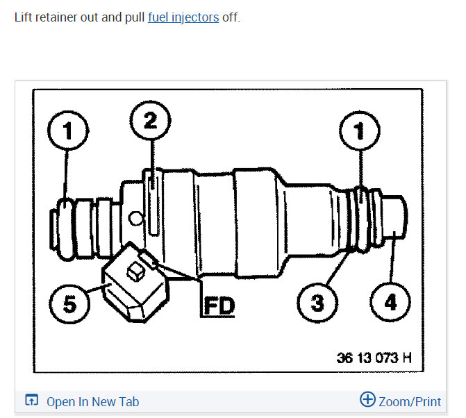

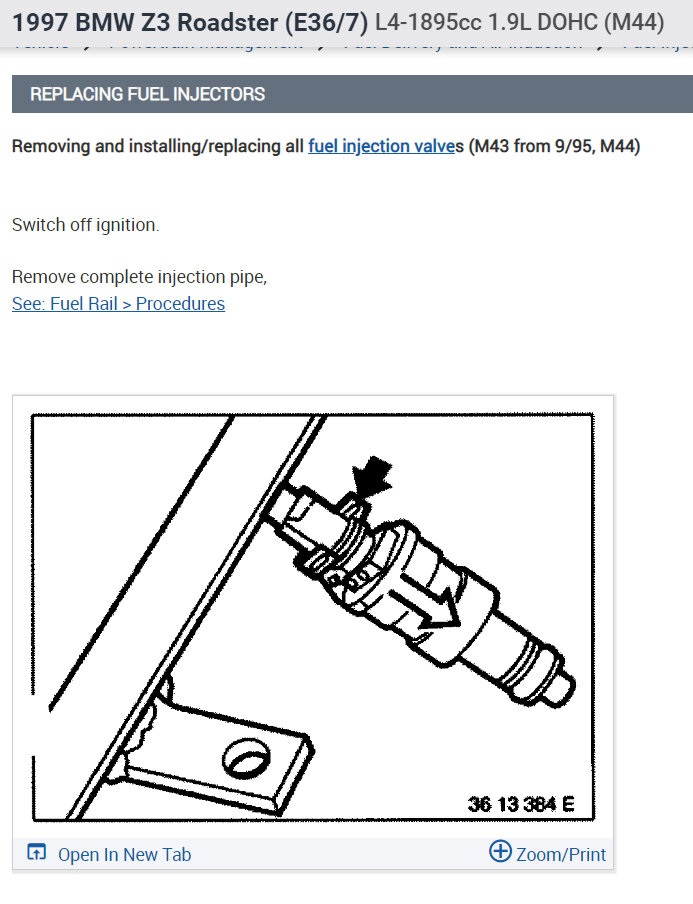

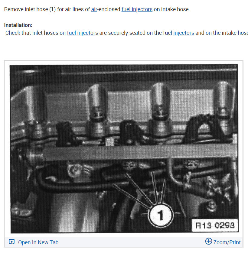

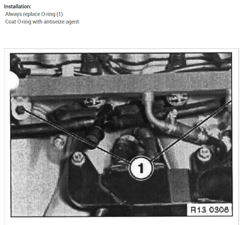

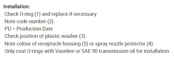

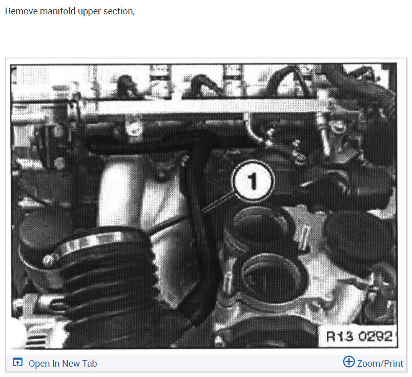

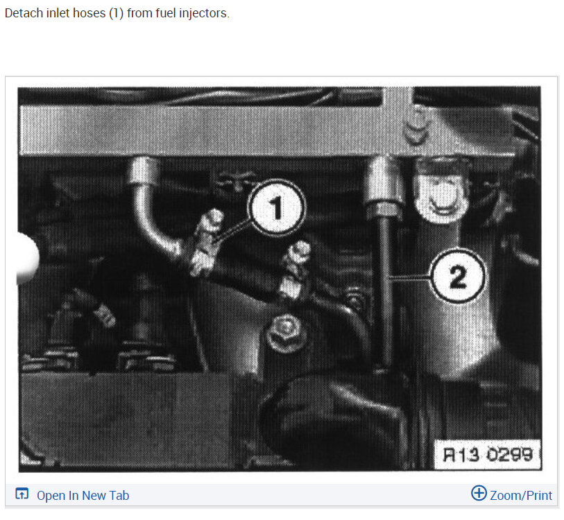

What were the readings please? Also, can you please upload a short video of the engine idling so I can see it? It sounds like the fuel injectors may need replacement, here is a guide to help you test them to confirm the failure.
https://www.2carpros.com/articles/how-to-test-a-fuel-injector
Does the engine make any unusual noises at idle? Check out the images (below). Please let us know what happens.
