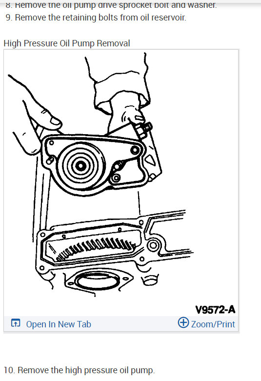

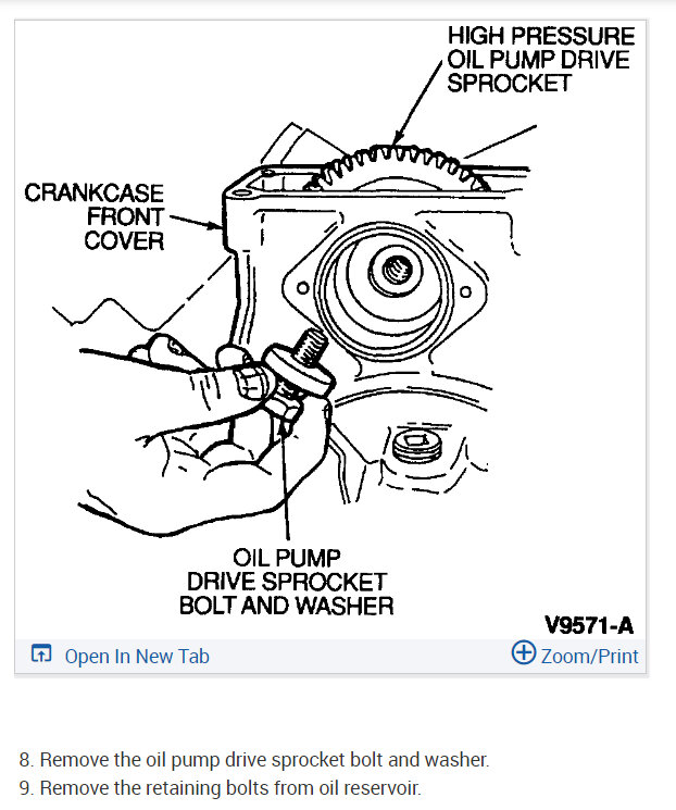

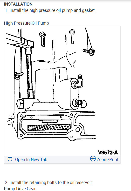

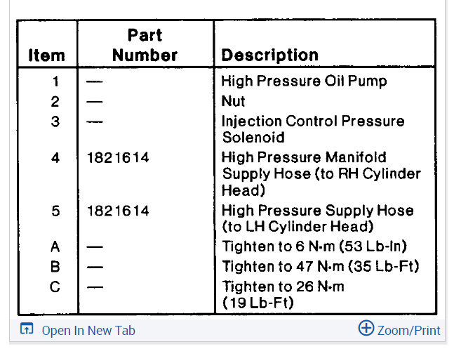

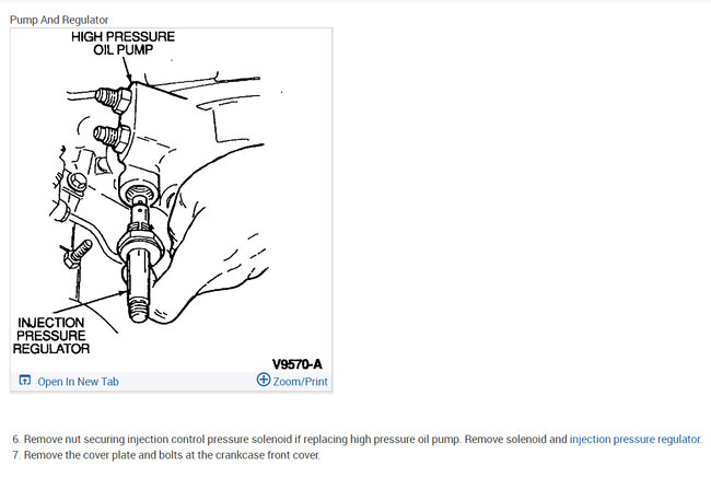

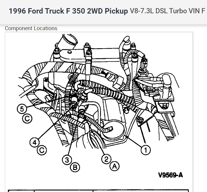

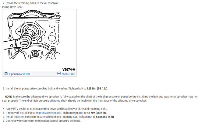

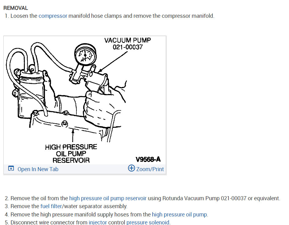

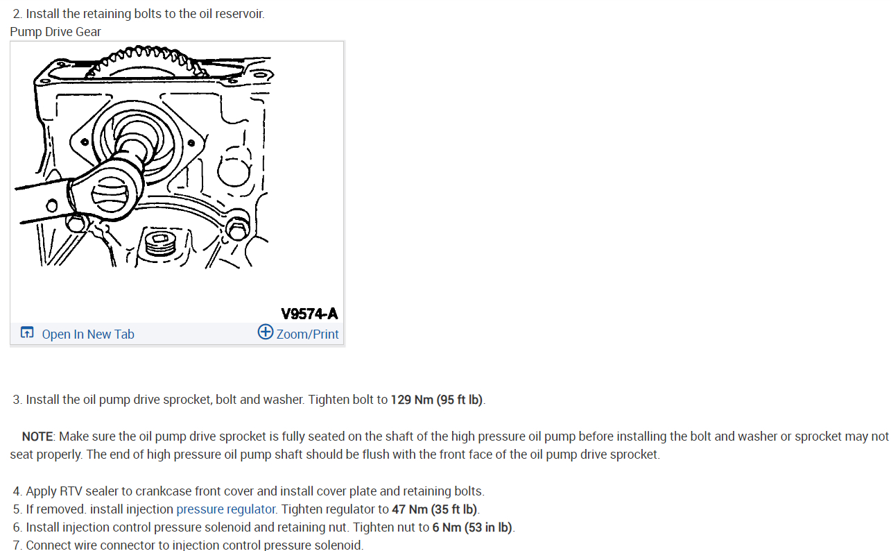

Changes ae the high-pressure oil pump has gone out, does the engine have the correct amount of oil in it? If so, then suspect the HPOP. Low oil level or insufficient oil pressure.
High-pressure oil pump issues.
P1284 - ICP (Injection Control Pressure) Circuit Low
P1211 - ICP (Injection Control Pressure) Not Controllable / Pressure Above or Below Desired
Here is how to change the HPOP out which should fix the problem. Check out the images (below). Please let us know what happens.
