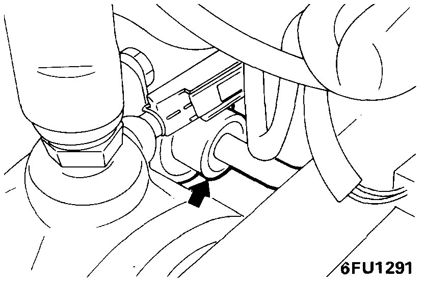

3. Disconnect the fuel high pressure hose at the fuel rail side
CAUTION: Cover the hose connection with shop towel to prevent splashing of fuel that could be caused by residual pressure in the fuel pipe line.

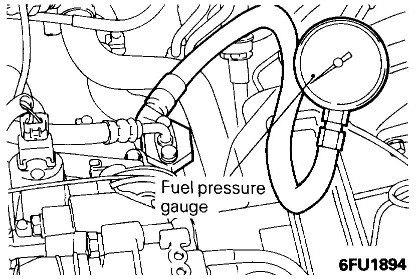

4. Place the MlT215144 adapter on the end of the fuel rail, then attach the fuel high pressure hose to the adapter using the bolts supplied with the MlT21O196 fuel pressure test assembly.
Picture 2
5. Attach one end of the fuel hose supplied with the MlT21O196 to the quick-disconnect fitting on the M lT21 51 44 adapter. Attach the other end of the hose to the fuel pressure gauge.

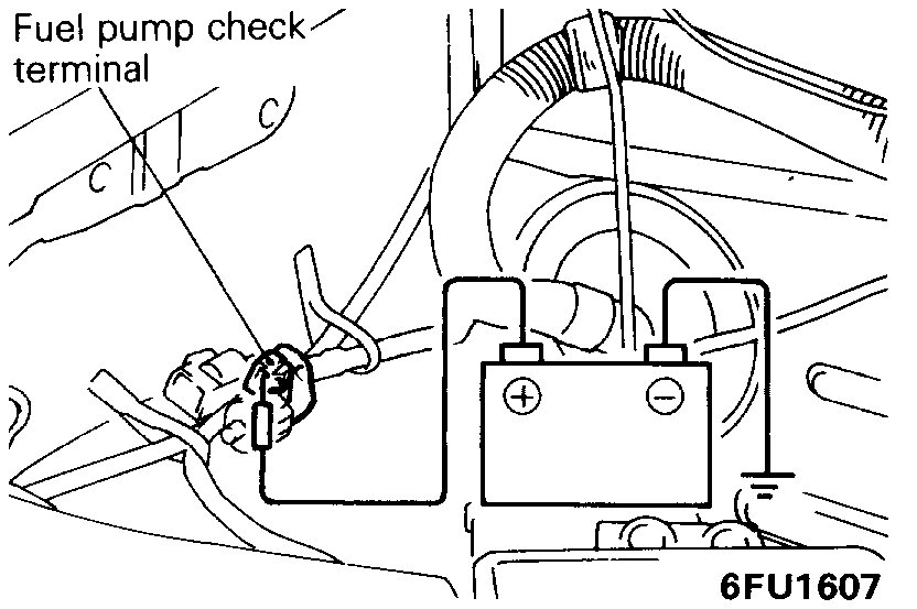

7. Connect a jumper wire to the terminal for activation of the fuel pump and to the positive (+) terminal of the battery to activate the fuel pump. With fuel pressure applied, check to be sure that there is no fuel leakage from the fuel pressure gauge and the special tool connection part.
8. Disconnect the jumper wire (from the terminal for activation of the fuel pump) to stop the fuel pump.
9. Start the engine and let it idle.
10. Measure the fuel pressure during idling.
Standard value: Approximately 270 kPa (38 psi) at curb idle
Picture 4

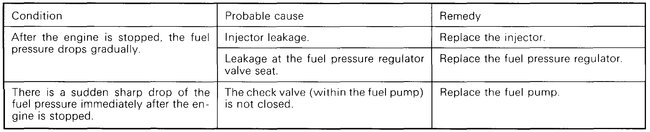

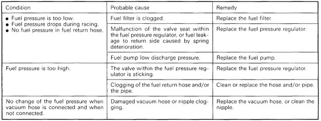

14. If the fuel pressure measured in steps (9) to (12) deviates from the standard value range, check for the probable cause by referring to the table below, and then make the appropriate repair.
15. Stop the engine and check for a change of the value indicated by the fuel pressure gauge. The condition is normal if there is no decrease of the indicated value within two minutes.
NOTE: If there is a decrease of the indicated value, monitor the speed of the decrease, and, referring to the table below, determine the cause of the problem and make the appropriate repair.

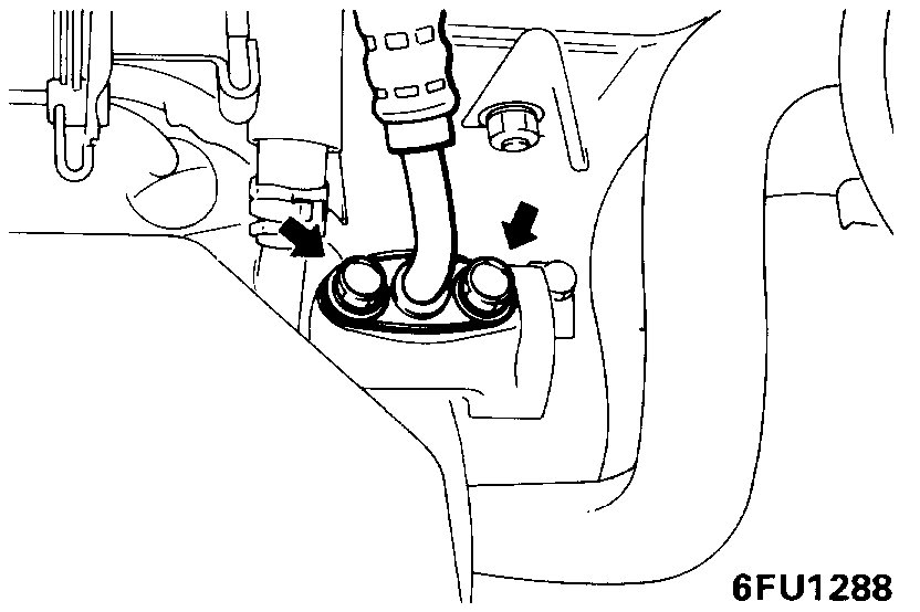

17. Disconnect the fuel pressure gauge and the special tool from the fuel rail.
CAUTION: Because there will be a slight amount of remaining pressure in the fuel pipe line, use rags to cover so that fuel doesn't splatter.
18. Replace the O-ring at the end of the fuel high-pressure hose with a new one.
19. After connecting the fuel high-pressure hose to the fuel rail, tighten the installation bolt at the specified torque.
