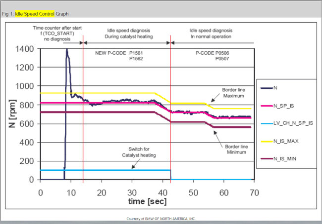

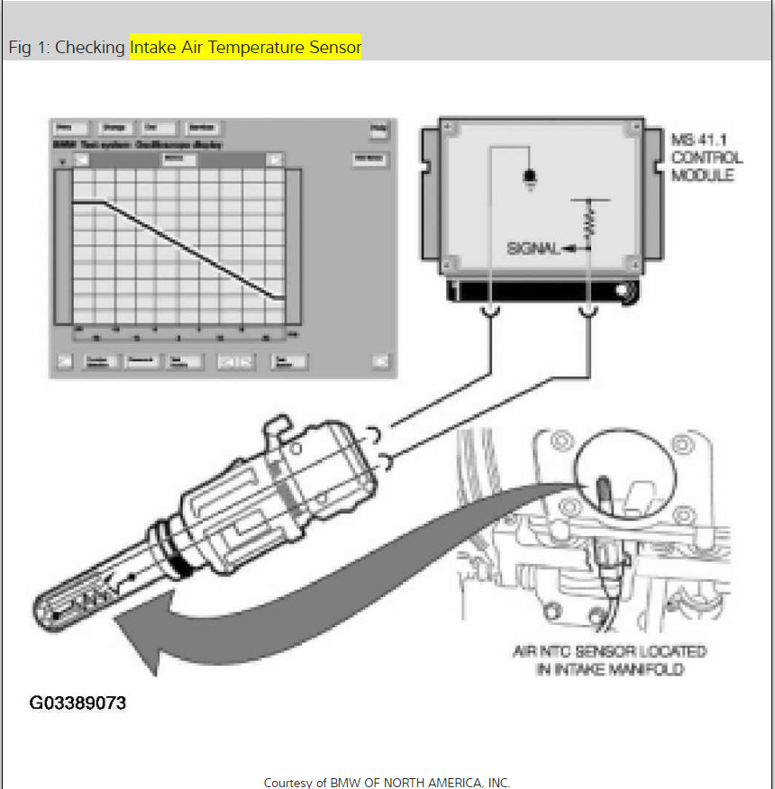

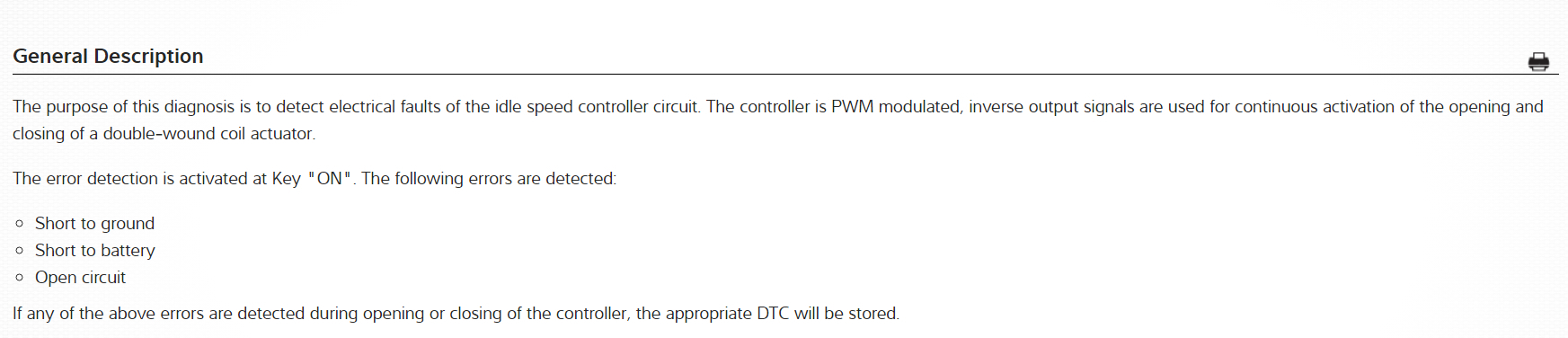

Through scanner intake air temperature was showing 78 degrees. Ambient temperature 55 degrees. Is this a problem and if so where is sensor located? 3.0si
Feb 22, 2019 at 8:00 PM
SCGRANTURISMO
  • 4,897 POSTS

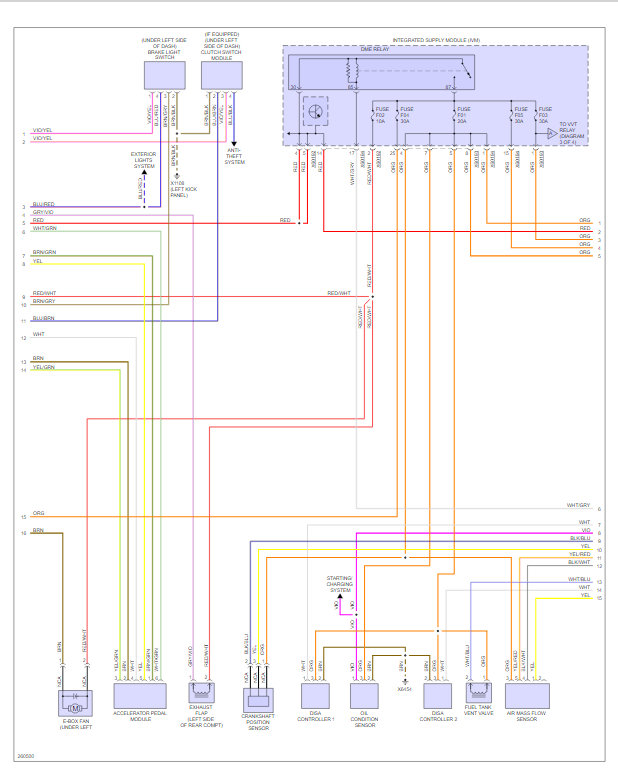

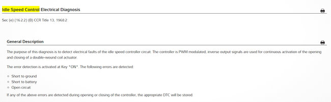

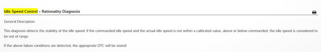

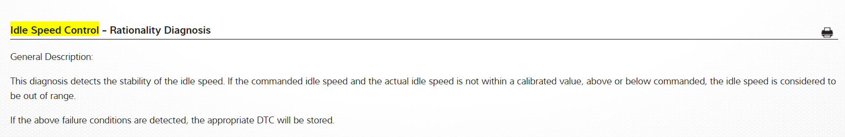

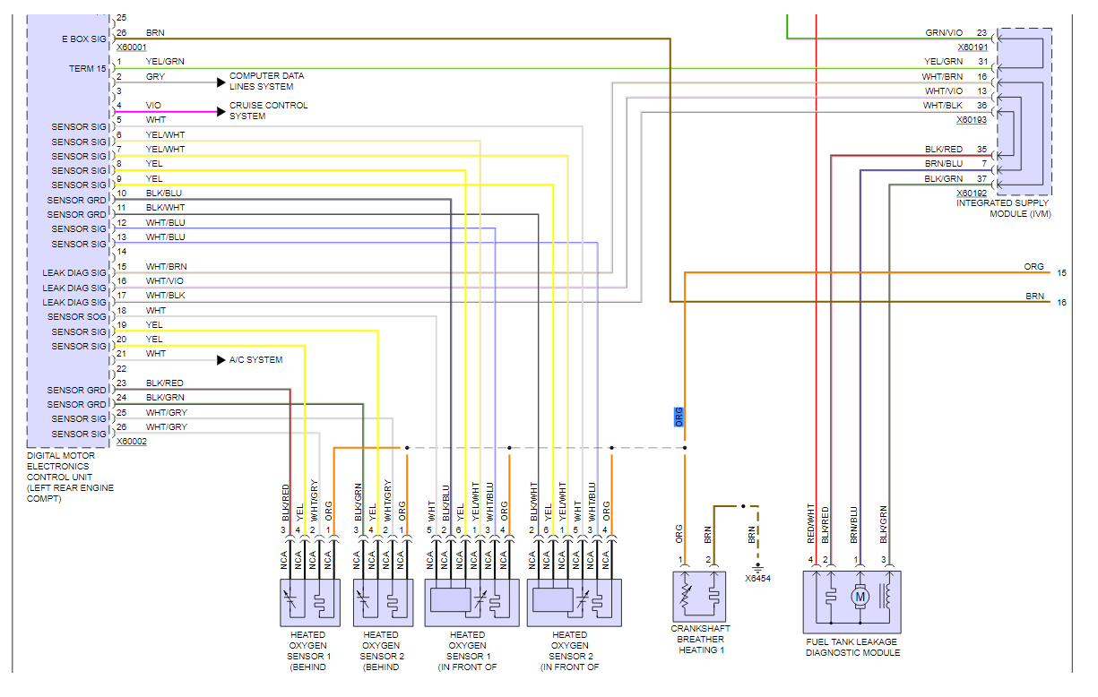

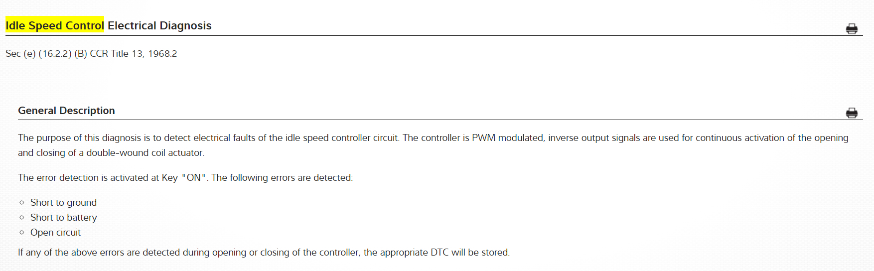

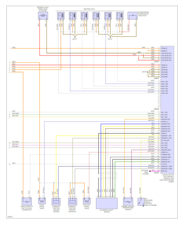

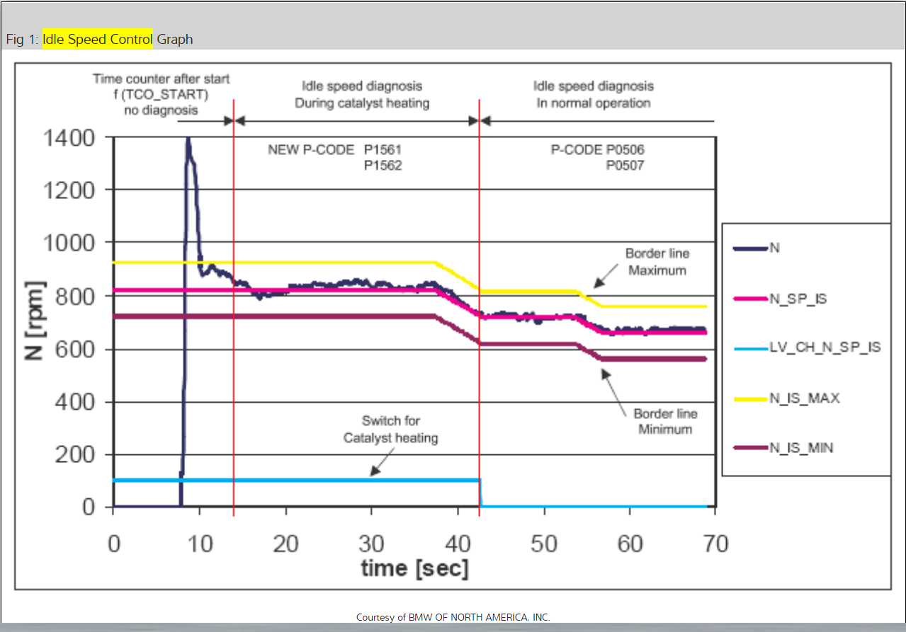

I don't think that would effect your idle that much. I have included the Intake Air Temperature (IAT) sensor location in the diagrams down below as well as a troubleshooting guide from the manufacturer for your vehicles rough idle. Please go through this guide and get to us with you find out.
Thanks,
Alex
