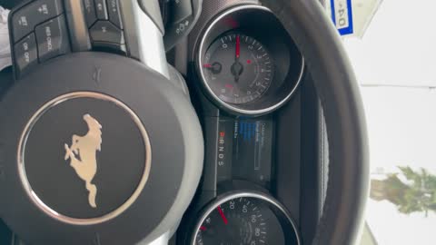

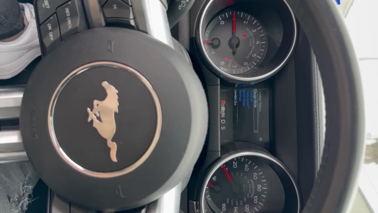

When at a red light or at a stop my car will begin to shake and it has turned off a few times. I’ve already changed spark plugs and ignition coils, and cleaned throttle body. The rpm idle of the car seems relatively low. In the video I rev the engine to nearly 4,000 RPMs and the air to fuel / ratio will fluctuate and the car begins to shake moments after that. There hasn’t been a check engine light but a few days ago after putting gas I got a “check fuel inlet “ message on my dash.

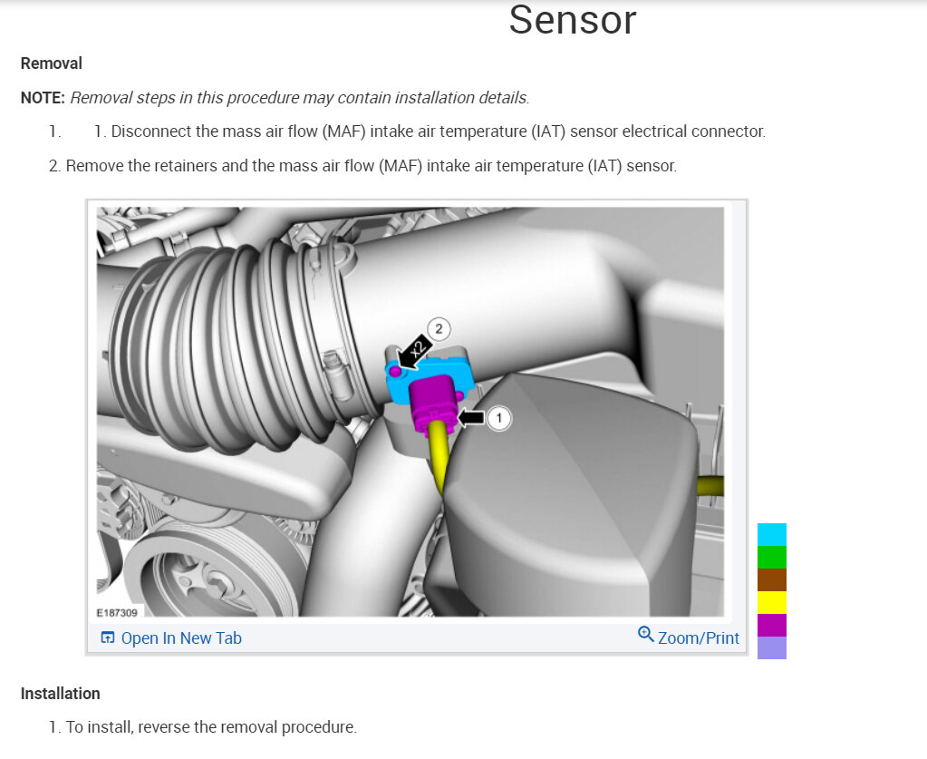

It sounds like you may have a vacuum leak, I would check the engine when it is cold only, by following this guide:
Also, you could have an MAF sensor that is going out as well. I would remove the sensor and try to clean it.
This guide can help as well:
https://www.2carpros.com/articles/mass-air-flow-service
The sensor location is in the images below.
Check out the images (below). Please let us know what happens. Also, when you replaced the spark plug did you use OEM?
