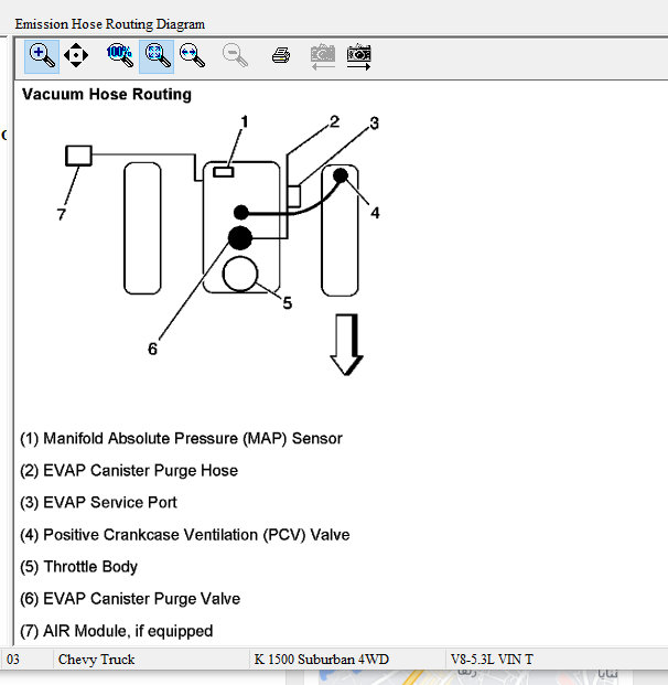

Hello friends, I have the vehicle listed above LT 5.3 vortec and it is idling rough. The engine codes are a random misfire, an emissions code saying it’s running lean, and a occasionally a knock sensor circuit to low code. I have put a ton of parts in it; all new coils, wires and plugs, new maf sensor, new knock sensor and harness, new camshaft position sensor, new oil switch, new intake manifold with new intake gaskets, all new O2 sensors, new evap canister, new purge solenoid, oh and I have a new K&N cold air intake. With all that I’ve put into it, it’s still idling rough but never stalls, it sputters when I accelerate but when I get up to speed it runs perfect. I am going to look into my fuel system. Does anyone have any info that would help me? Anything please? Lol I’ve put so much money into this thing!

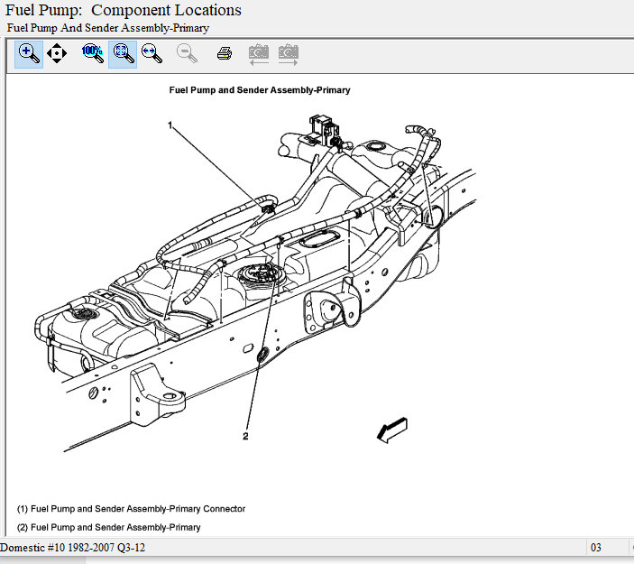

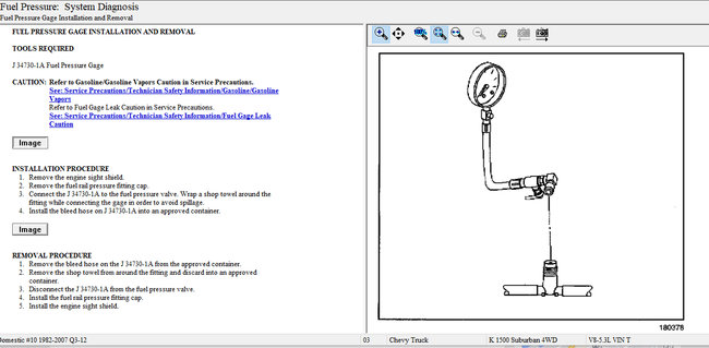

It sounds like you have vacuum leak or low fuel pump pressure.
check our link below how to check vacuum leak.

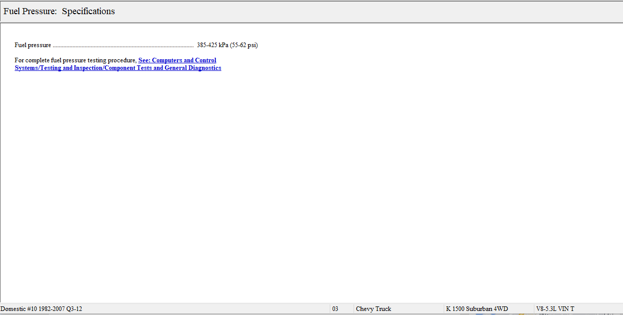

Check our link how to check fuel pressure you must read 55 to 62 PSI.
Check the figures below, specific to your vehicle, fuel pressure, procedure how to install fuel pressure gauge and vacuum diagram.
Hope these helps. let us know if you need more help.

Thank you for the help! I just checked under my hood to see if I even had a pc valve and my suburban doesn’t. So tomorrow I’m going to get it in the shop and check for a vacuum leak to see if it is the hose. And then I’ll do a fuel pressure test also.

Hey guys, sorry for the delay. I am a first year student in auto-mechanics. So I have done a fuel pressure test in my vehicle and it checked at 67 PSI, I also did a vacuum test with brake fluid and couldn’t find anything and the vacuum pressure gauge read at 16 PSI, but also I have figured out that the mass air flow sensor and MAP sensors are different, I have actually not put a new MAP sensor is only a new mass air flow sensor so that’s what I have come to. I will get back to you when I get the new MAP sensor in!
