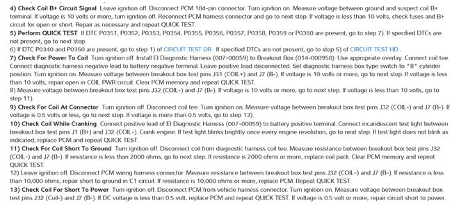

rough engine rocking at idle
1997 LINCOLN MARK VIII
127,000 MILES • 4.6L • V8 • RWD • AUTOMATIC
REDHOTCROME9
I changed all spark plugs and all eight coils and EGR solenoid and EGR valve and gasket and PCV valve and my engine light keeps coming on and the code is po351 the secondary ignition I check the gap on all spark plugs and all are good
can you help

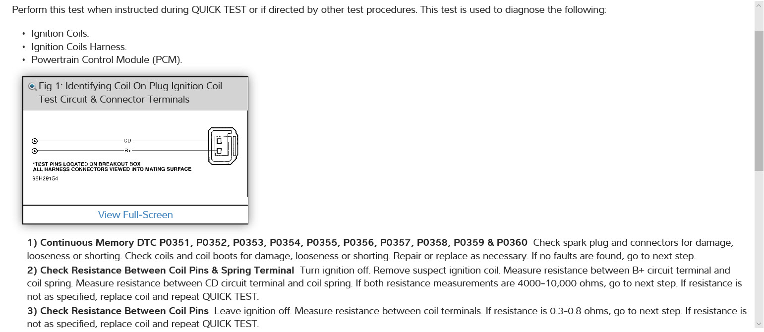

do checks in picture it can be harness bad, PCM connection etc.
