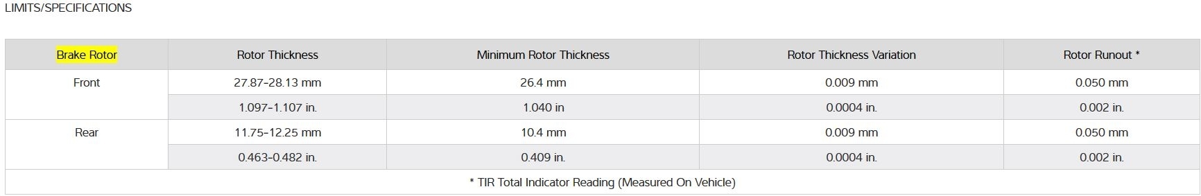

Are these numbers good 0.512 in and 0.478? Where I should I not have to change the rotors?

According to the manufacturer specifications the minimum rotor thickness for the front brake rotors is 1.040" and for the rear it is .409" See the chart attached.
Generally you replace rotors for two reasons. One is that they are worn out below the minimum thickness. Two is if they are warped and cause your brake pedal to pulsate meaning that they are warped (they have "runout"). If both thickness and runout are good, then there is no need to replace them.
