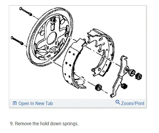

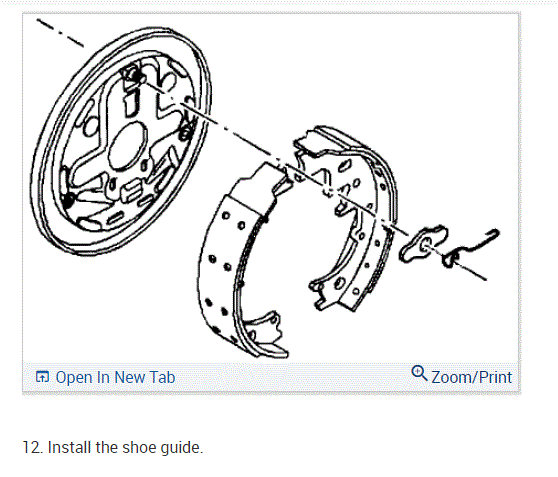

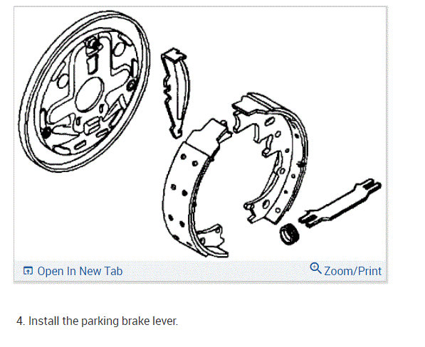

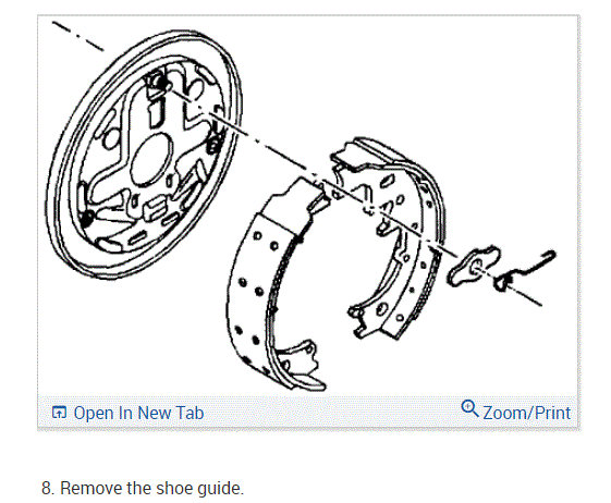

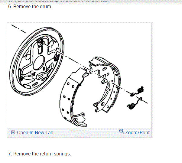

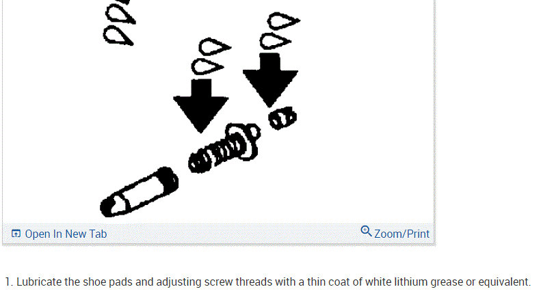

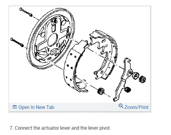

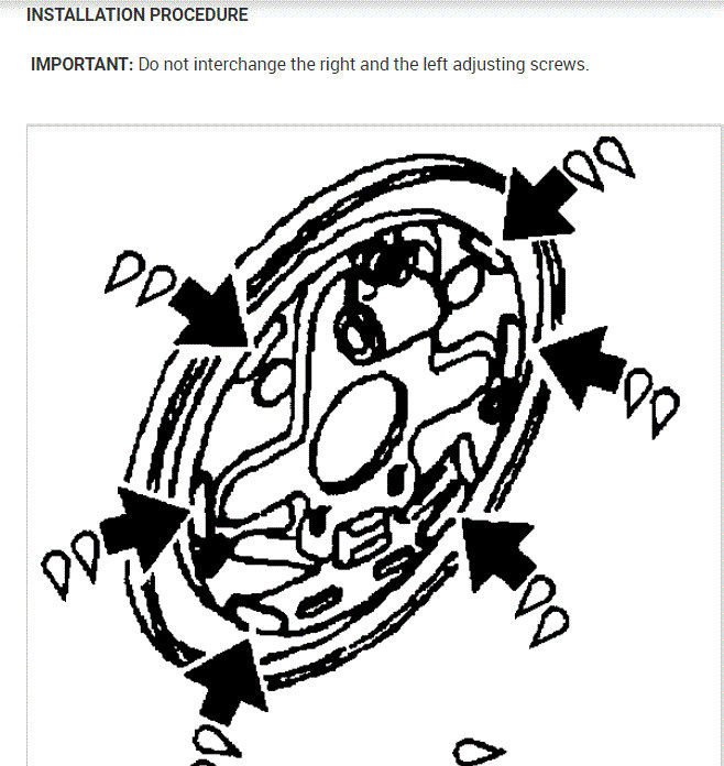

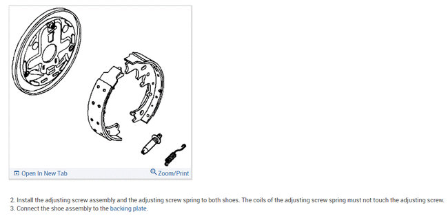

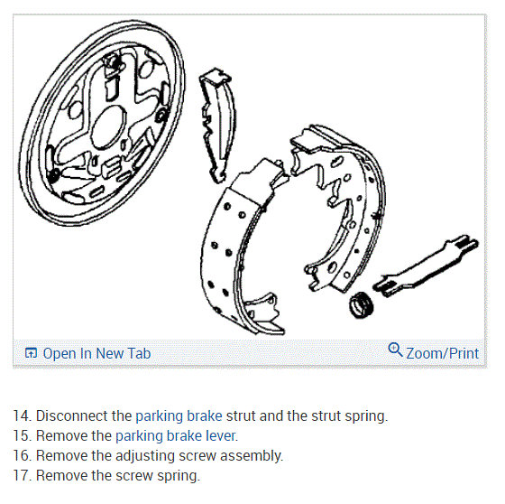

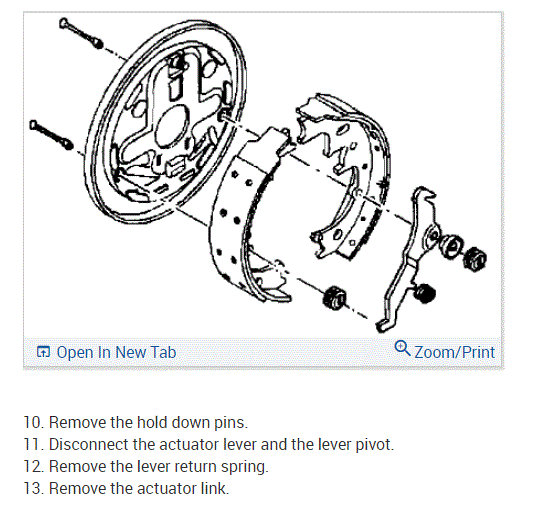

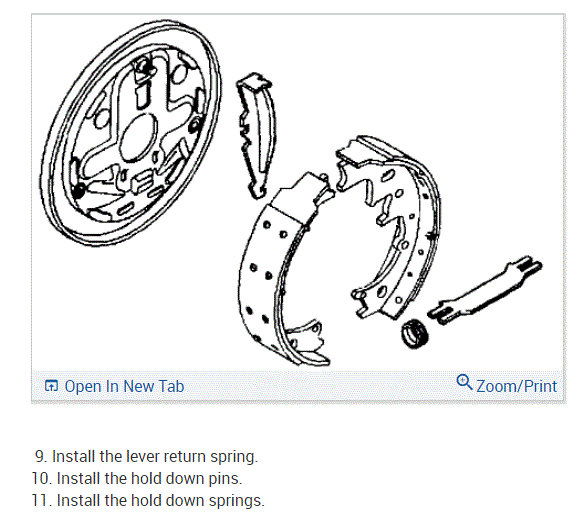

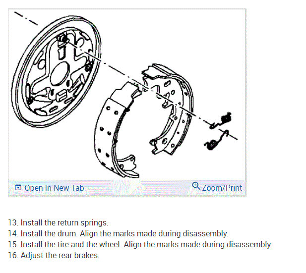

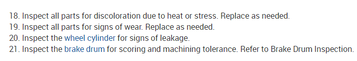

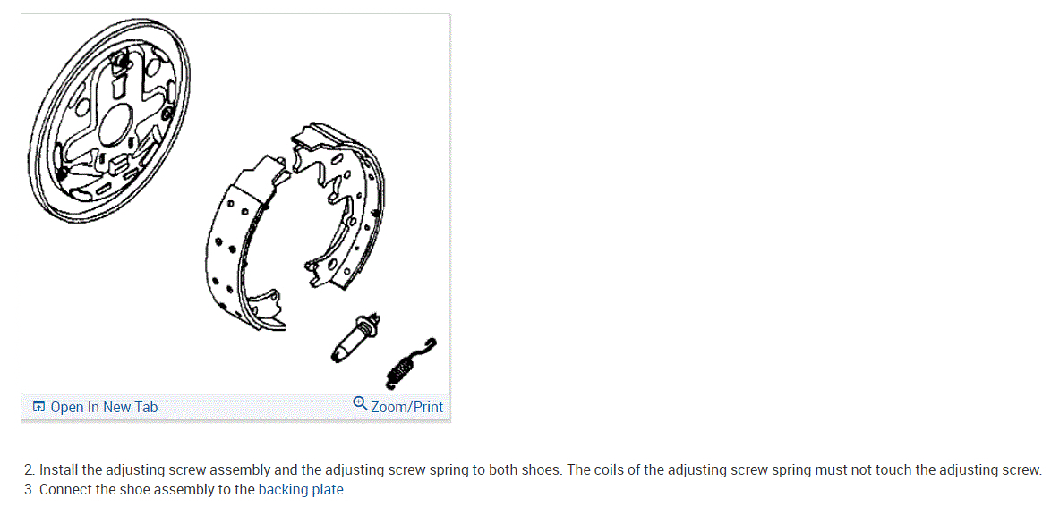

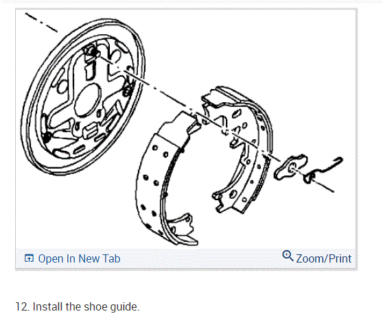

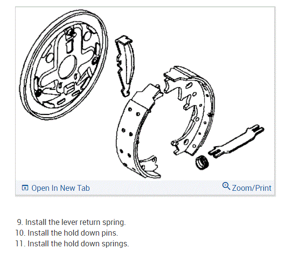

I believe this vehicle has rear drum brakes. I checked the manual and it indicates they are drum-type brakes.
Confirm that for me. If I am correct, here is a link to get you started. It shows in general how it's done. You can use it as a guide.
https://www.2carpros.com/articles/how-to-replace-rear-brake-shoes-and-drums

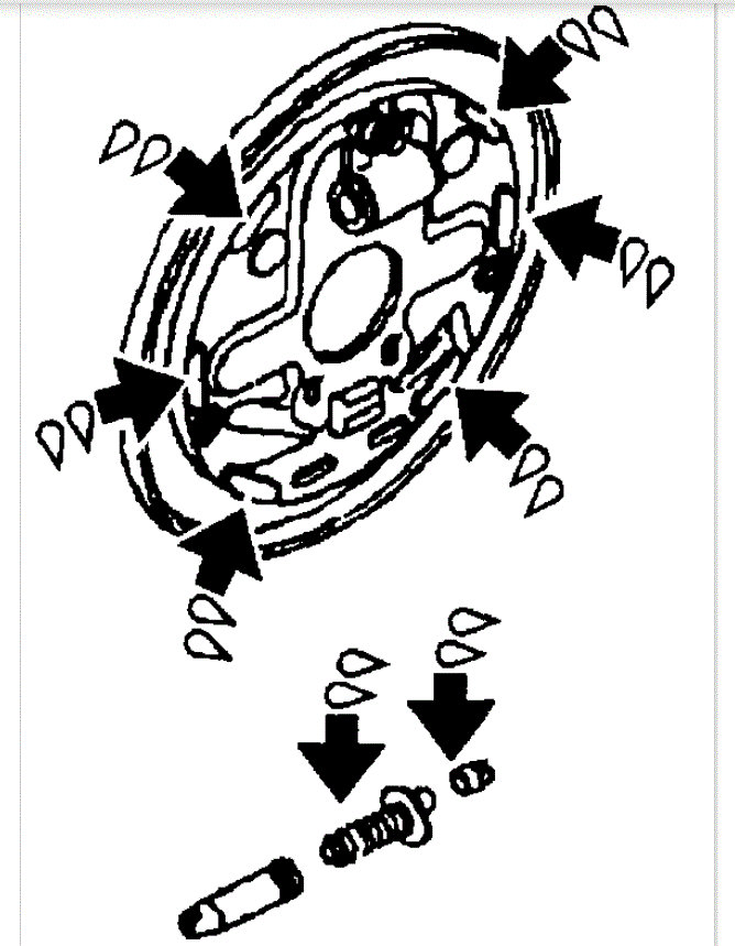

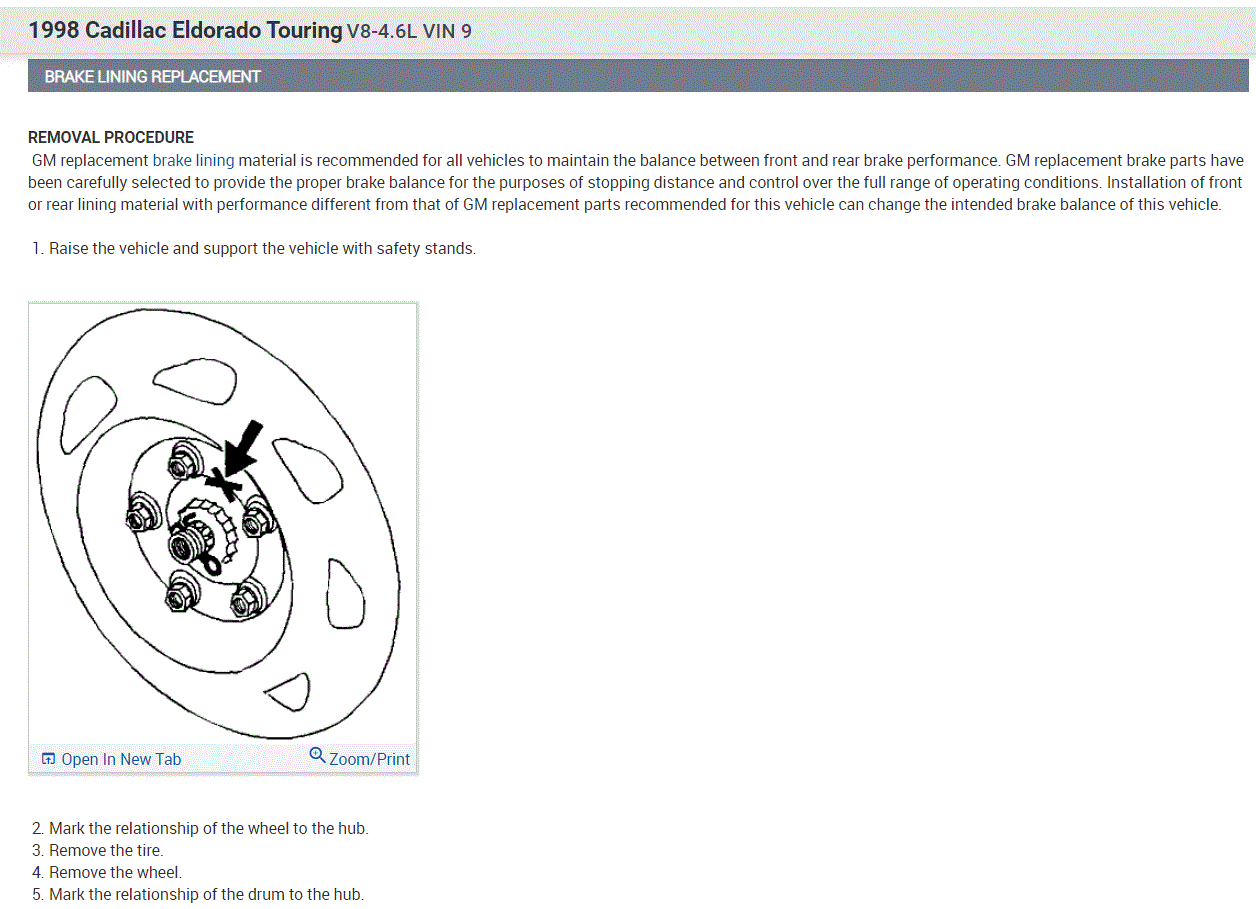

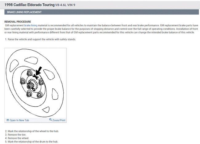

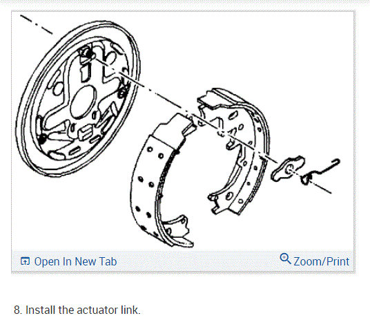

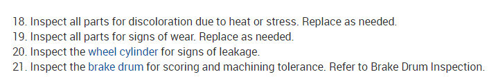

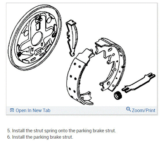

If you look at the pics below, they are the directions specific to your vehicle for brake drum and shoe replacement.
I hope this helps. Let me know if you have questions.
