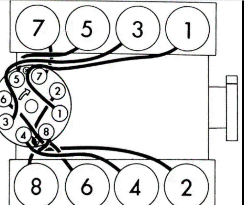

Engine is a 350. Two things I noticed that my rotator in my distributor is not turning when we crank the motor. I pulled the distributor and the shaft and gear are in good shape? What my next step timing chain? Also what the best reference to find the firing order so I can put my spark plugs back?

There is a shear pin that holds the gear at the bottom of the distributor. Make sure it is good and the gear and shaft are tightly connected. Next, with the distributor out, look down to the top of the oil pump and make sure it is in a position to receive the distributor. If it isn't, take a long screwdriver and turn it to the correct position. Let me know what you find with that.
As far as firing order, it is 1-8-4-3-6-5-7-2. I attached a pic showing the plug wire orientation. Just remember, when you install the distributor, make sure the crankshaft is on TDC and the rotor is pointing to the number one spark plug wire.

See pic below.
