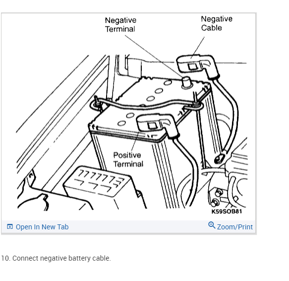

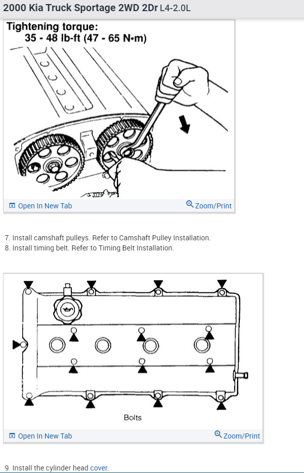

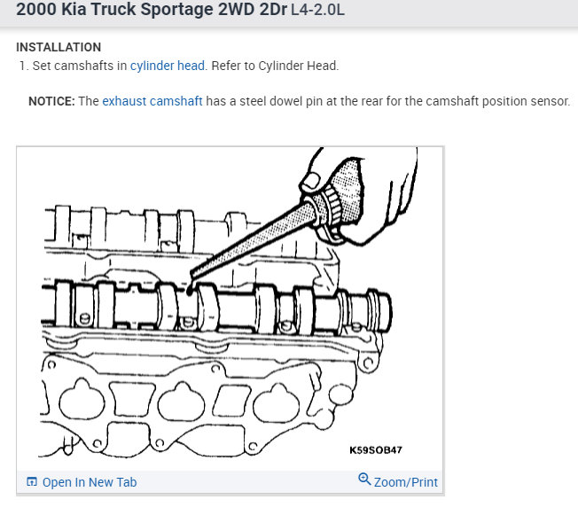

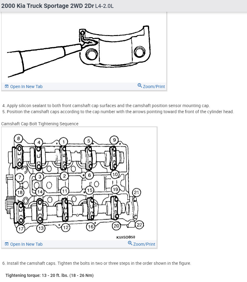

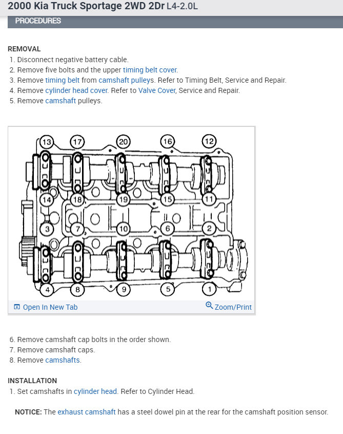

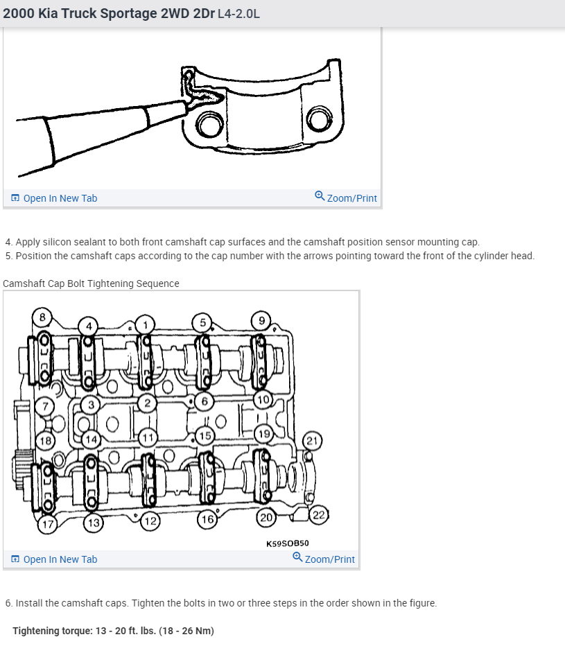

I have attached the replacement procedure for the cam below.
