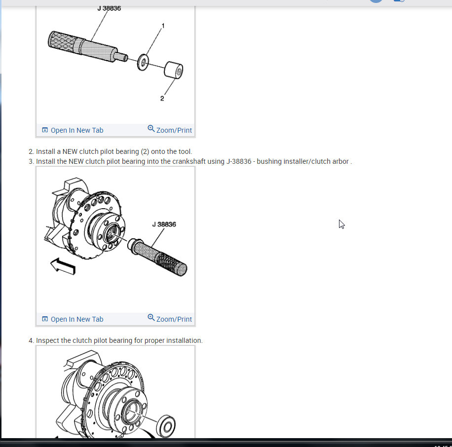

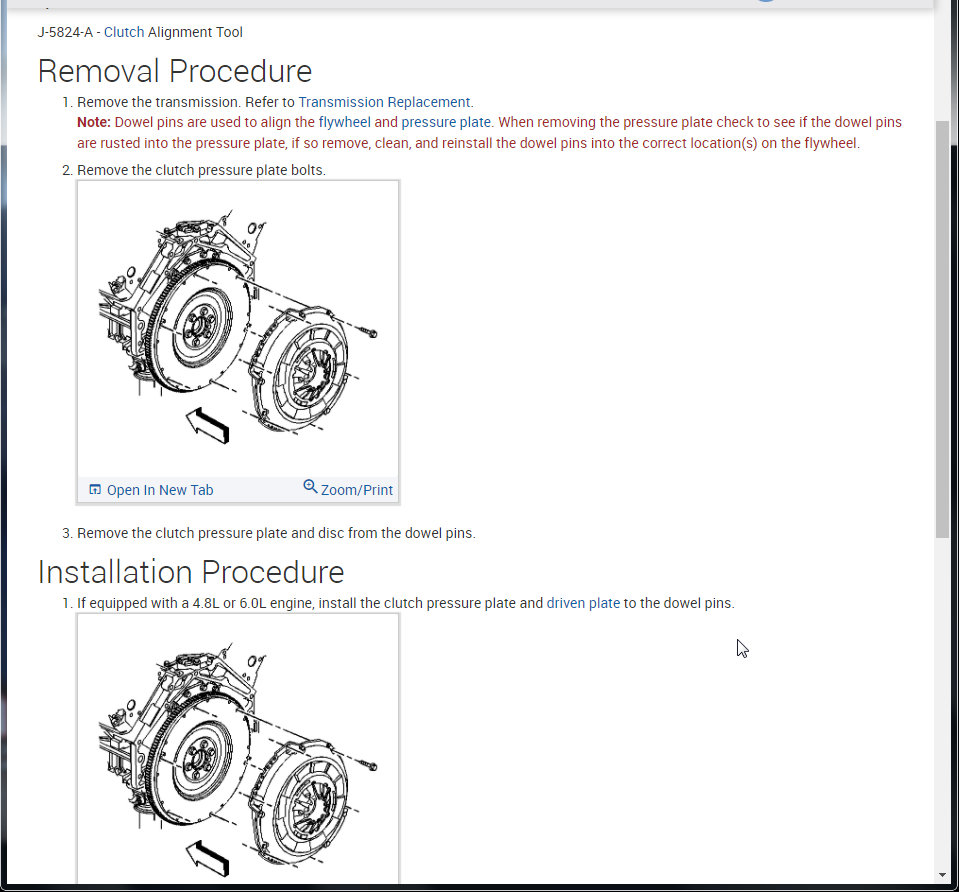

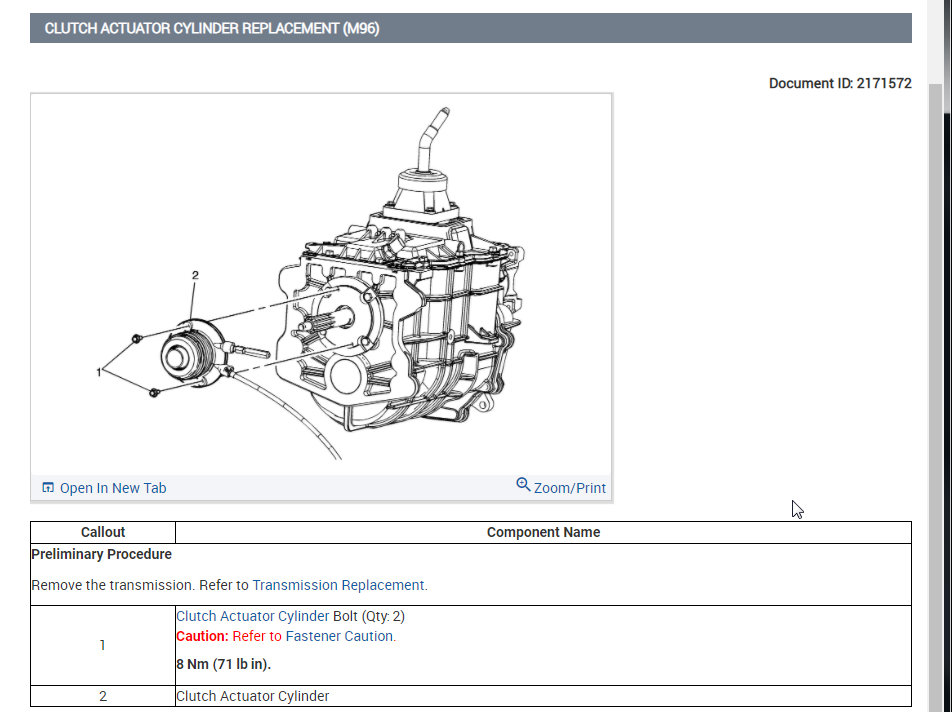

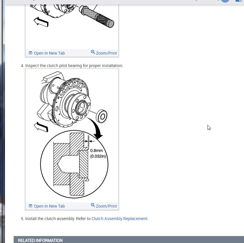

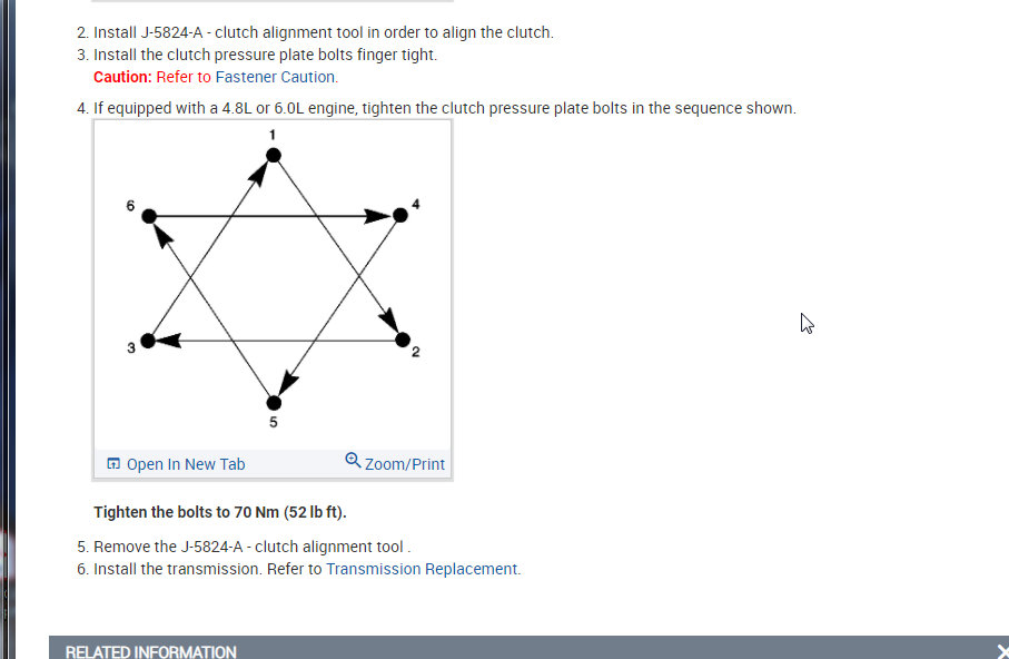

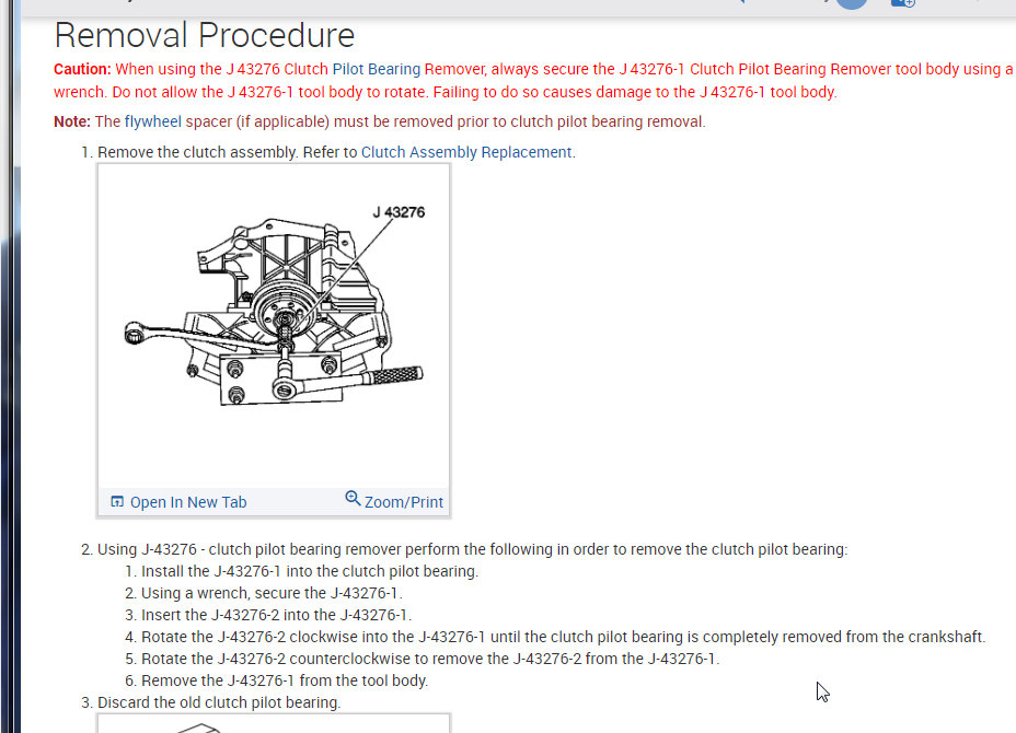

Here is a guide to help you step by step with instructions in the diagrams below to show you how on your car.
https://www.2carpros.com/articles/how-to-replace-a-clutch
https://www.2carpros.com/articles/throw-out-bearing-replacement
https://www.2carpros.com/articles/pilot-bearing-replacement
