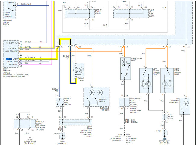

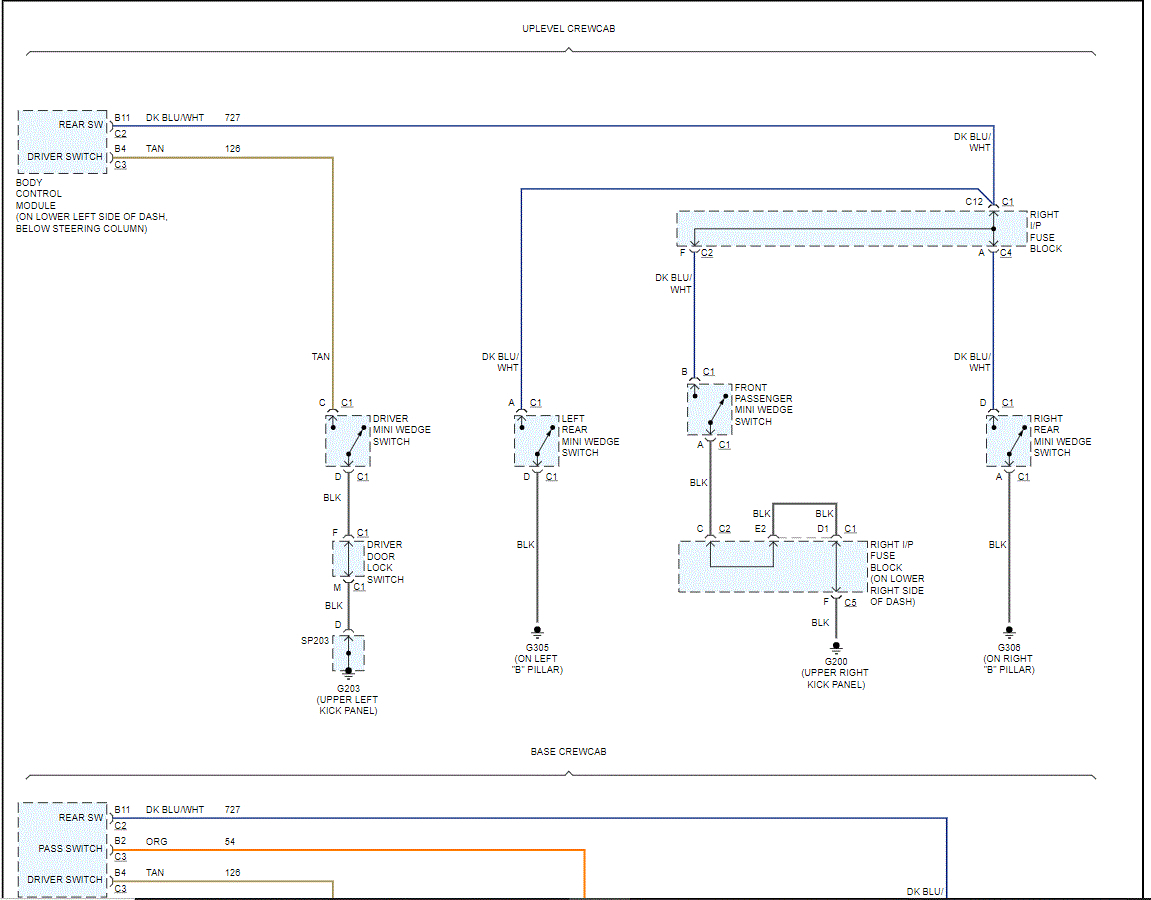

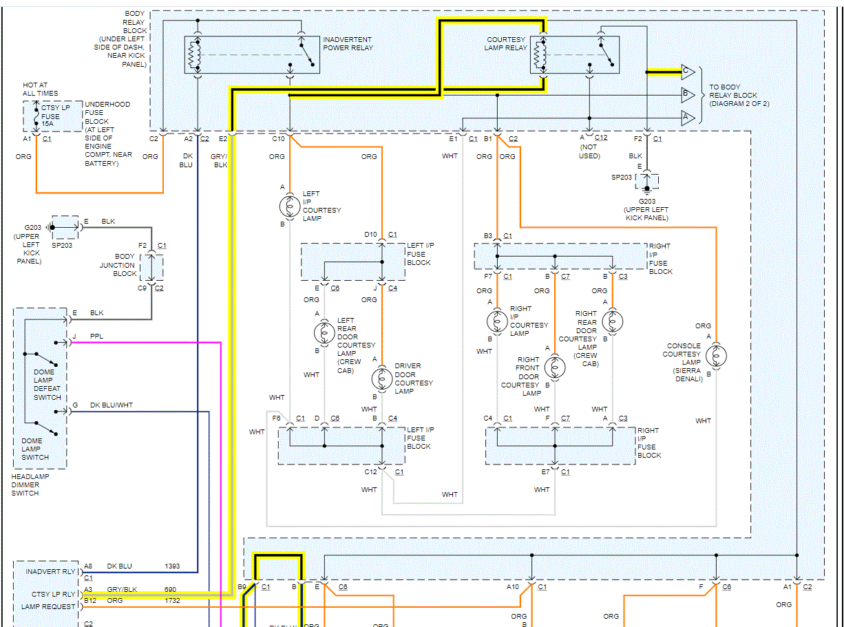

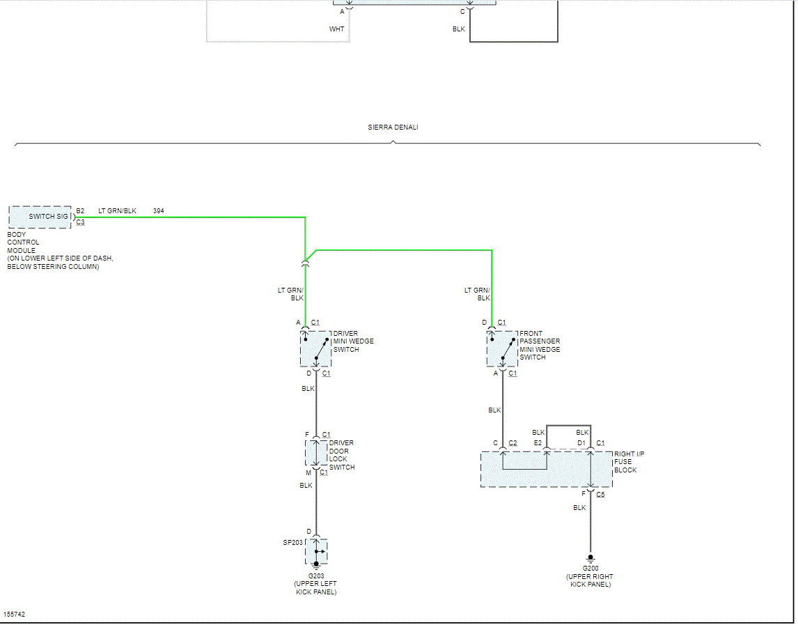

I would like to have the roof wiring diagram courtesy cargo lamp of the truck listed above crew cab lt and a Silverado 2002 crew cab lt.
Aug 13, 2021 at 1:07 AM
  • 110,236 POSTS

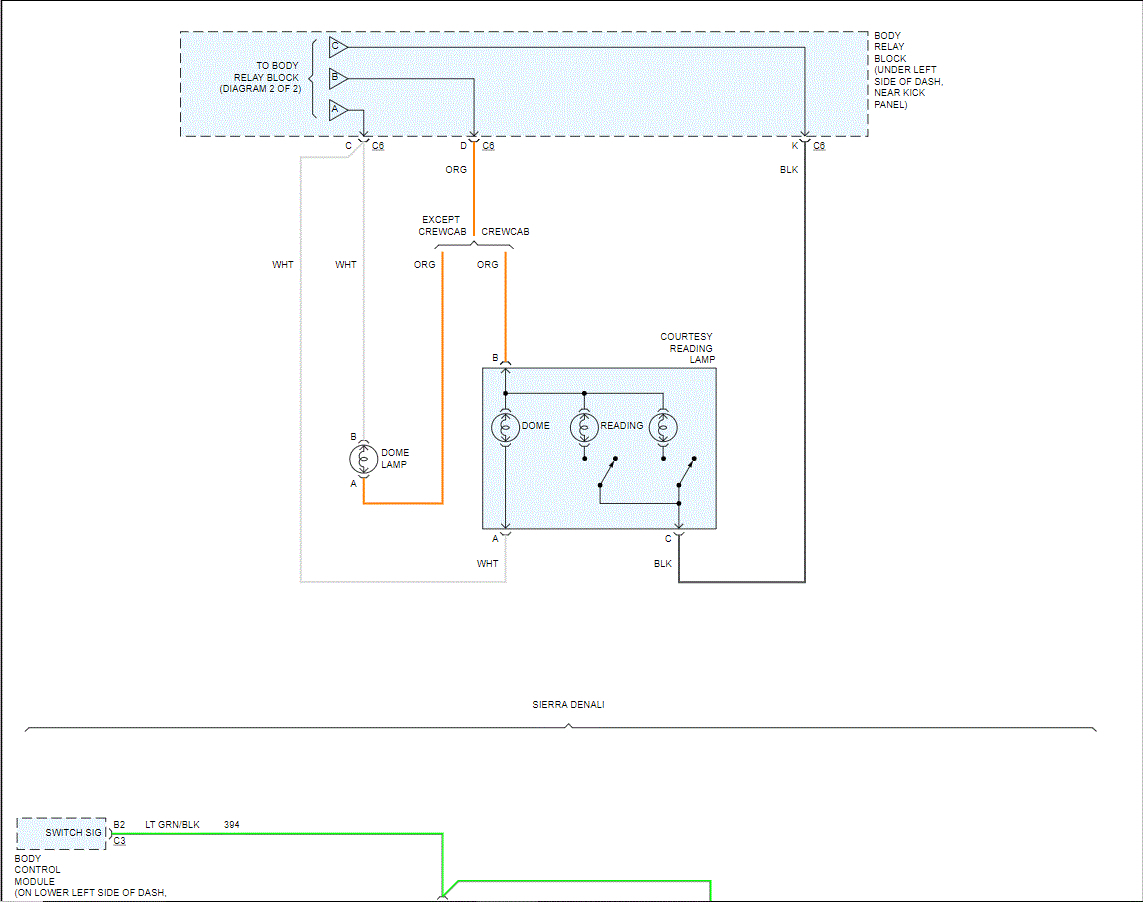

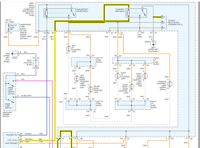

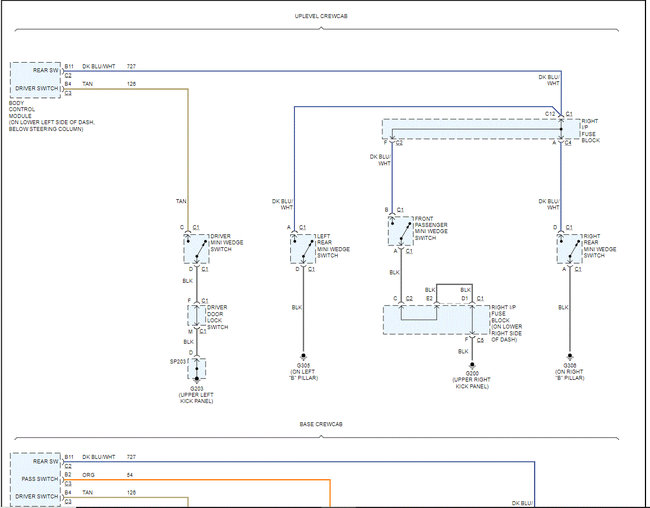

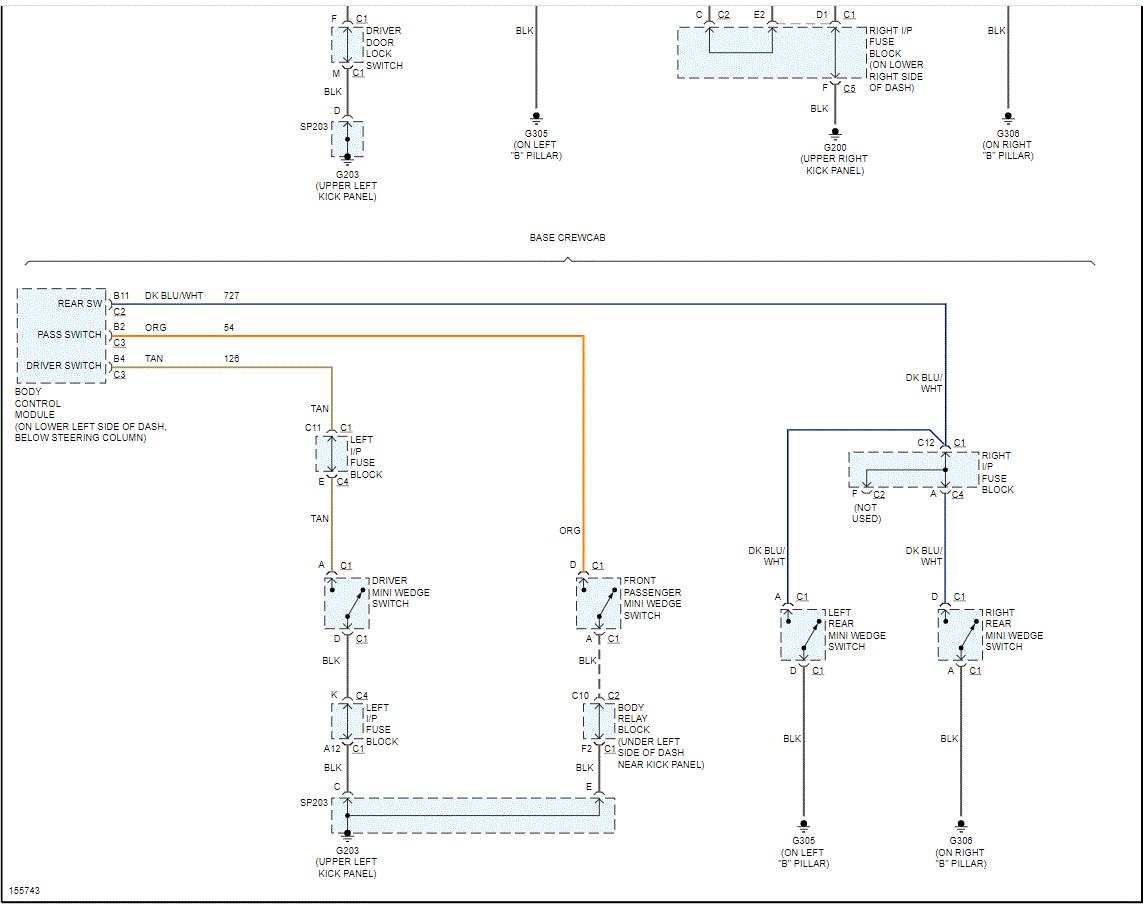

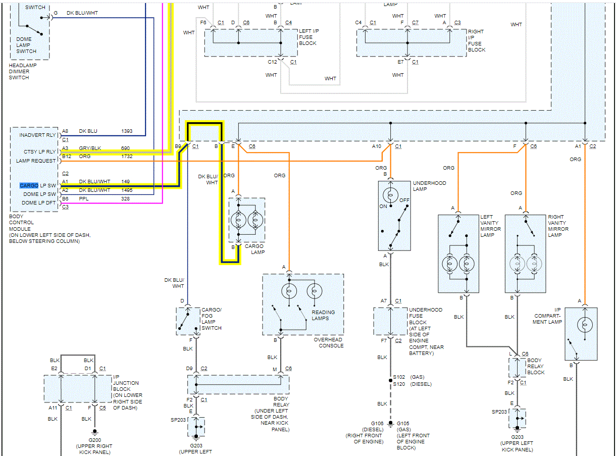

I believe you are looking for the courtesy cargo lamp wiring. However, the only way I have that is via the courtesy lamp schematics which includes the interior lighting.
If you look below, I attached everything for the interior lighting system, which includes the cargo lamp. Now, there were three pages of pictures, but I had to cut each one in half to make them readable, so that's why there are six pics below. I did overlap them so you can follow them.
I highlighted the wiring for the cargo lamp. I hope that helps. Also, here is a link that you may find helpful when testing/checking wiring:
I hope this helps. Let me know what you find or if you have other questions.
