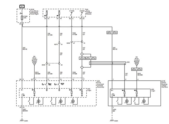

I'm looking for roof module wiring harness diagram. Can anyone recommend a website?

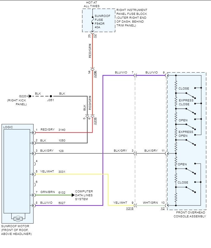

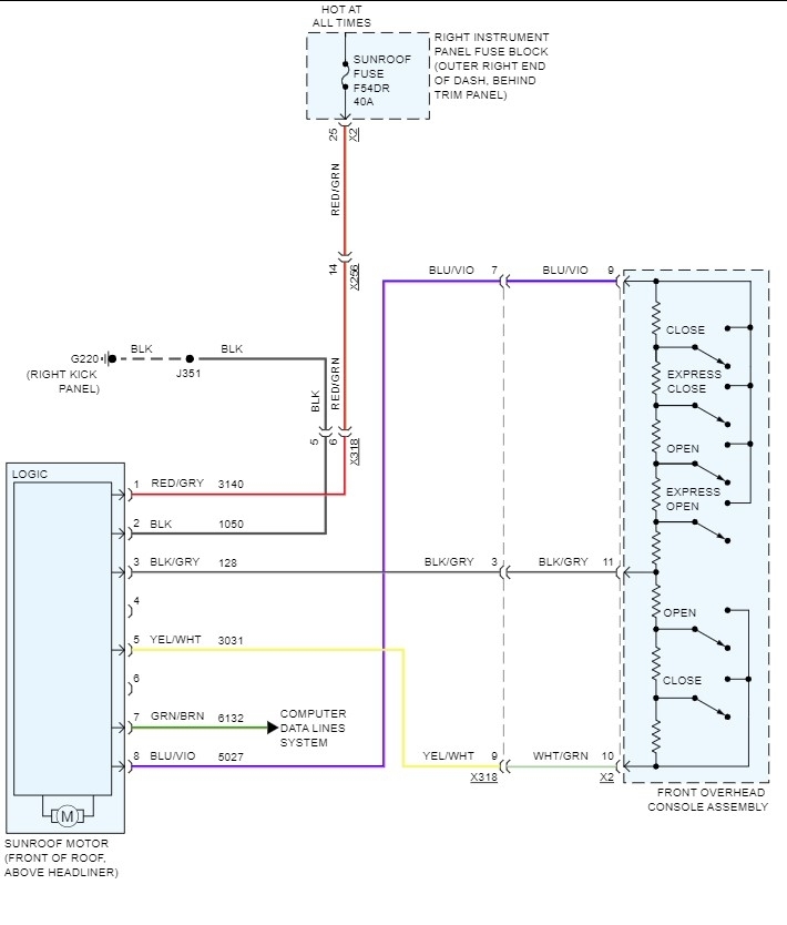

What is the issue you are having? The attached is the wiring for the sunroof, is that the module you are looking for or something else?

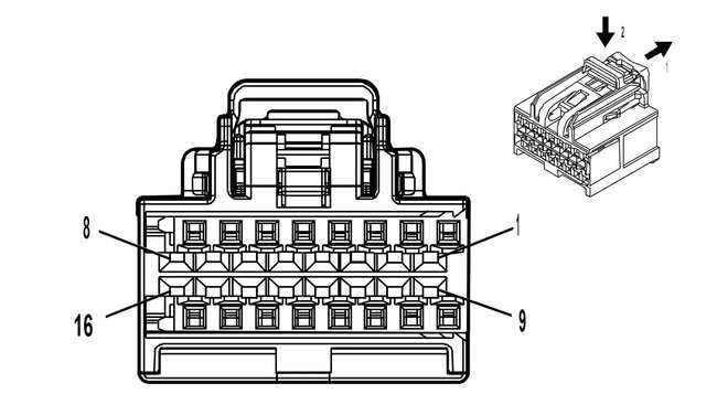

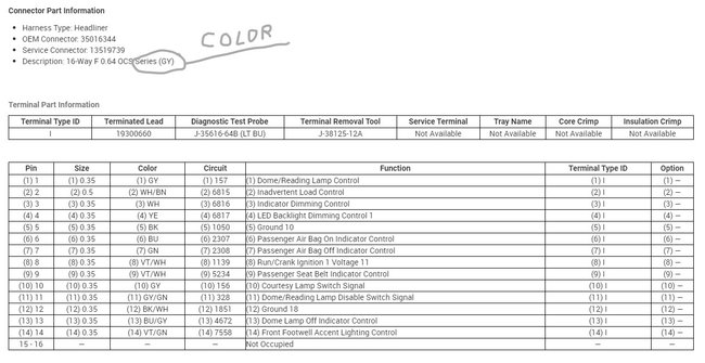

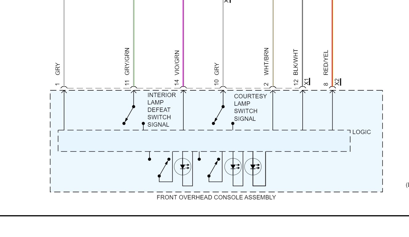

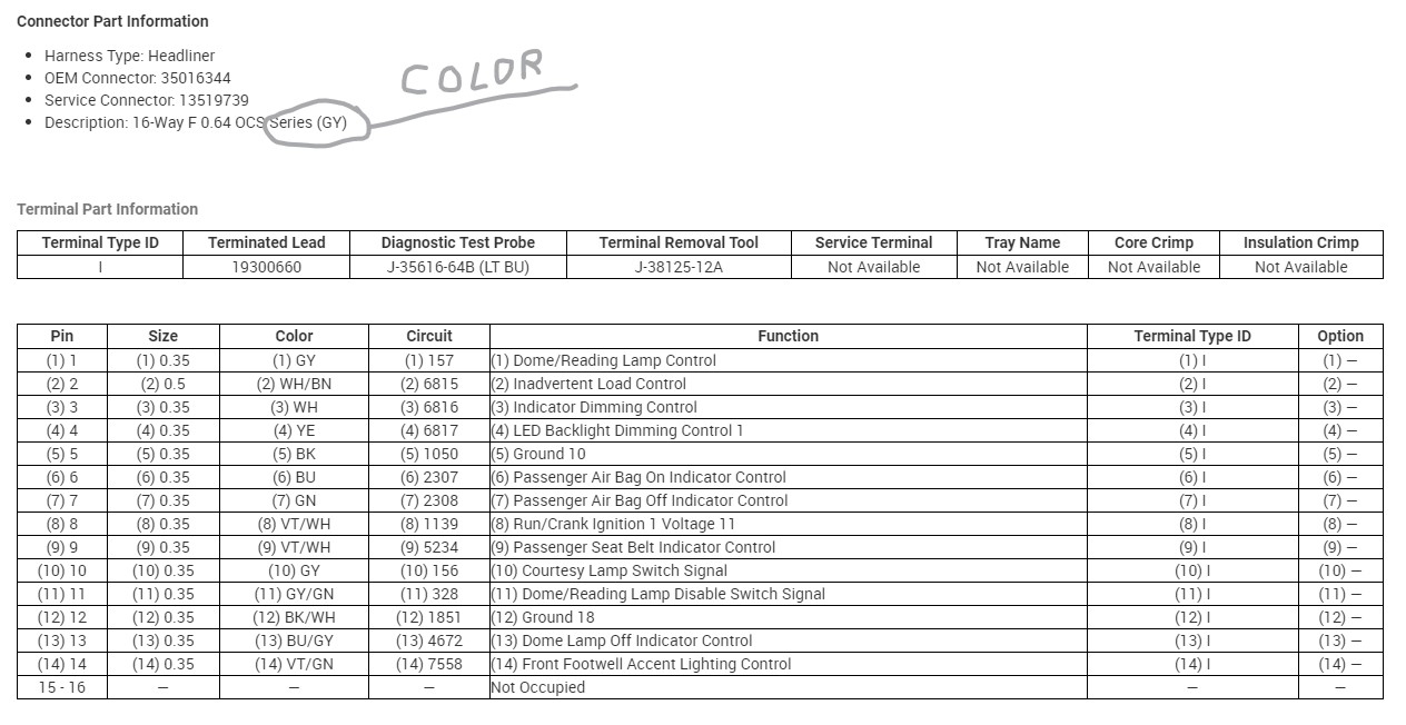

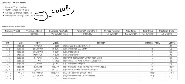

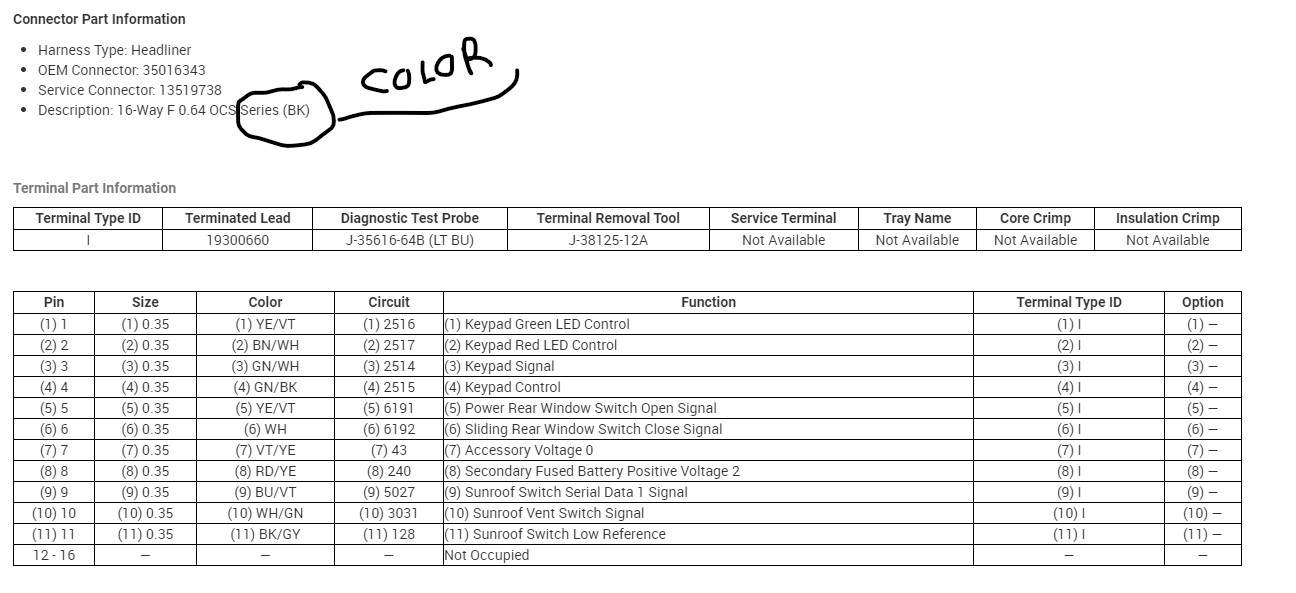

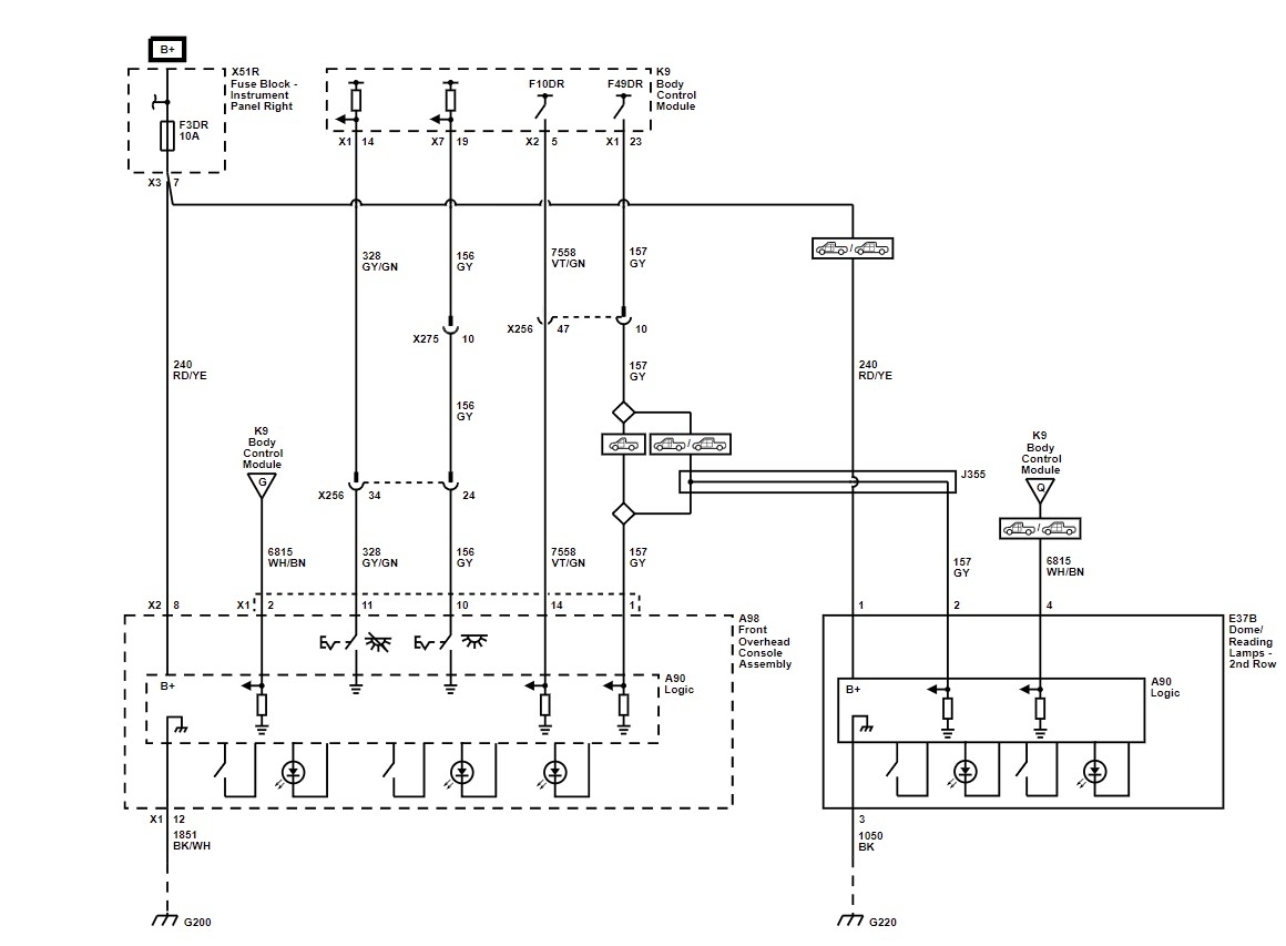

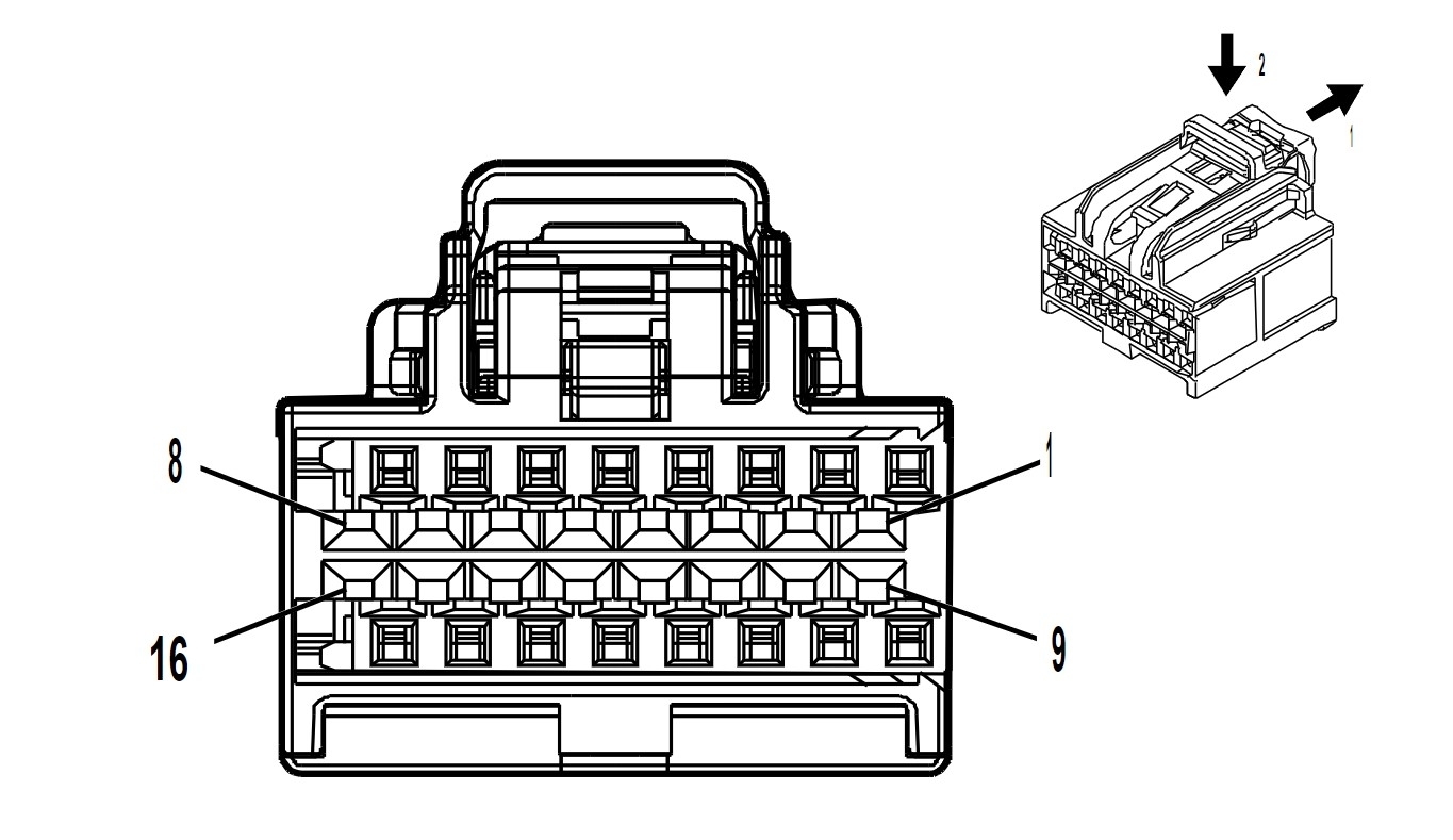

I need the roof console part #84608538 which has 2 16 pin connectors need to know pin location, wire color code, so I can solder new connector ends. Truck was damaged. A wiring diagram should work. thanks
Nov 26, 2021 at 10:01 AM
STEVE W.
  • 15,390 POSTS
Okay, try these there are what they have plus the pin outs for both connectors. Watch the colors. Those should help.
