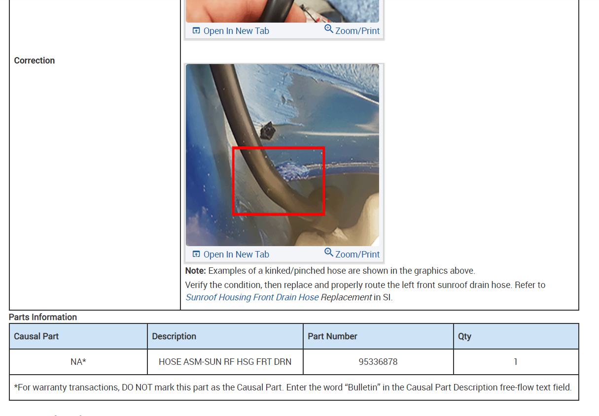

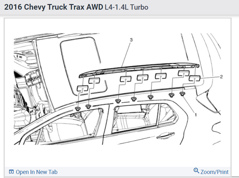

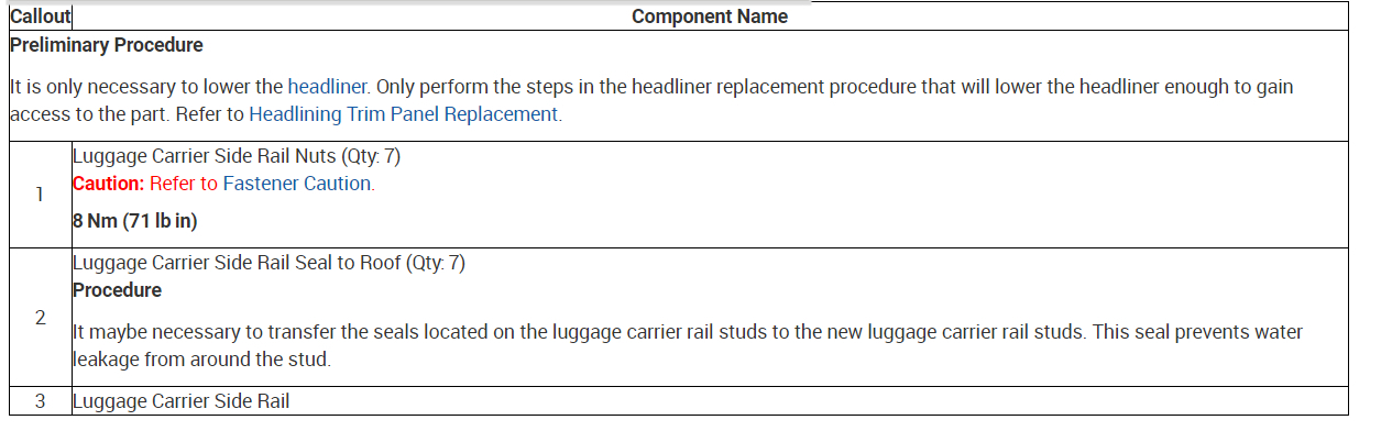

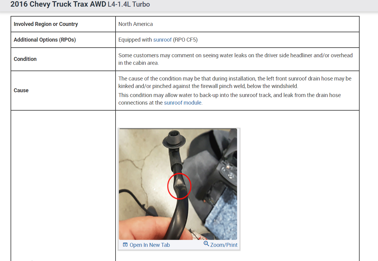

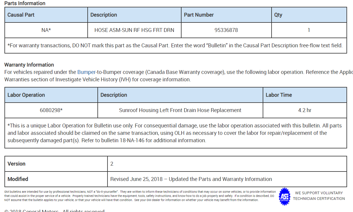

I am considering trying to replace the left side roof drip edge molding myself on our vehicle (no luggage rack). Before I order the part I am trying to figure out how the retainer clip that the molding attaches to is held in place? I am assuming some sort of adhesive.
Mar 31, 2018 at 1:09 AM
  • 55,065 POSTS
Hi Greg,
These are the daigams I could find for the roof molding I found this tech service bulletin I think it will help you fix the problem. Check out the diagrams (Below). Please let us know if you need anything else to get the problem fixed.
Apr 2, 2018 at 4:05 AM
