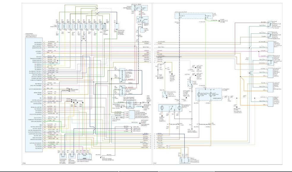

Trying to locate fuel shut off switch.
Jun 25, 2019 at 7:04 AM
Good afternoon,

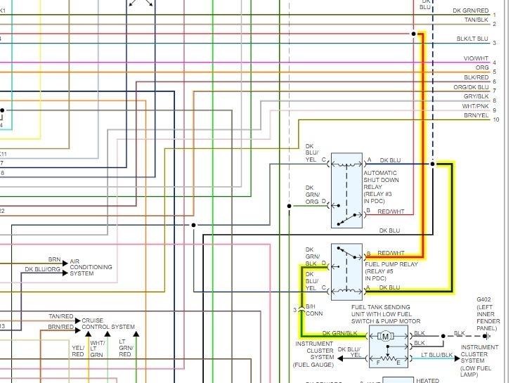

There is no fuel cutoff switch for the fuel pump. Fords have this switch.
I attached a wiring diagram for you to view.
What is the issue?
Jun 25, 2019 at 8:08 AM
DHERRING
It was in a rollover about a year ago. We are trying to make it usable as a farm truck.
It will run with gasoline poured in the carburetor but then shuts off.

Okay, can you hear the fuel pump run when you turn on the key?
https://www.2carpros.com/articles/how-to-replace-an-electric-fuel-pump
Did you remove all the old fuel and replace it with new fuel?
Jun 25, 2019 at 9:03 AM
DHERRING
Did not replace fuel. Added some new and shook it.
Cannot hear fuel pump when key is turned on. I’ll listen again under the car but I didn’t hear it while under the hood.
Jun 25, 2019 at 9:06 AM
You need to drain all the old fuel out. Adding new does nothing for the contaminated fuel.
I would replace the pump.
Jun 25, 2019 at 9:07 AM
DHERRING
Thanks.
I’ll start with good fuel and listen for the pump and go from there.
