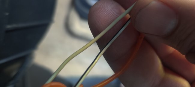

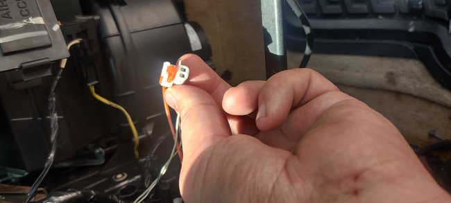

I'm reinstalling my dash after a replacement of the A/C evaporator and I cannot identify what or where this one wire belongs. Location is right side under dash. Wire colors are tan and white/black stripe. Any help is greatly appreciated since this is only thing stopping me from finishing!!

Can you follow the wire and tell me what the other ends connect to and we can find that component on a wiring diagram and then tell you what is on the other end.

It is taped with a 7 way gray connector that plugs in below and behind the blower motor. Wires snake up to the dash harness.

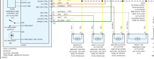

I found this for you on an air conditioning wiring diagram for you vehicle.If you look on location J and K on the HVAC control module it shows those colored wires.Hope this helps and thanks again for using 2CarPros.
