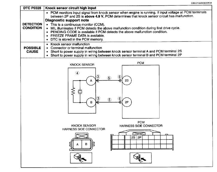

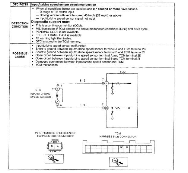

Thanks for responding back to me.Code for knock sensor was P0328 and code for transmission speed sensor was P0715.
Mechanic says both wiring to knock sensor and transmission speed sensor were all chewed up (sorry don't have a pic).

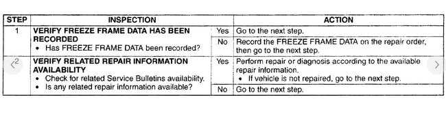

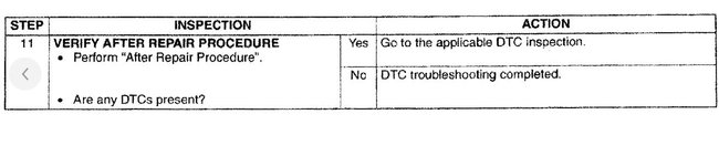

There is a fault code stored in the ABS and must be read before guessing about anything.

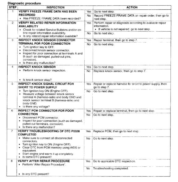

The 328 is for the knock sensor. The easy way of checking it is to have a scan tool hooked up with the engine idling. Monitor the timing on the scan tool. Take a small hammer and tap the top of the motor, if the sensor is working, you will see the timing change 4 degrees to the retarded side.

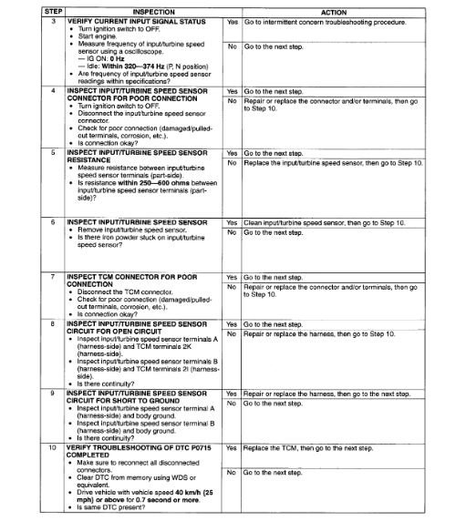

The 715 is for the input speed sensor.Did he verify the sensor was sending a signal the the ECM?
I hope he did not use butt connectors for the wiring repair. They are not solid connections.
I attached flow charts for you as well.

He needs to follow the flow chart for the knock sensor code to be sure there are not more wires involved.
