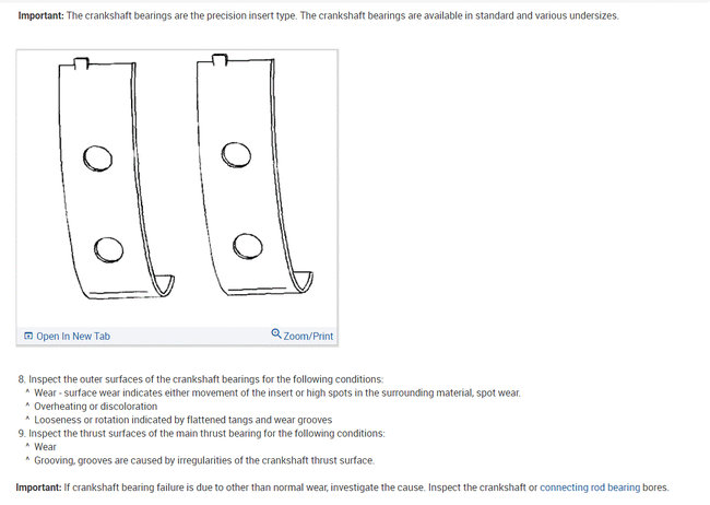

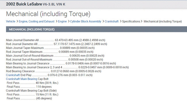

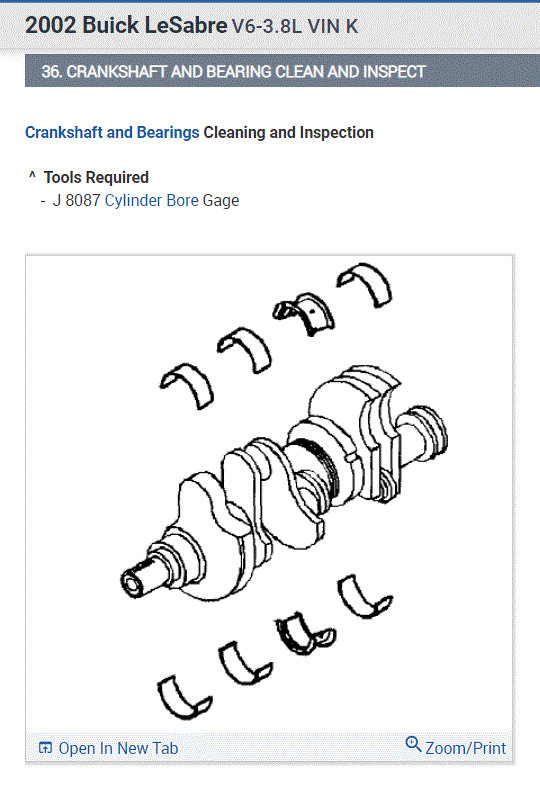

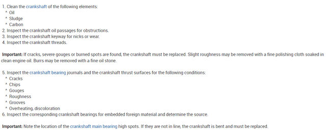

Here is what I can offer. First, I attached a pic below (pic 1) providing all the crankshaft specifications. Compare what you have to the specs.

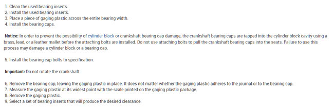

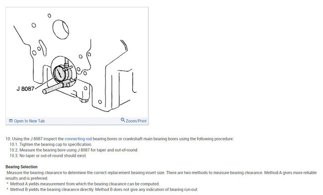

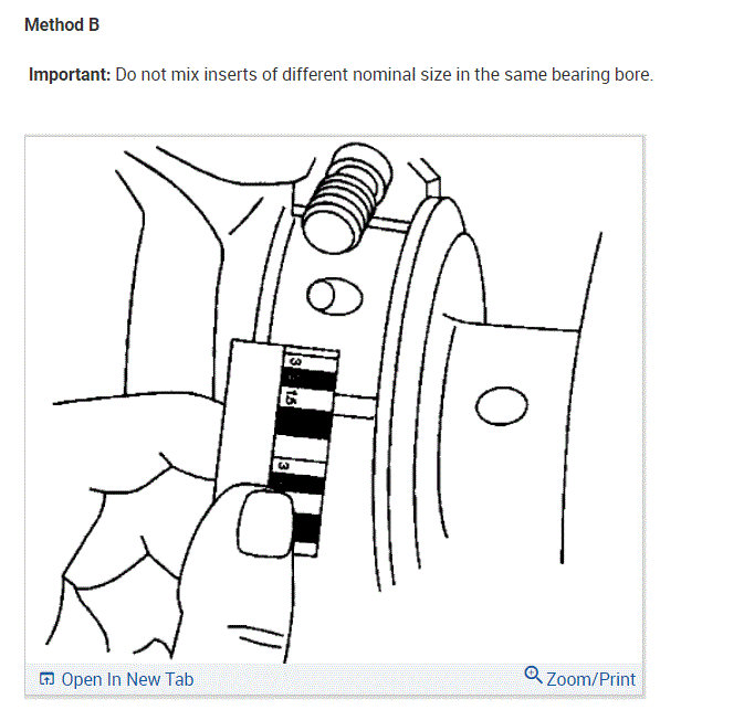

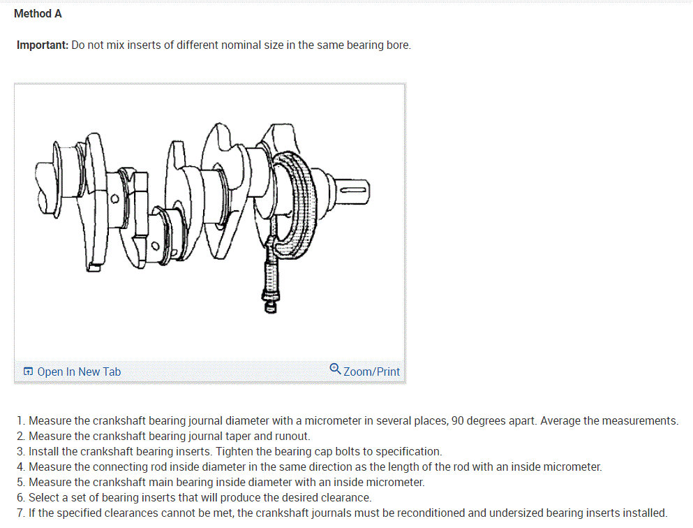

Second, I would check the crankshaft and bearing clearance. You will need a product called plastic gauge to perform this. However, it will let you know if there is too much clearance.
The remaining pics explain how to test. Also, if one of the bearings is oversized, that's fine (odd but fine) as long as the clearance is within spec.
I hope this helps. Please feel free to let me know if you have other questions.

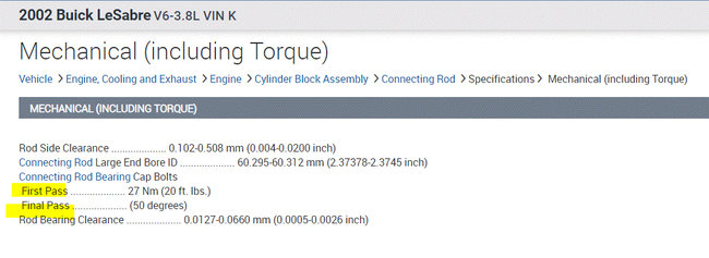

I see only main bearing cap bolt torques. Would you happen to have the rod cap bolt torque handy? Thanks

As far as the connecting rod torque, I attached that info below. Note that it is done in two steps. First, evenly torque them to 20 ft/lbs. The second step is to tighten the nut an additional 50 degrees.
