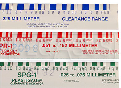

Since the other bearing failed, there is a good chance there is excessive wear on that journal. To determine if there is excessive clearance, you need to use a product called plastigauge.
Plastigauge looks like a string. You place it over the rod bearing and then install and torque the bearing to the manufacturer's specification. Next, you remove the end cap and you will see that the plastigauge has been crushed. Based on how crushed it is determines if there is proper clearance or if it is excessive indicating excessive wear on either the bearing or journal.
I attached a pic below showing the scales. If you have a chance, let me know what you find or if there is anything I can do to help.
See pic below.

I ended up taking the crankshaft to the machine shop and had it checked. Turns out it's shot, having an -80thousandths reading on #6 and normal -5 thousandths on the rest. Now I've ordered another crankshaft but am finding it impossible to find a rod to replace the #6 as suggested by my machine shop.
