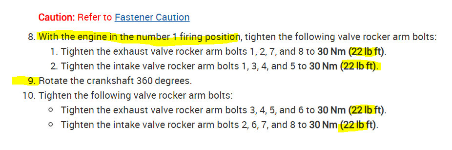

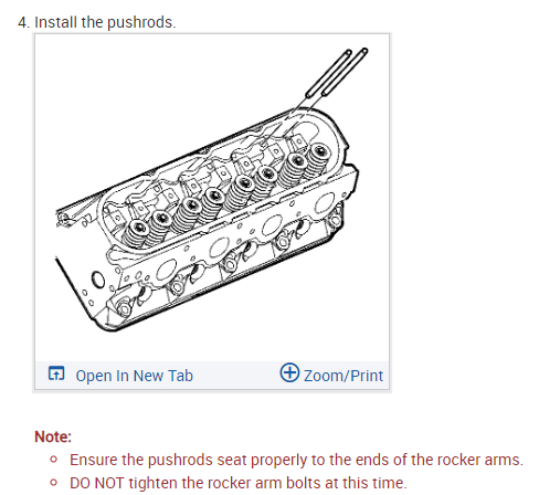

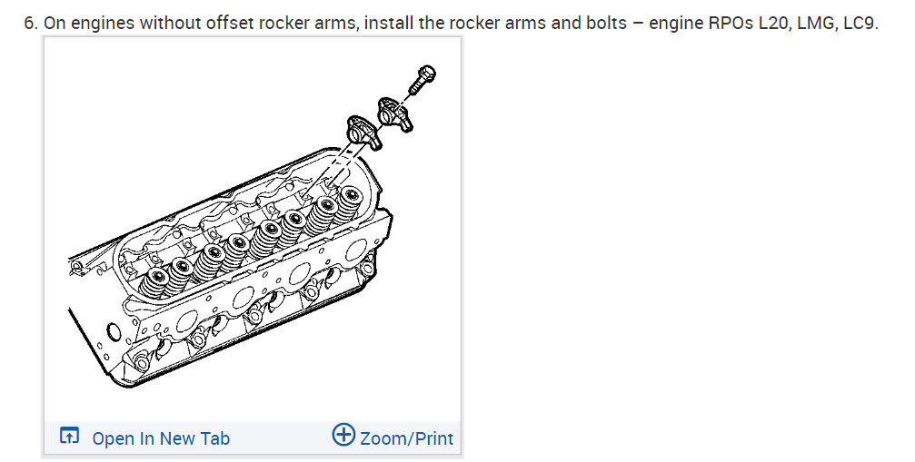

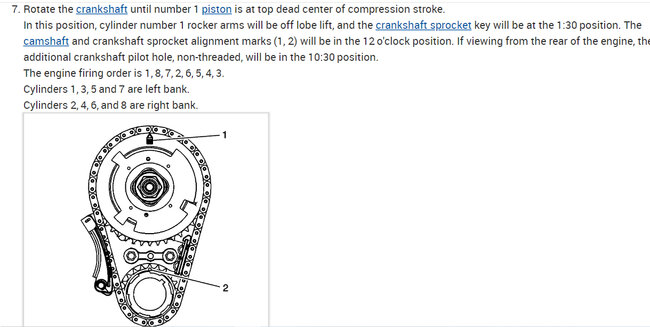

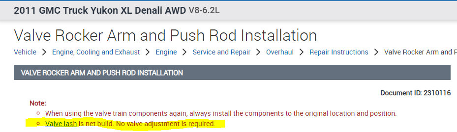

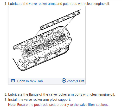

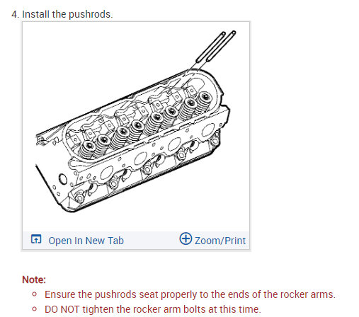

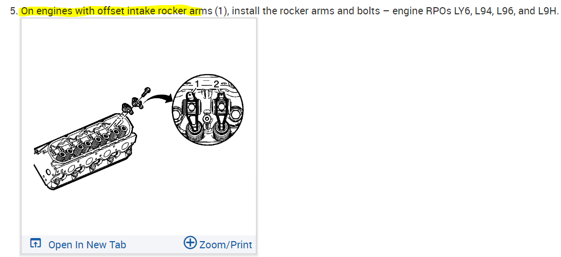

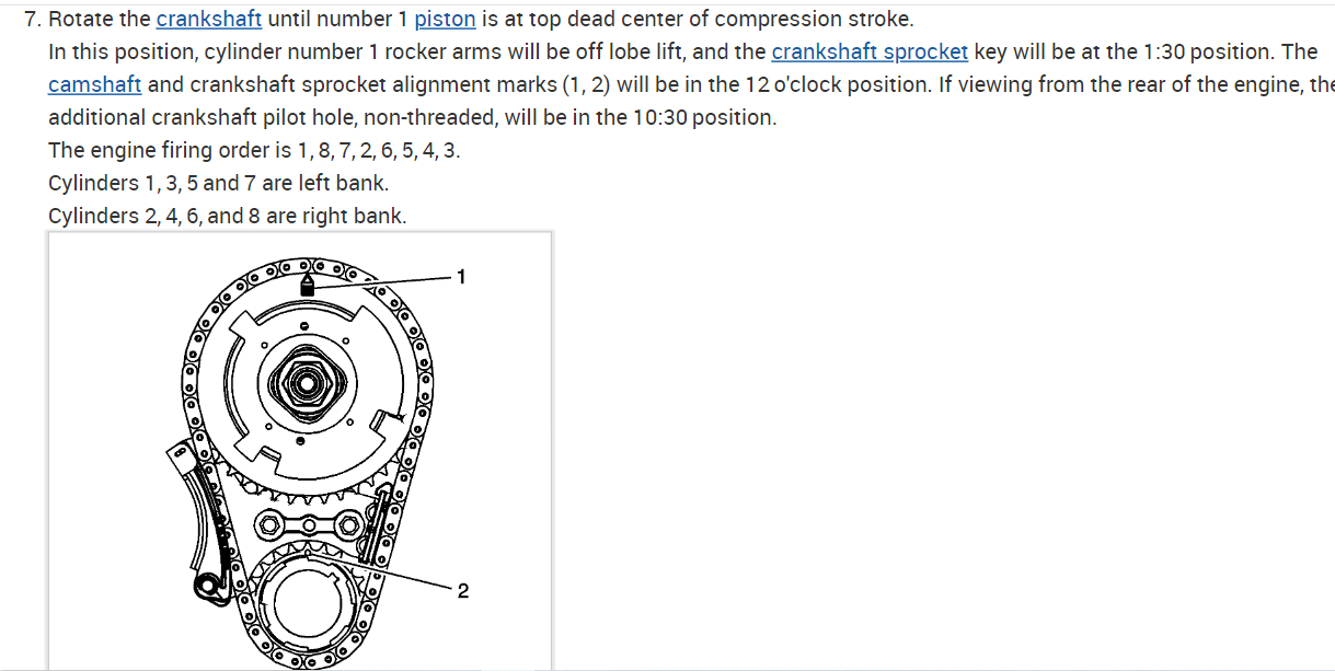

The only thing I have is for replacing the lifters and rocker arms. I attached that information below.
The torque specifications and sequence are last on the list. Take a look through the directions and let me know if they help or if you have questions. Also, note there are two different designs. Make sure the rockers are installed on the correct valve if the truck has intake rockers that are offset.
