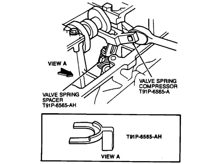

Yes, but the reason it cam off needs to be determined. It may have been the lifter but it may also be a broken valve spring as well.
I attached the procedure below with the required tools needed.
