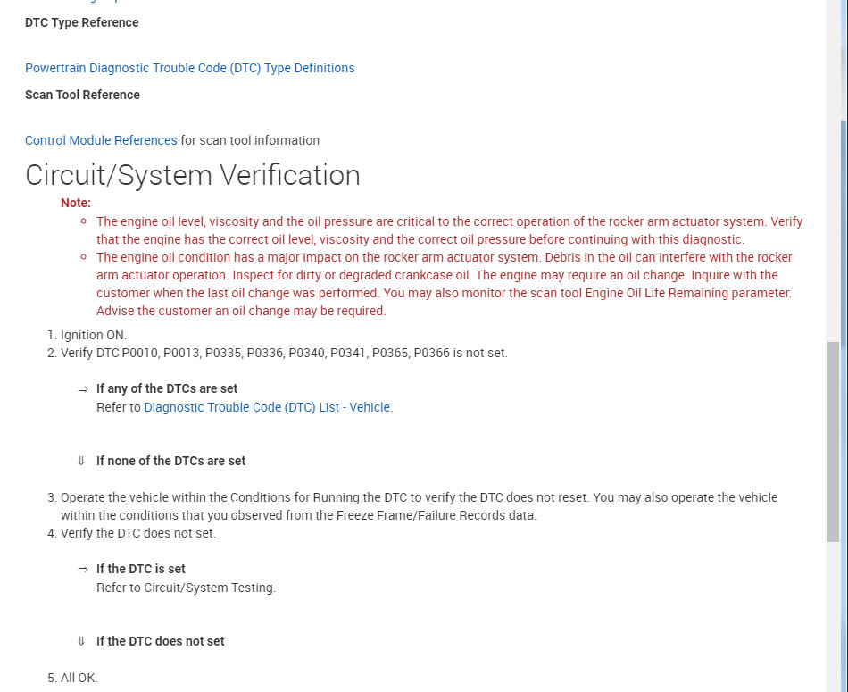

Re: Code P2646. What are the car symptoms if you have a damaged rocker? What should i look for? Thank you
Dec 16, 2019 at 7:45 PM
DANNY L
  • 5,648 POSTS

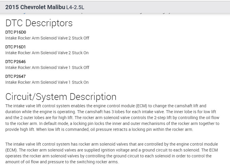

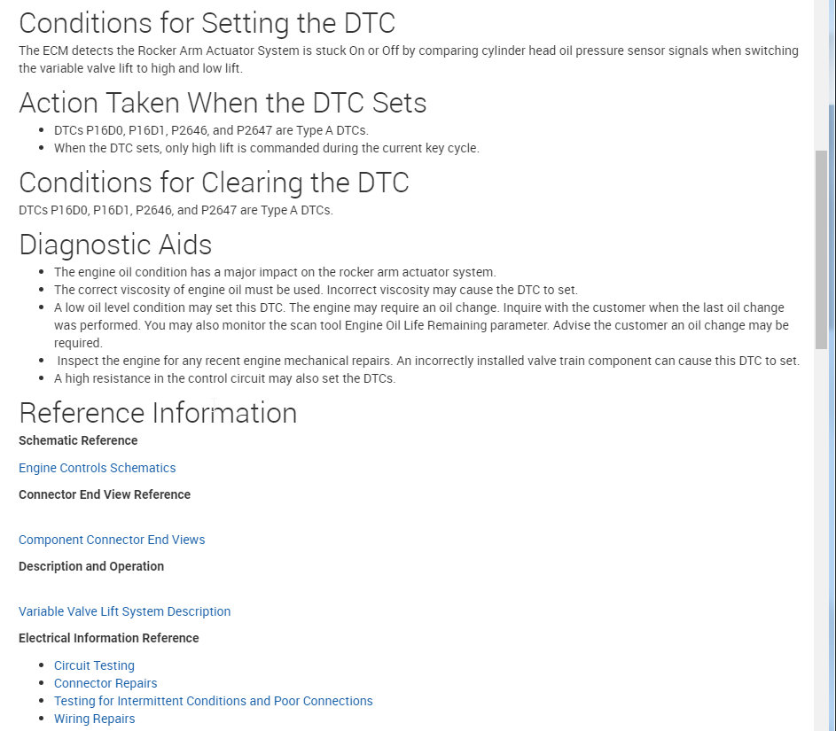

Hello, I'm Danny.

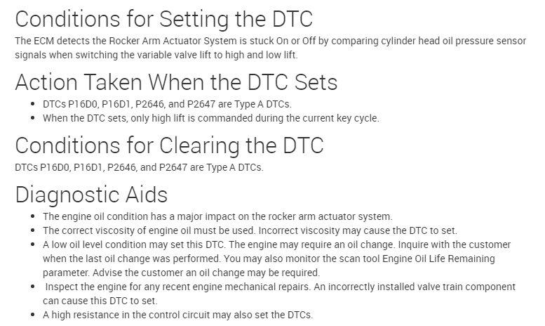

Normally with any type of valve train code as you stated you would hear loud noises coming from the valve train due to oil starvation. I've attached information below for that particular code. Hope this helps and thanks for using 2CarPros.

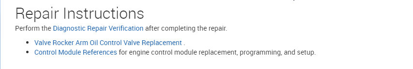

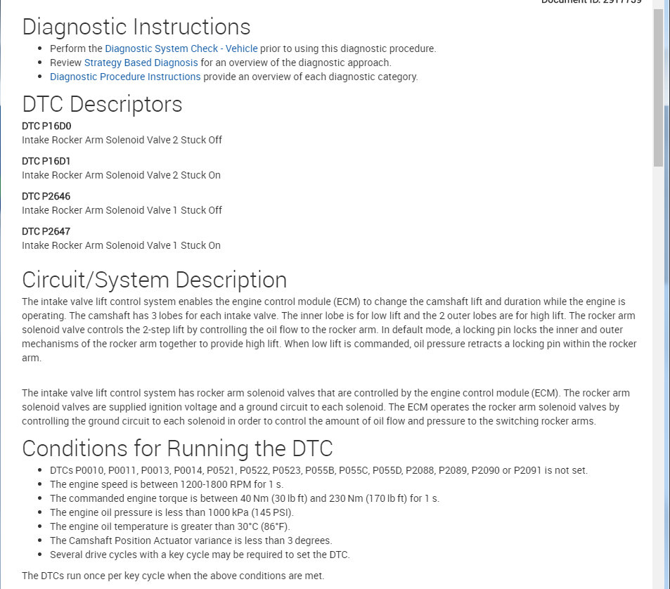

Hello again.

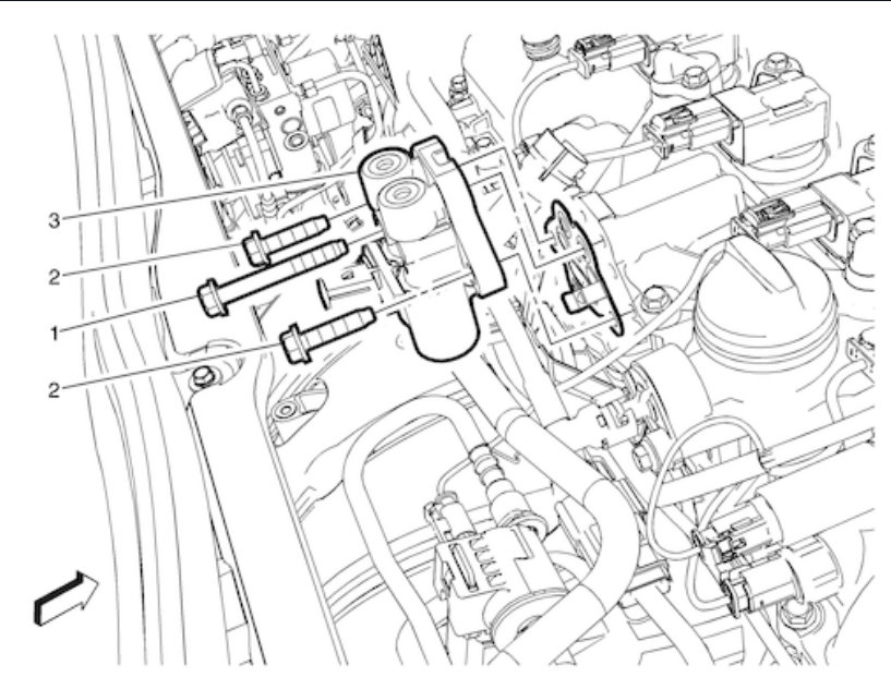

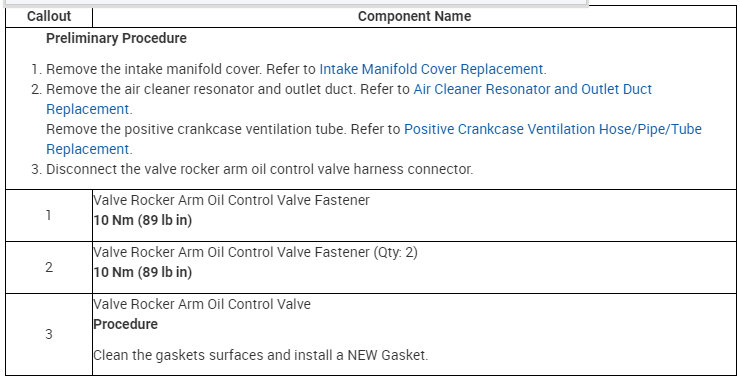

I've also attached below the instructions on how to change the intake rocker arm solenoid valve 1.Hope this helps and thanks again for using 2CarPros.

Good afternoon,

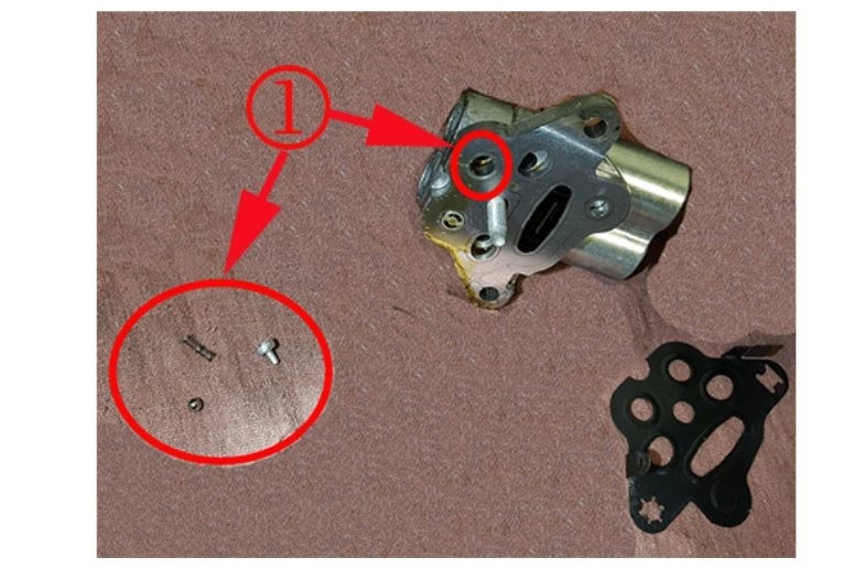

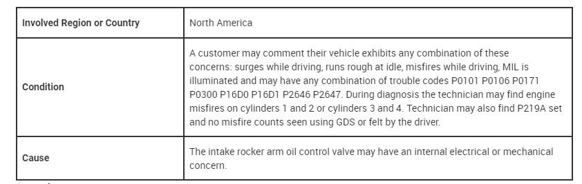

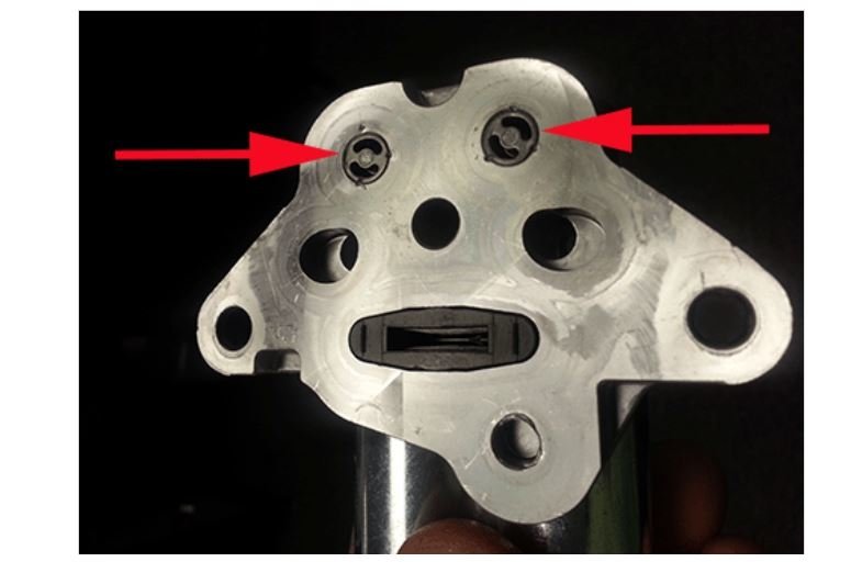

To add to Danny post, I have attached the correction for this code for you to view. There are issues with debris in the cover that causes this code. I attached pictures for you.
Correction
If diagnostic procedures in service information do not resolve the vehicle's concern, remove and inspect the intake rocker arm oil control valve for missing components.
See illustrations below for items #1 being missing.
If any of the components are missing, replace the intake rocker arm oil control valve and camshaft cover.
The camshaft cover must be replaced because the components become lodged in the camshaft cover oil passages and can not be removed.
If the intake rocker arm oil control valve is not missing any components, only replace the intake rocker arm oil control valve.
Note: If a previous rocker arm control solenoid came apart and pieces are stuck in the cam cover passages, this can cause any of the concerns to happen even when a new rocker arm control solenoid is installed.
Evaluate the vehicle thoroughly after repairs to verify the concern(s) are corrected.
This is a good valve with components still in place.

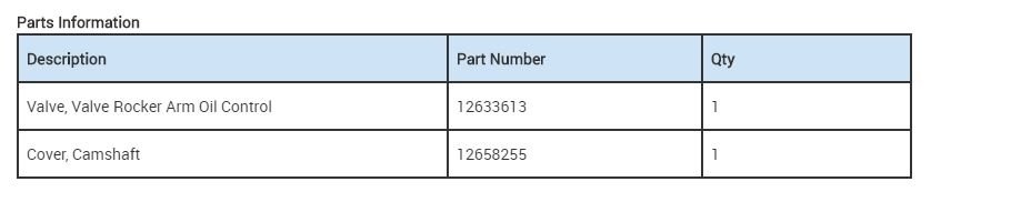

I'm looking for the GM part number for an Intake Rocker arm oil control valve and cam shaft cover. I don't see part number posted? Thank-you

I didnt get information with GM part number?
Jan 5, 2020 at 5:18 AM (Merged)
I just attached it again to this post for you.

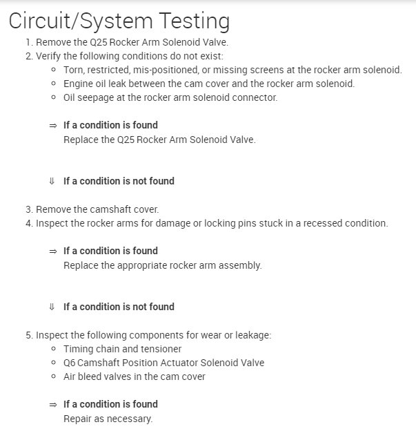

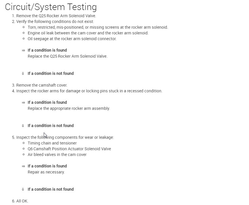

Just want to add an observation on this one. I had one not to long ago that the rocker was damaged so here is the testing to follow in case it does come back on. Pay particular attention to the Circuit/System Testing. Thanks

P2646 is a type A code. That means it takes one failure to set, it also means it will clear as soon as the system sees the fault is repaired. If you replaced the solenoid and it still shows the code you still have a problem. That code can be set by low oil or using the wrong oil as well as if sludge blocks the oil passage. Now that you have changed the solenoid I would probably do an oil and filter change and be sure to use the correct oil.
Beyond that you will want to remove the valve cover to verify that none of the rocker arms are stuck so the pins cannot extend as the code shows the system is locked in the off position.
