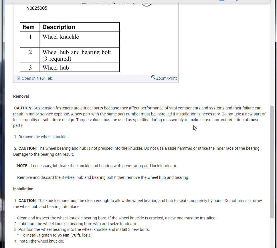

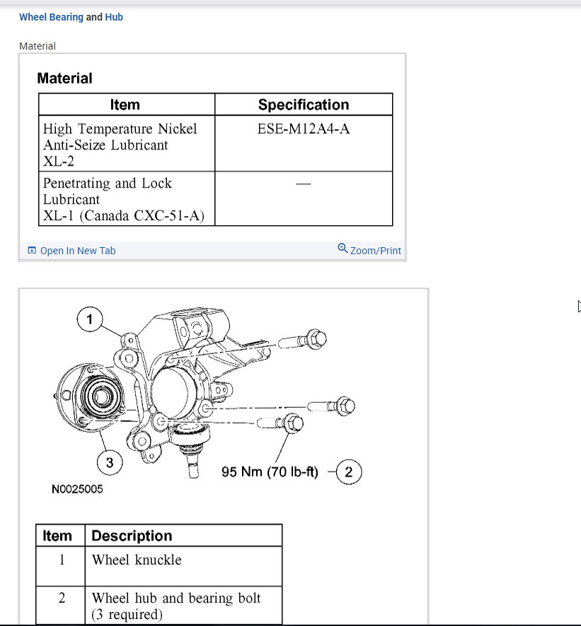

When turning left or right is there a direction that makes the noise quieter? If there is, then side that you are loading when it gets quieter is the issue. Below is the process from the manual on how to change out the bearings. Let us know what questions you have.
https://www.2carpros.com/articles/bearing-hub-replacement
https://www.2carpros.com/articles/how-to-replace-front-wheel-bearings-and-seals

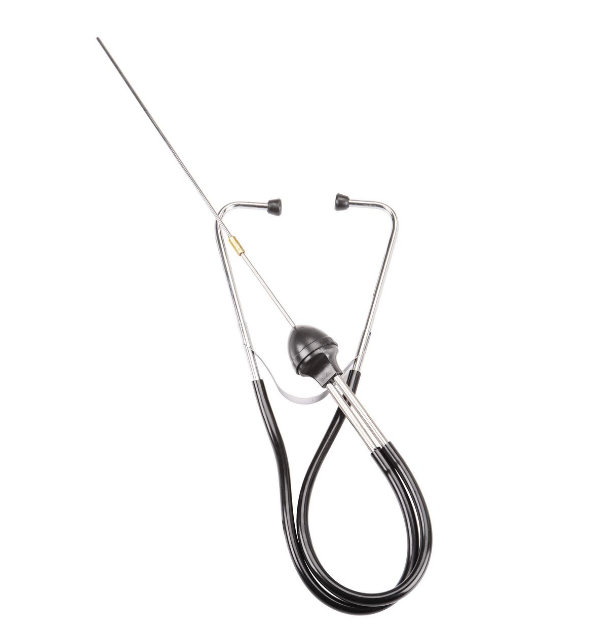

Can you lift the vehicle off the ground and either spin the front wheels or drive the vehicle on the jack stands? If it makes the noise then we can zero in on it with a stethoscope (picture attached below).
If it doesn't make the noise at all then that supports the bearing issue because you are taking the load off of them and they are not making noise any longer.
