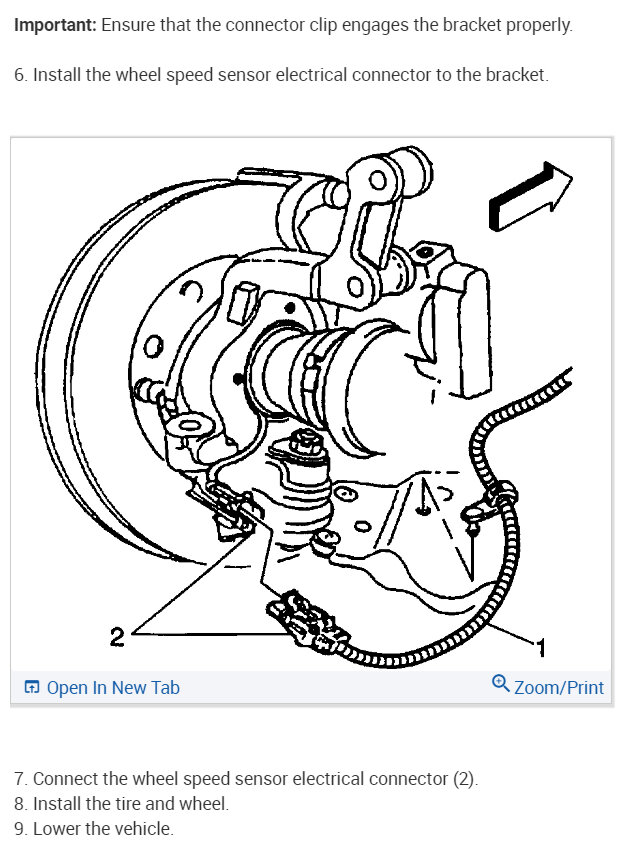

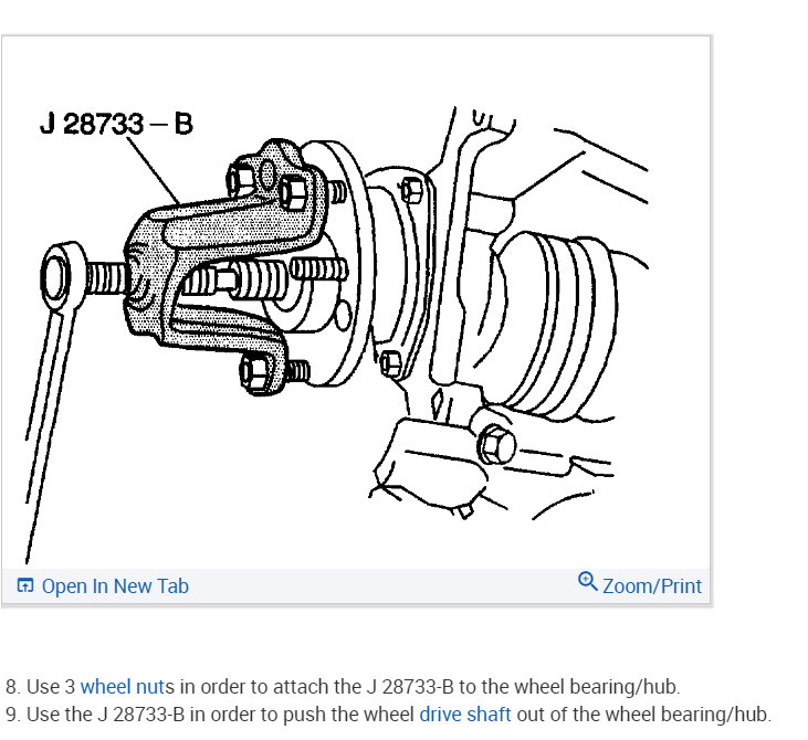

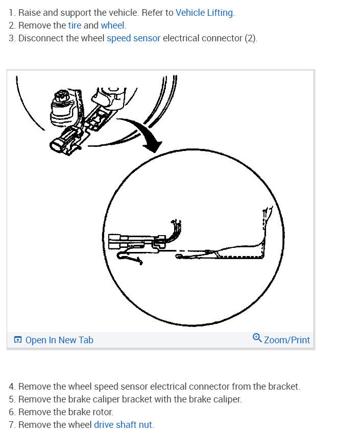

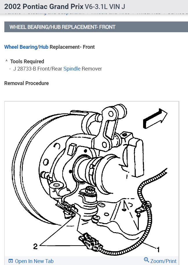

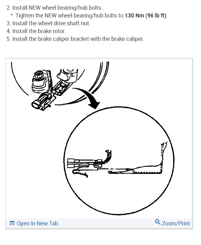

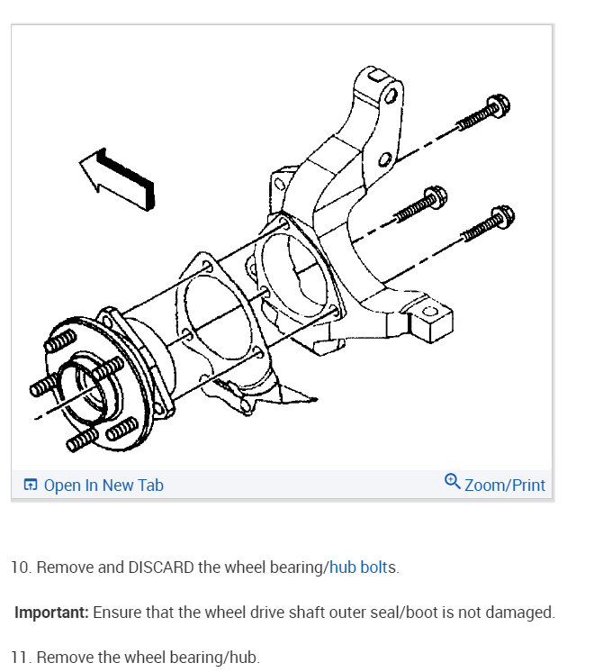

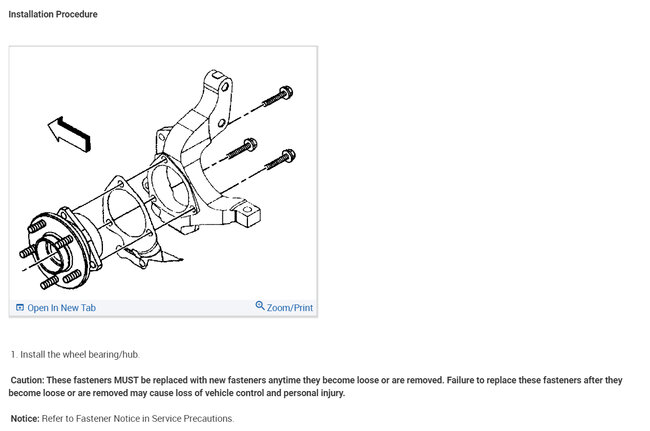

I've wrote you a few times on this same vehicle listed above, why would it sound like I'm riding on all-terrain mud tires on the front, it just started doing this about a week ago with the loud road noise, could it be the wheel bearings because I replaced them a couple years ago with a cheap set. Any help is appreciated!
Nov 2, 2023 at 3:00 AM
  • 55,119 POSTS
Yep, you nailed it, the wheel bearing hub will make this sound when they go out. Here is how to change them out correctly in case you need it. Check out the images (below). Please let us know if you need anything else to get the problem fixed.
Nov 2, 2023 at 4:10 AM
SETTERGRENH
  • 80 POSTS
Okay, thank you, I guess that's why my ABS and traction lights are on!
Nov 2, 2023 at 4:39 AM
  • 55,119 POSTS
Yep, that is why :) let me know how it goes.
